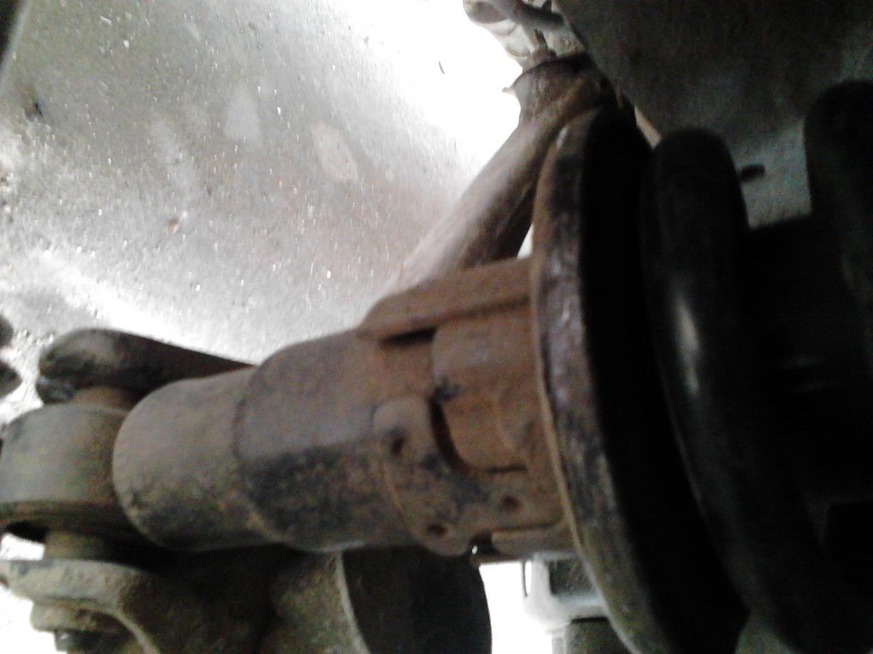

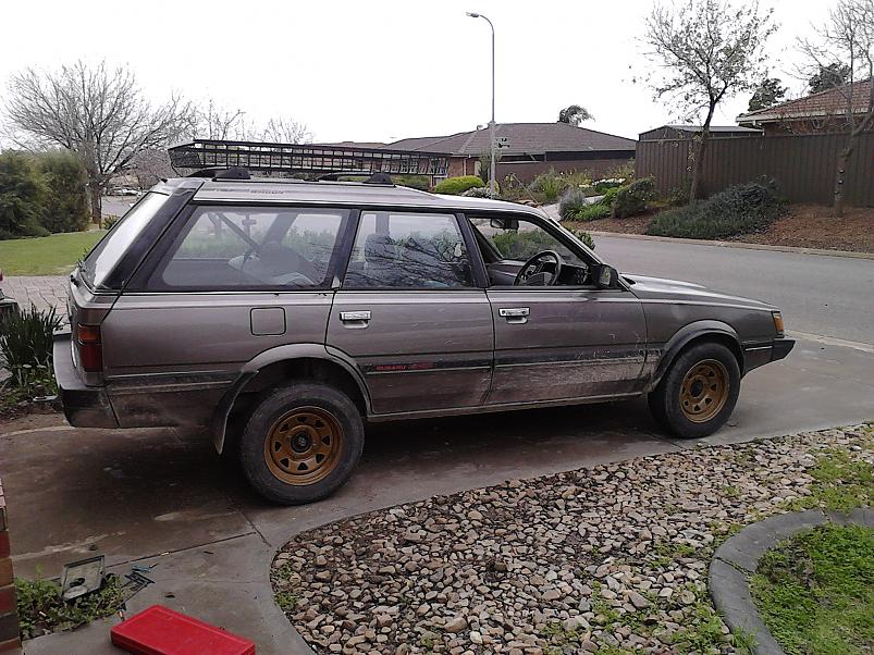

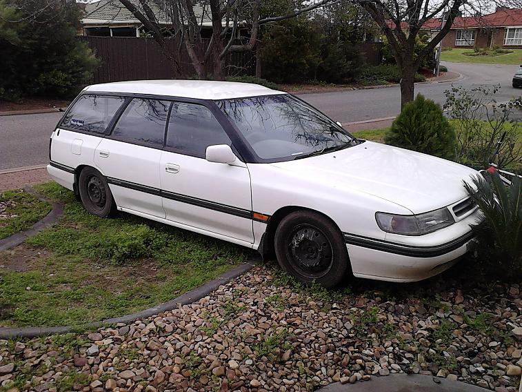

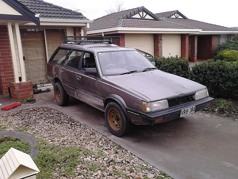

ok, springs are in. Bonus, adjustable collar shocks! While i was there, i picked up an air strut for the liberty to replace the one i know is stuffed
Liberty stuffed bags.jpg (120.32 KiB) Viewed 6480 times

Good stuff! Easy mod eh?
How do you find the ride with the springs a little stiffer?

easy mod bennie. Only hard part was compressing the honda springs. Could have been easier with a modified set of compressors. The ride is gret, i just need to lift the front a bit more now
