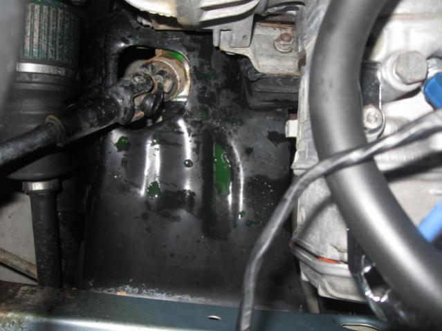

Update
Started her up today, topped up radiator with tap water ran up to temp. still spewing out coolant where I first located. Would start stalling again when warm enough.
*No real evidence of coolant in exhuast system.
*No external leaks other than above and a very small one from W/P bypass hose, due to corrosion.
*Removed the plugs to check for coolant contamination in cylinders/on plugs. All good. Plugs look like usual sooty selves even though changed them 3500 kms ago. What can I say!
*Cyl bores look consistent for an engine with some blow by (a little oily).
*Removed cyl head and radiator drain plugs and flushed cooling system at operating temp with high press hose. Not much there to worry about.

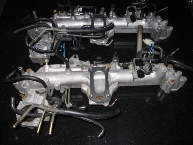

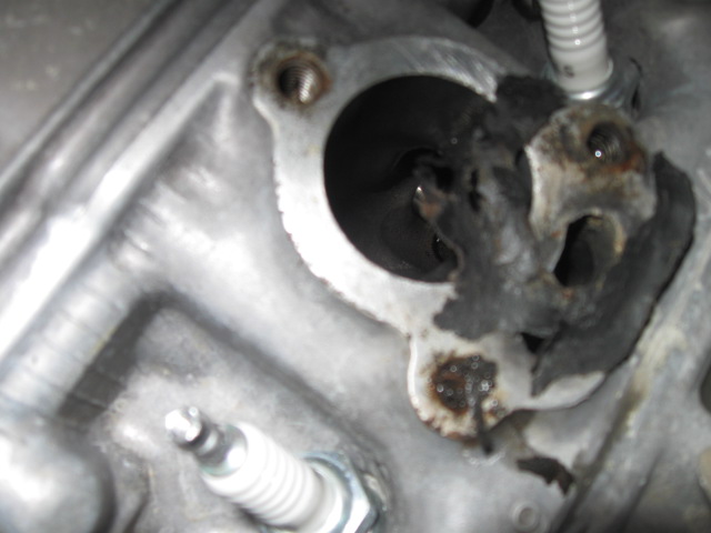

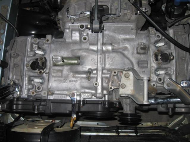

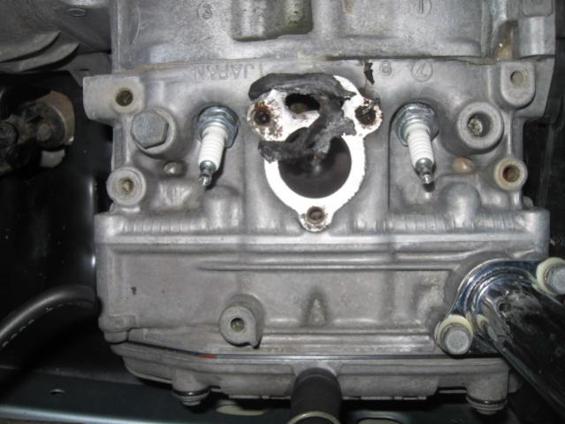

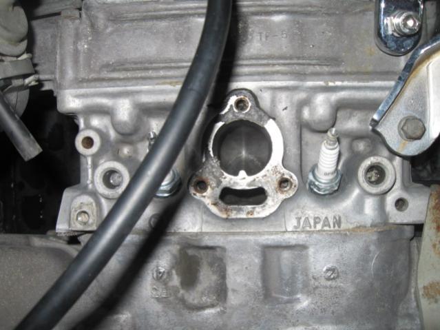

*Removed inlet man to reveal some very sorry looking gaskets. The most likely cause. see attached.
-Have some gaskets etc on the way from FROG.
Now to calm down and see how it goes in a weeks time.....

- EA82Block 002.jpg (39.69 KiB) Viewed 4523 times
- EA82BlockOverview.jpg (44.99 KiB) Viewed 4531 times
- #2#4inletport.jpg (44.18 KiB) Viewed 4523 times
- #1#3inletport2.jpg (74.34 KiB) Viewed 4533 times
- #1#3inletport.jpg (42.19 KiB) Viewed 4533 times

that has to be the cleanest EA82 i have ever seen!!!, replace gaskets reassemble and drive it!! it would have been running shit coz of the water getting into the bore!!!

Agreed!Captain Obvious wrote:that has to be the cleanest EA82 i have ever seen!!!
The other issue could have been that if the coolant was leaking into one of the spark plug wells the spark plug may have started missfiring due to the spark intensity going else where from the coolant earthing out the sparkplug before the spark gets to the end of the plug. Clear as mud?
Best of luck with the new gaskets!
Yeah that is plausible Bennie, I can visualise it but that was definately not happening. While waiting for the parts I have been a busy beaver cleaning things up. Such as the threads in the heads and those pesky manifold bolts thats like to corrode. Also chemically cleaned out the cooling passages in the heads and block. I will be testing a spare thermosensor and the temp gauge in dash for performance.

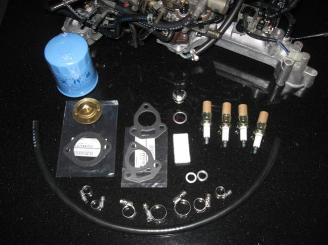

Well despite having to wait another 23hours for new manifold gaskets thanks to TNT's poor customer service:mad: I have finally got it all together. New hose good quality hose clamps to replace those small bypass and carb pre heat. New Thermostat and gasket, plugs. Cleaned everything thoroughly and checked what could be check without removing heads and all that entails while waiting for delivery. Still seems to give me that stalling/faultering problem occasionaly when upto temp. Only taken it round the block so far. No external leaks so far but still uses a little coolant.

- InletMan-clean&dirty.jpg (40.76 KiB) Viewed 4514 times
- InletMan-new gaskets.jpg (41.66 KiB) Viewed 4513 times
