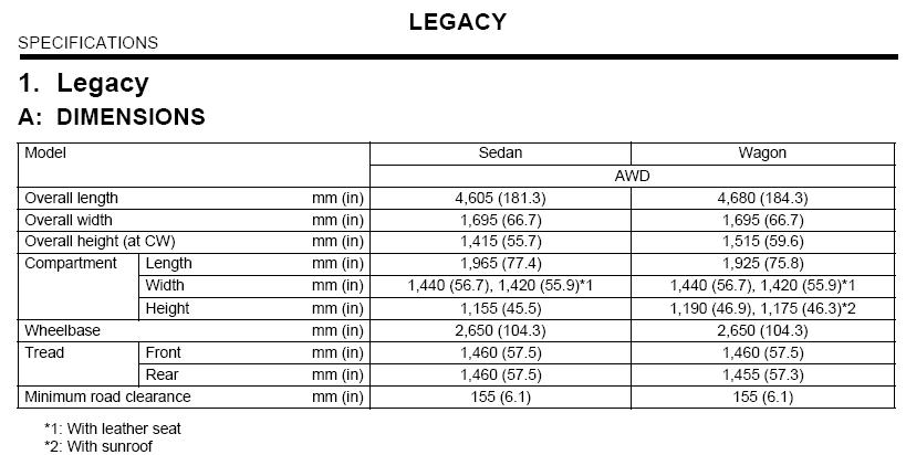

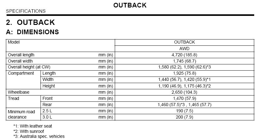

How much difference in wheel offset is between the Liberty and Outback?
Here are the tread specs for both from the 2003 Gen3 FSM
The Outback is 10mm wider at the front and 5mm wider in the rear than the Liberty wagon
Does the difference in track front and rear come from the angles of the suspension arms from the taller springs?
