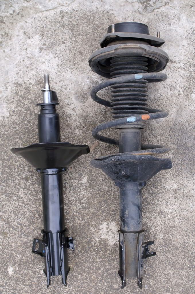

Here is a picture of the struts -AlpineRaven wrote:Correct above...
You dont HAVE to get raised springs, that is if you want extra lift then yes. Otherwise standard springs is okay.
Be aware, since you have Gen 1 Liberty, its likely to have mechanical speedo and your speedo will be out by approx 5-8kmh with these tyres. (if its electric you can get converter for it)
Left is outback strut, right is liberty strut. Both are Front.
Left - Liberty Strut, right Outback Strut. Both are Rears.

FYI -
The reason that Gen 3 rears will not work on Gen 1 & 2 because they have different setup - here is why - (picture of standard and outback struts)

gen 2 outback rears are also much beefier than gen 3's. I reckon it's close to an inch difference if overall diameter between the two.
