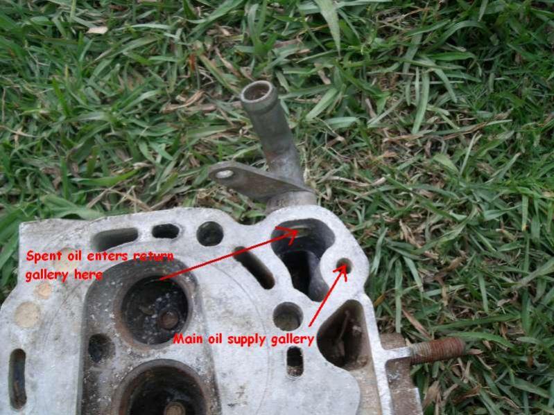

Does anyone have any pictures of where the oil fittings on ea82 mpfi heads are and water lines?
Need for possible drilling purpose's

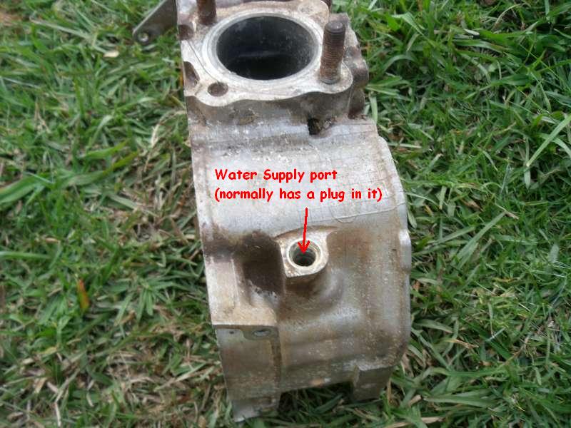

Post by steptoe » Thu Oct 22, 2009 2:31 am
I can help you visualise the water side of things. The head drain plug for water...it has a banjo fitting and hollow bolt to carry colant via a factory metal tube to or from the turbo under the head.

Post by H-top » Thu Oct 22, 2009 10:57 am
So where does the coolant pressure line come from? Cheers

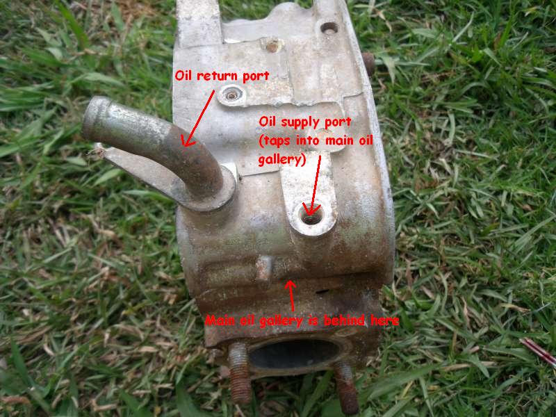

Post by Gannon » Thu Oct 22, 2009 4:35 pm
This will give you enough information to do the job
Please note you will have to find a piece of pipe to serve as an oil return pipe
H-top
Posts: 782
Post by H-top » Thu Oct 22, 2009 5:44 pm
thank you so much!!
that is exactly what i need!
so where does the other water line off the turbo go?
cheers
H-Top
rolling in
Post by Gannon » Thu Oct 22, 2009 6:23 pm
Into a pipe on the back of the thermostat.
Some people have Tee'd it into the cabin heater return hose

Post by discopotato03 » Thu Oct 22, 2009 6:46 pm
You really need that water return pipe to feed into the thermostats bowl area so that any steam bubbles go up through the open thermostat and on to the radiator - and preferably to the overflow reservoir .
