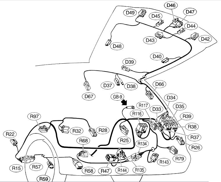

Post by TOONGA » Fri Oct 09, 2009 4:02 pm
this is the wiring for the rear of the 2007 forrester it should be similar to your car (yes I know you have the outback)
the wire in question comes off the locking latch
in this case D46
heres the legend for the picture
hope this helps
Post by Gannon » Fri Oct 09, 2009 5:41 pm
Here is a 2002 Liberty rear end
D46 is the 'rear gate latch switch'
So it is like a L series and integrated into the locking mechanism
