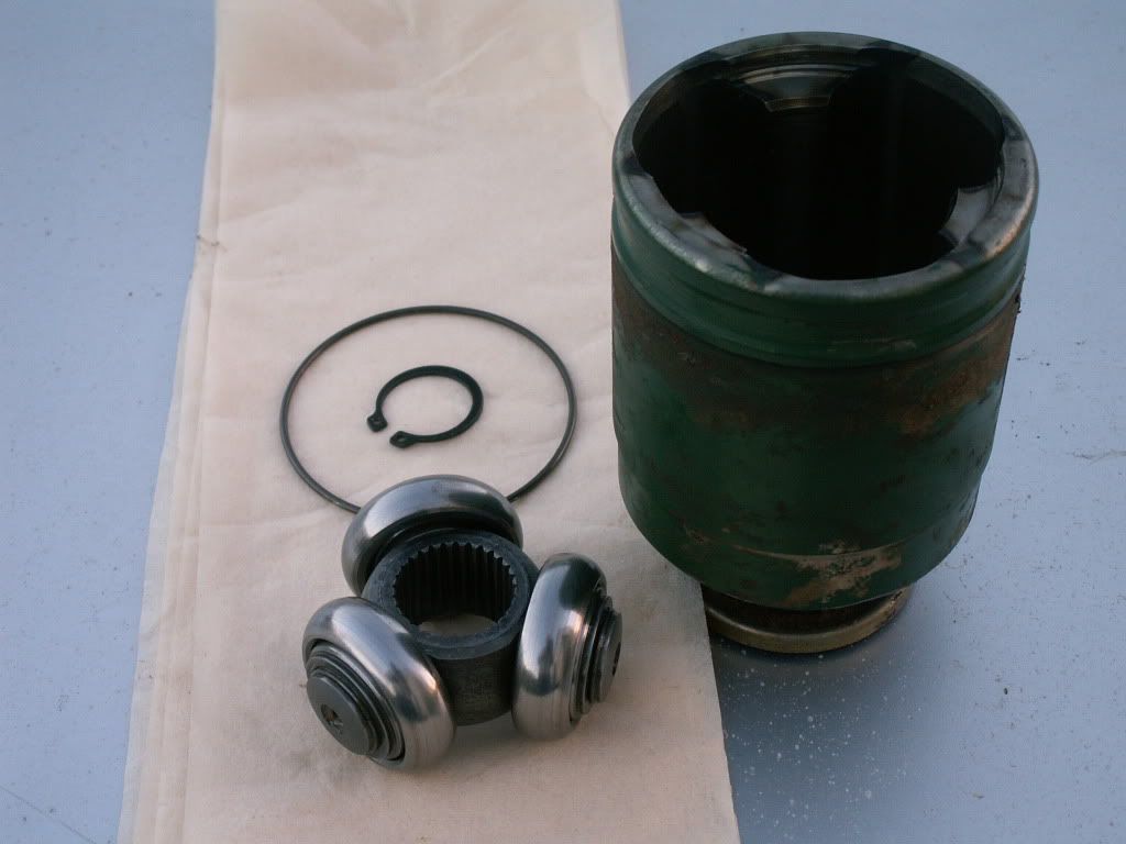

Bought a second hand shaft from an importer as a spare and changed the inner boot on it today.
Comes apart and goes back together the same as the earlier ones.
Less moving parts, so probably cheaper to produce?
Daza.

Post by AlpineRaven » Sun Jul 12, 2009 7:17 pm
That looks different to me... what car is it out from? The ones Ive touched had large balls in them..

Post by Captain Obvious » Sun Jul 12, 2009 7:25 pm
becs GEN 3 Rx has these and i bought one for the RX Turbo when i had it. seem ok to me.

Post by daza » Sun Jul 12, 2009 7:33 pm
Yeah, not sure when the change was, but these are the type of joints Subaru are using now.
This was the first time i'd seen inside one!
Daza.

Post by discopotato03 » Mon Jul 13, 2009 11:37 pm
Yes that is a tripod joint .
Given a choice I'd prefer a DOJ to those as they are much simpler and have more than 3 point contact to share the load .
Cheers A .

Post by Phizinza » Tue Jul 14, 2009 11:19 am
I had an EA81 shaft like this...
My brothers 81 Fiat X1/9 uses that type and I've seen it on a 88 Telstar as well.
Just a different way around it.

Post by brumbyrunner » Tue Jul 14, 2009 9:13 pm
If you care about wheel travel you will find that the tripod joint has less potential so is a step backwards.

Post by daza » Wed Jul 15, 2009 7:40 am
brumbyrunner wrote:If you care about wheel travel you will find that the tripod joint has less potential so is a step backwards.
Ah,
They tout them as longer lasting, but don't mention travel as there talking standard height.
Thanks for that tip Brumbyrunner.

Post by brumbyrunner » Wed Jul 15, 2009 1:00 pm
Better for what?
I've heard the tripod joints last forever. Ask an SVX owner.
Yep, the good ole' SVX was the pioneer. Tripod joints, 114.3mm PCD and 30mm uprights where the Macpherson strut bolts on.
All things the STI embraced 10 years later....
