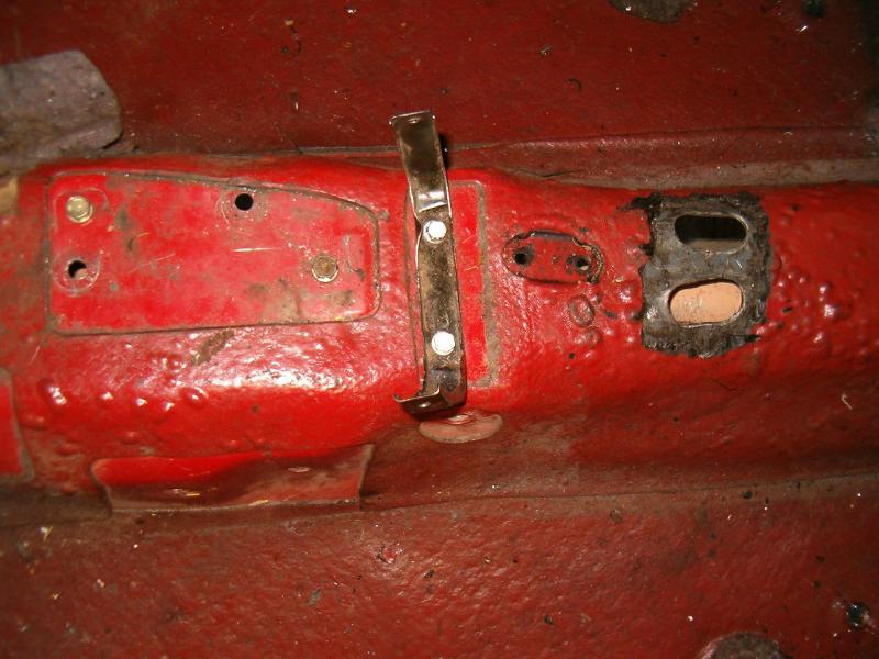

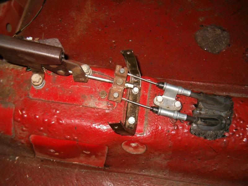

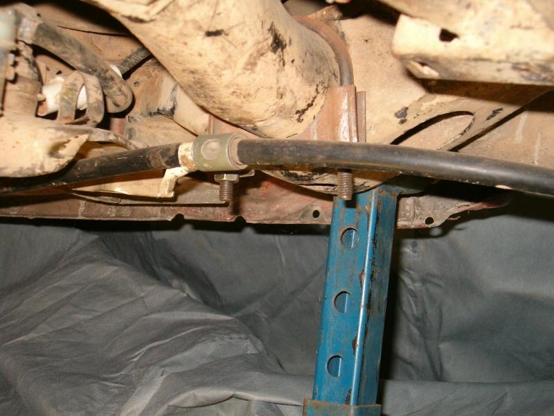

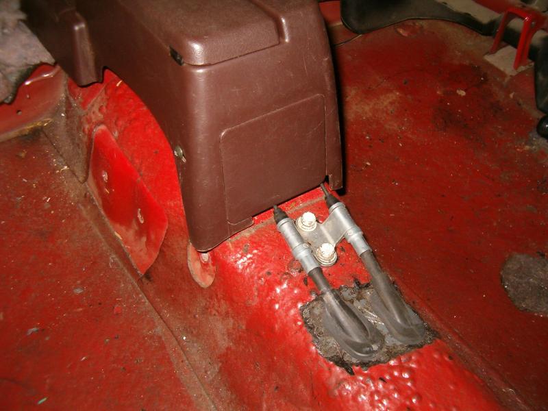

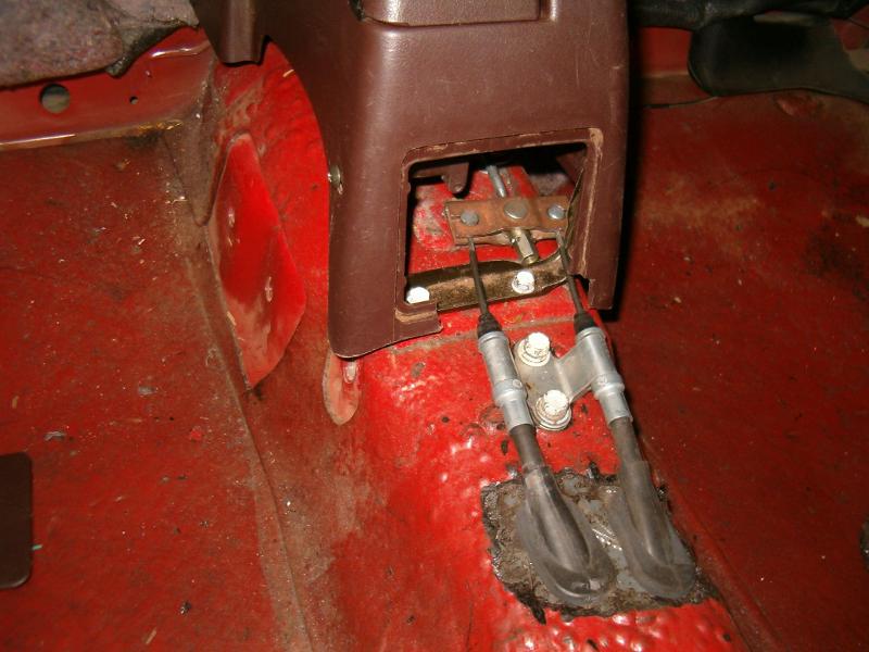

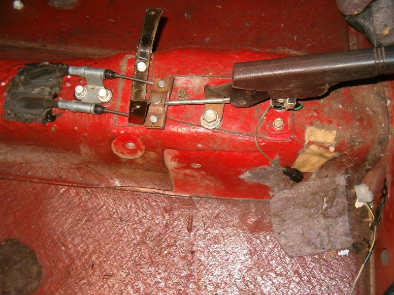

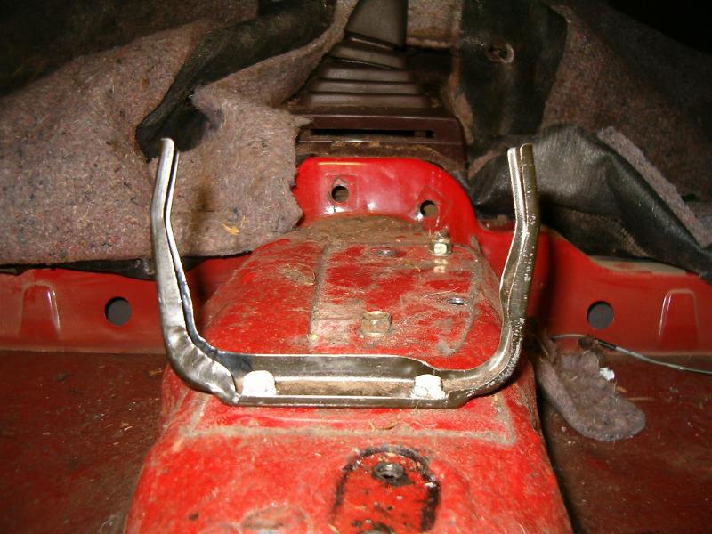

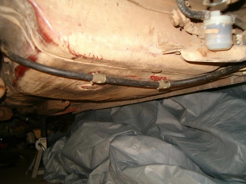

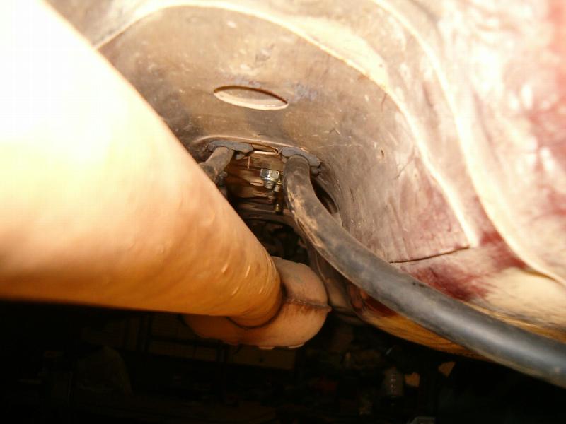

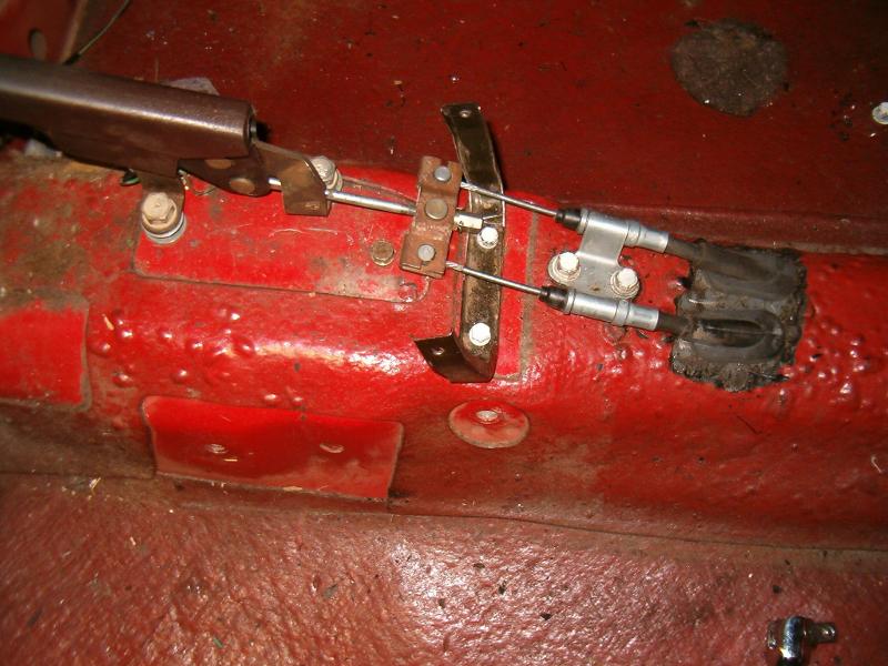

Hi all , does anyone have pics of this conversion taking place on an L Series ?
I'd like to see the Magna handbrake and linkage installed before the console was refitted , and the mods to the rear of the console itself .
Also pics of the non std fitment rear brake cables and hydraulic lines .

Post by stamp_licker » Sat Aug 30, 2008 1:12 pm
these ones?
HAND BRAKE CONV 4.jpg (40.21 KiB) Viewed 1393 times
HAND BRAKE CONV 3.jpg (54.06 KiB) Viewed 1397 times
HAND BRAKE CONV 2.jpg (74.36 KiB) Viewed 1392 times
HAND BRAKE CONV 1.jpg (65.15 KiB) Viewed 1397 times
HAND BRAKE CONV.jpg (76.44 KiB) Viewed 1409 times

and some more
HAND BRAKE CONV 9.jpg (93.15 KiB) Viewed 1393 times
HAND BRAKE CONV 8.jpg (66.89 KiB) Viewed 1390 times
HAND BRAKE CONV 7.jpg (67.52 KiB) Viewed 1388 times
HAND BRAKE CONV 6.jpg (60.48 KiB) Viewed 1385 times
HAND BRAKE CONV 5.jpg (61.14 KiB) Viewed 1390 times
Building a hardcore postie:D

Thank you very much kind sir , a pic tells 1000 words so easy when my fabricator does mine .
