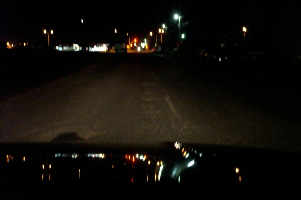

Picture of standard 50/55w Halogen lights -
• Low Beam
• High Beam

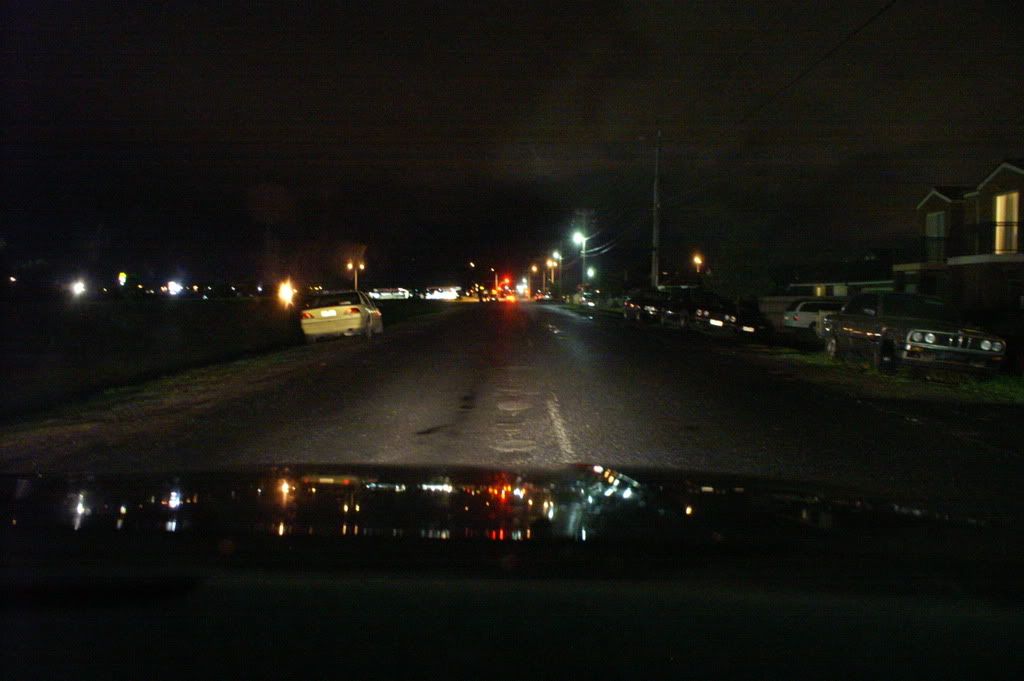

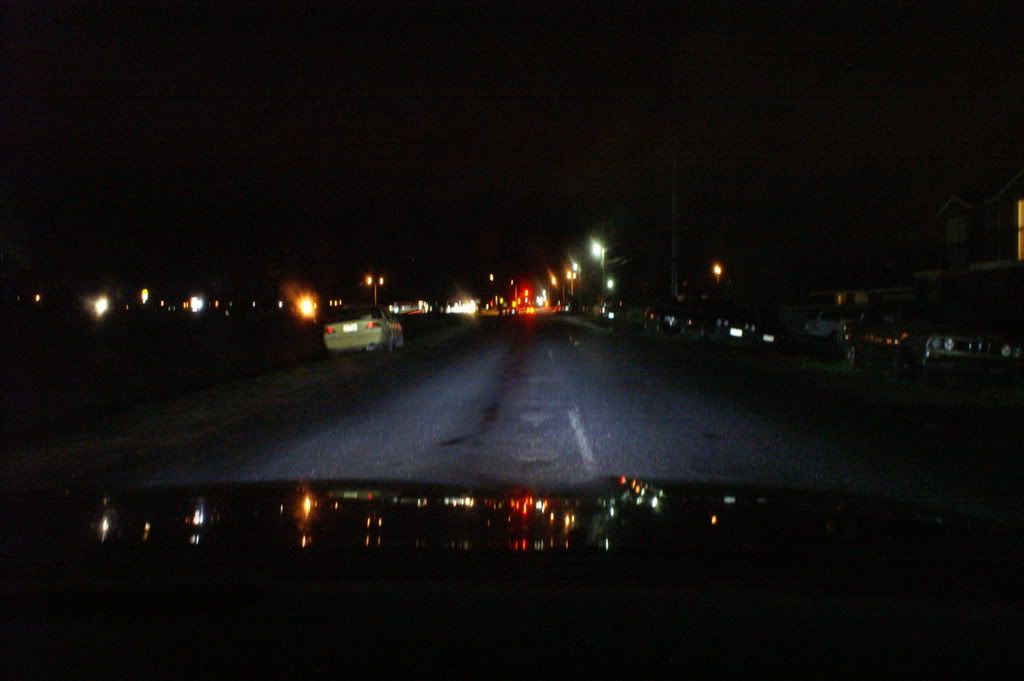

HIDs 35w (wet surface - just been raining -> will upload dry surface when I get the chance) -
•*Low Beam
• High Beam (Halogen built-in with HID)

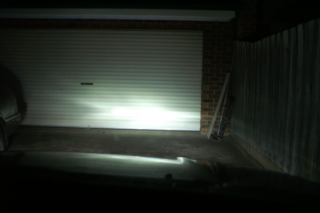

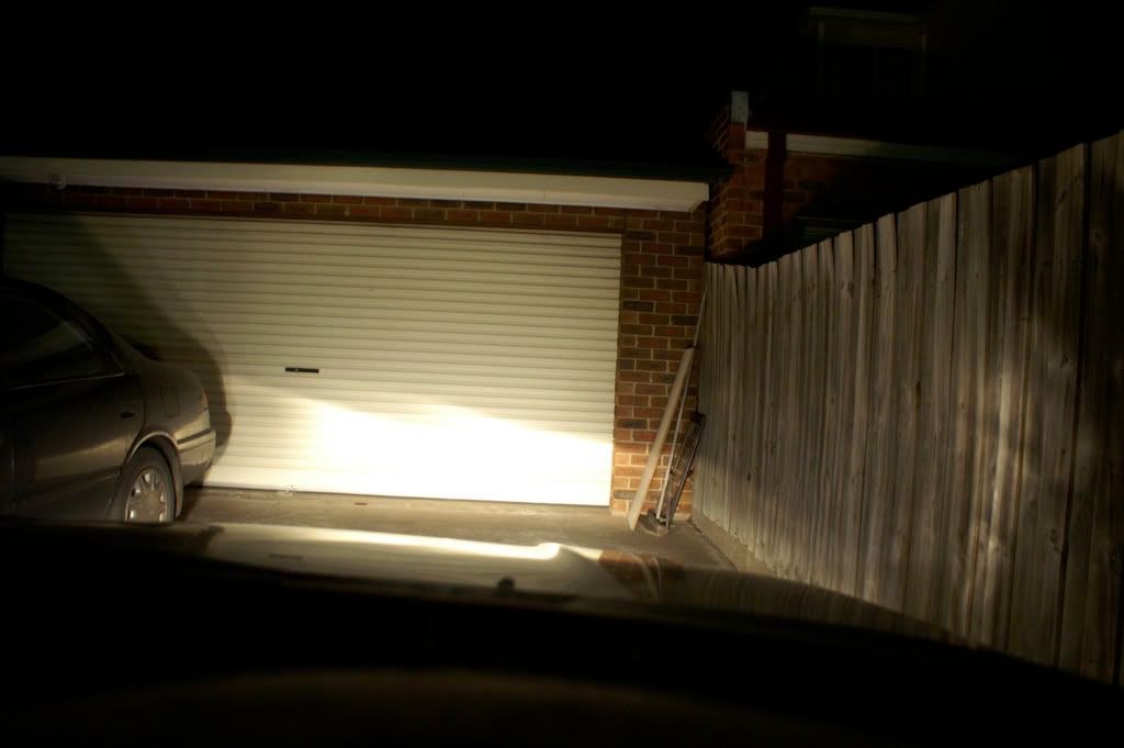

Light Pattern front of roller door
•*Halogen
•*HID

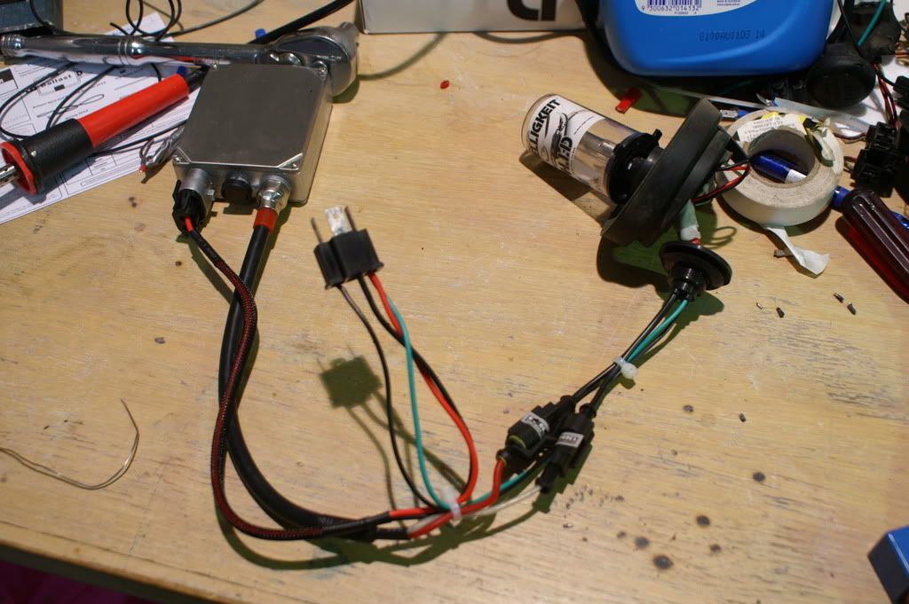

Wiring -
Had problems with factory wiring that came with it, so had to modify it to make it work on Subaru's "negative" power. The HIDs works on Camry & Commodore as they're "Positive" power. The problem was - when I first got it, I had to place pins in correct place, On low beam & high beam was on at the same time, if I flick on full beam the HIDs flickers with high beam then shuts down. So had to cut off black wires and move it to other pinouts (see the diff in photos) then full beam works. There is only one ballast for HIDs but not full beam.
•*Before modifications
•*After modifications.
(green wire is positive for full beam)
