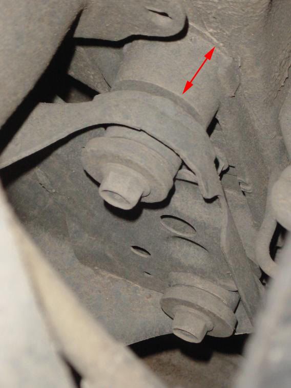

The problem is that you need a block to be installed under between the cross member to chassis rail. If you have standard outback struts then you need 1" block there, if its standard struts plus raised springs, I think raised springs is extra 35mm meaning another inch,recommended total is 2" block is required.... ( you will also need longer bolt and an longer extension for the steering linkage (whatever the length of the lift has to be added on the linkage) then you wont have any more problems, it will lower the engine down a bit.)
Shown in this photo see the red arrow - thats 1" block on standard outback -
Does it have a block there?

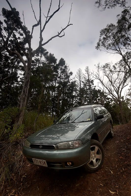

Is that first shot taken at one of the Booloumba Creek Crossings?
