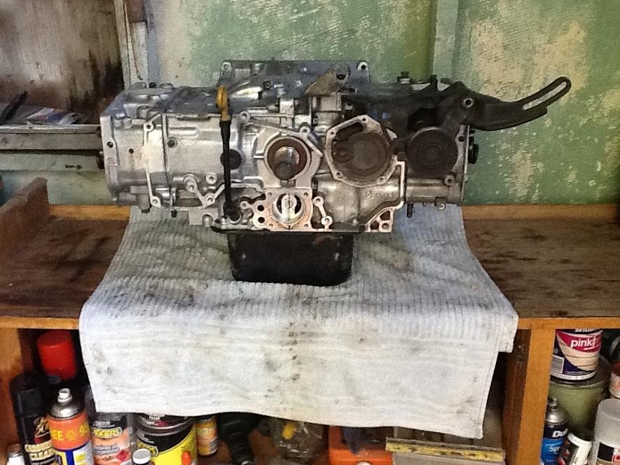

Made some more progress today.
I installed the valve springs and retainers on the right head and installed that with a new gasket.
Feel like I'm finally starting to get there:
In the end I decided not to remove the other head and clean it further. I'm confident the valves are lapped well so they will just have to cope with any bits of gunk left over.
Next I will order some new valve lifters and continue on.
