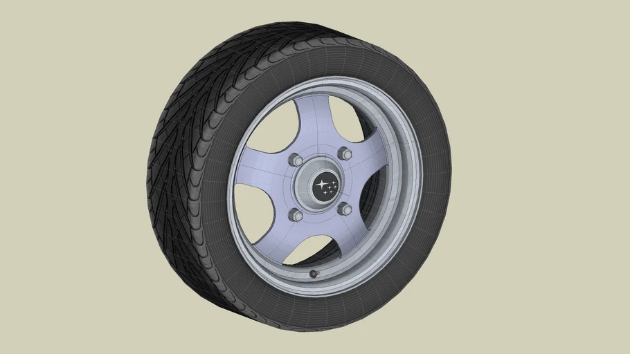

I been trying to draw this up in SketchUp, but the drawing you gave me doesn't seem to add up ... ;)
So I want to confirm that 14" ( 355.6 mm ) is the diameter of 'seat' for tyre, width of spoke is 63.7 mm and that center hole is 93.1 mm ... ?
Add : Ok - I think I have worked out what's going on - the copy has made the join @ spoke edge with a continuous ring - where as the original is just welded strait on it ... :/
The ring would make it stronger - but changes the look a bit ( which was throwing me until I figured it out ) Do you still want this ring ?
Cheers, Bantum ...

The ring is in the centre so it can be fully welded not just in 5 spots to increase load capacity. I don`t think it changes it all that much but i think it will handle conditions alot better. It will be harder to bend one and less chance of structural deformaty but am pushing hard for the best warranty that`s why we are trying to make the strongest wheel we can in an affordable price range. You get what you pay for. The centre hole is 93.1mm +/-.1/.2mm to allow for powdercoat. And all other measurements have been taken from 3 different scorpion rims so they will be as close as possible.

Post by Bantum » Sat Mar 01, 2014 8:03 pm
OK - here it is ... ( Note : I have also posted it on 3d Warehouse - but they have been playing 'update' games so may not work there yet )
Add : Link here : 'Scorpion' Wheel
I've done it as per original ( welded directly ) will also try it the other way with a ring - still think it doesn't look as good that way ... :(
P.S. - Are we calling it a 'Scorpion' copy rim ?
Cheers, Bantum ...

They certainly look good in cad form but would like to see the dreaded 'ring' view as well before final judgement/commitment.

Post by Bantum » Mon Mar 10, 2014 12:10 am
Ok - I've finally manage to get the damn thing to upload a file to 3D Warehouse - so you can now download & play with it ... :) .... ( See link in previous post above )
Do note that I wouldn't rely on it being accurate for production purposes, but it should be good enough to get an idea of what it looks like ... ;)
