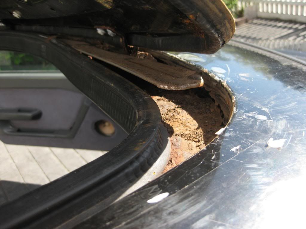

Thanks for that FujiFan, i'm pretty sure its not repairable cos its a structural problem, and if i had the cash i dont think it could be fixed anyway. One of my m8s said i should turn it into a convertable but dont think thats gonna happen soon lol.
I'm kinda happy that i found out this problem now than later on cos I would of spent a lot more money onto it, but what can you do :)

before you decide to strip the car please post some pics of the roof so we can see if we can give you more options to your dilema.

Here is the pics i took yesterday, I'll take some more when i can but i dont like looking at it cos its just too painfull for me too look at lol so hopefully this week or weekend i'll take off the roof lining and get a better shot.
If this can be fixed that would be the best thing since sliced bread, I've had my eye on this car for over 6 years now and still haven't driven it on the roads.
Thanks again everyone for this, just hope this can be fixed :)

The roof is a two piece unit and as long as the roof edge is reasonable then you will only have to remove the inner frame which is only glued into place. once its out you can rebuild the unit or replace it. Its not that bad.
See what the inside of the roof is like.

Anyone think a bigger sunroof fitted may fix his problems enough to be able to at least drive it for a few years?

Or cut out roof section and replace with a good unit/solid roof section... The real thing to check out is if the pillars have rust through them as well to make sure it's not a structural issue.

Thanks again for the feed back guys, im gonna try and get some time this weekend to get some more pics under neighth it, i showed this pic to a subaru specialist the other day and he told me its been fixed before and to fix it, it will cost more than it's really worth, so i might have to save up or really think about getting it towed back to my uncles place for awhile. (I really don't want to get rid of this car)

Hey everyone, its been awhile since i.ve updated this posts, but i do have some good news for once lol, as i have rust in the sun roof i was going to srap the car and sell it for parts, but luckly my uncle did have a good look at it and said it was't that bad and easy to fix, so luckly i'll be working on it again.
