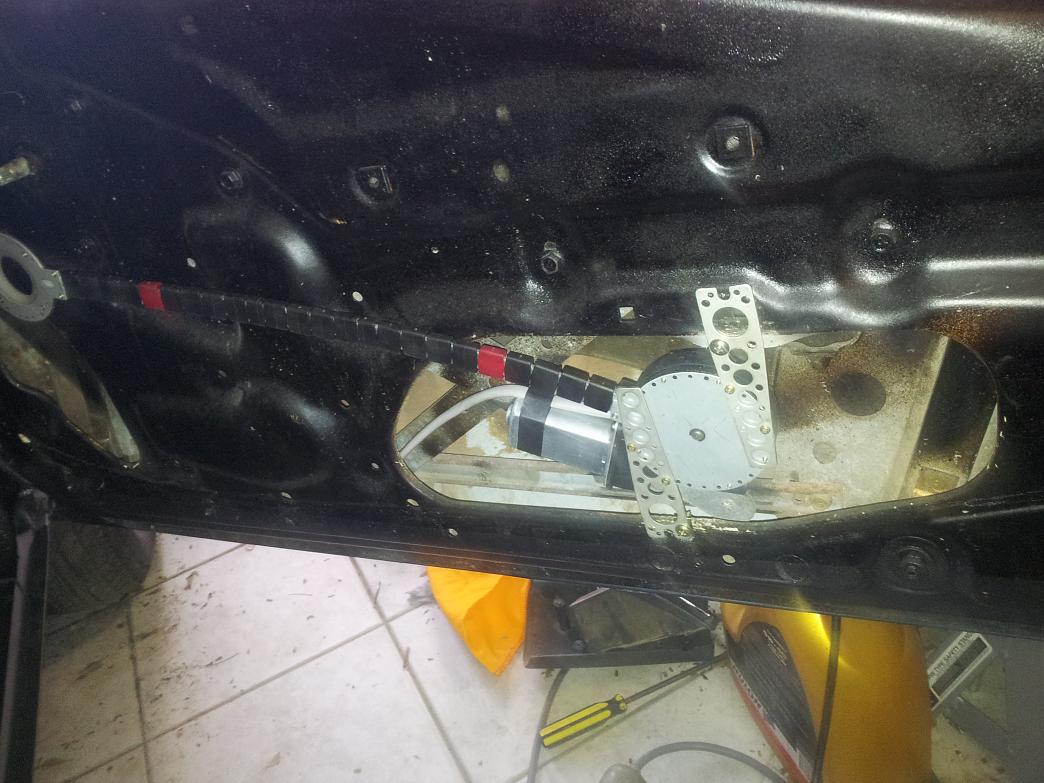

Post by Backyard_Brumby » Fri Dec 09, 2011 2:25 pm
The power window kit in place, now just finishing off hooking up all the wiring between dash and loom and then exhaust and start the engine for the first time :)
