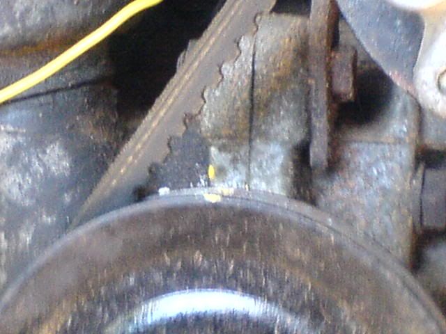

I have a crappy mobile phone pic of the timing marks:

Im looking at the photo and Im trying to work out whre the timing marks are I can see the one on the pulley, is the yellow one on the engine the mark you are timing to ? or are there really fine lines that are blurred by the camera in the phone?RatCamper wrote:
From what I remember that lump of aluminium on the fan pully can be unbolted so the pulley is just a pulley.
The pulley mark is TDC when it is aligned with the case split. The case mark is 8deg BTDC. Pretty much an idiot proof timing setup. Perfect for me. If there were some nice solid mounting points it wouldn't be too hard to hack up a scrap of aluminium sheet or something to make a proper scale. Figuring out where to put the marks is easy. Mounting it is a little harder.

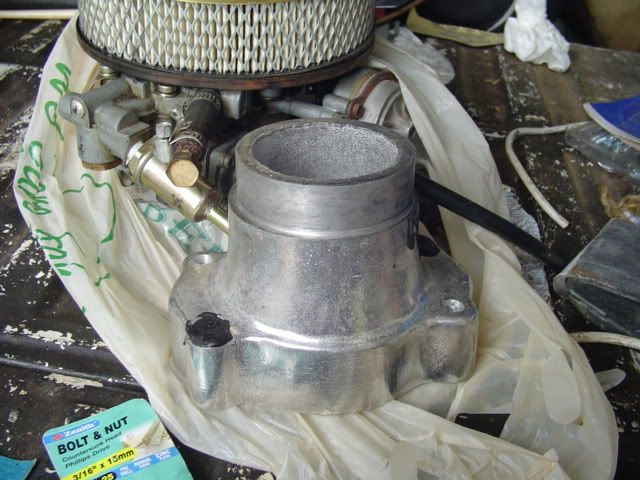

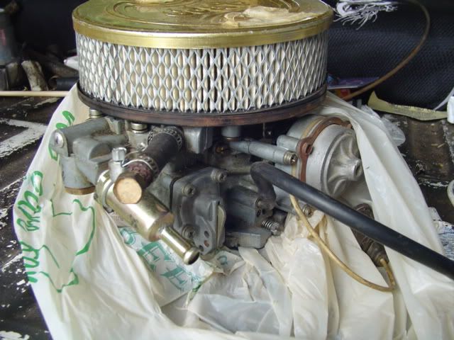

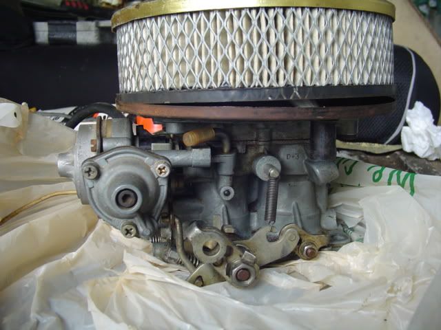

Some photos:
Bonus shot of air horn adapter. two of the holes are filled with gunk because the Holley only uses two studs. Keeping my future options open.
You can see the plugged line on the first photo.
In the second one I'm a little unclear of the purpose of the big plugged one. It's either a return line or a bowl vapour vent line.
The one with the bit of hose hanging off is vac advance.

would be nice to see it out of the plastic bag and without the air cleaner
the the pipe at the top with the big bolt blocking the hole "bowl vapour vent line" goes to the the charcoal canister, the smaller pipe blocked with the factory bung could be used for the "Coasting mixture enrichment dealy" as it is in the same approximate height as the one on the hitachi
