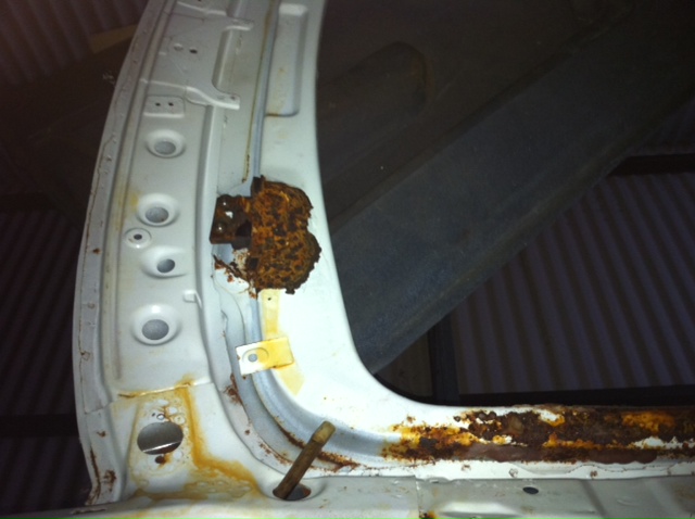

Bad news everyone, I took off the sun roof off yesterday and found a f load of rust threw the roof, if it was a little bit of rust it would of been ok to fix, i'll upload a photo of what i found when i can.
So basicly I am going to take off the panels and all the good parts off my vortex and keep them as spare parts and hopefully find a new vortex and put them on there.
Also I want to say thanks to everyone for the help on this car but unfortunetly wont be able to get this one running.

That sucks n blows both at once:twisted: Is it beyond economical repair?
