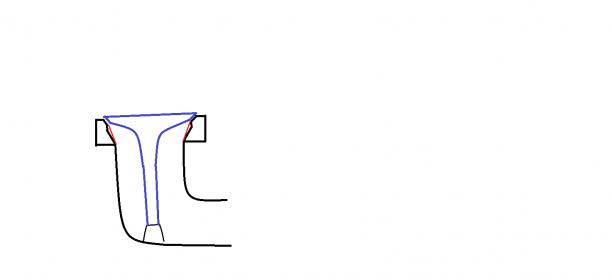

This is an intake valve seat. See where the sealing was happening? well thats on the edge of a large ridge. All the rest of the seat on the intake side is about a mm thinner. Looking at the head I havent cleaned yet that area was filled up with carbon. Hmmm, choices, choices, choices.....do I pull out the seats and put new ones in, or do I just cut these ones down? What do you guys think. Both options are easily doable.....Im thinking just cut these ones. Will have to cut them anyway to restore the valve geometry after decking the heads....but are these worn too much.

Subydoug wrote:This is an intake valve seat. See where the sealing was happening? well thats on the edge of a large ridge. All the rest of the seat on the intake side is about a mm thinner. Looking at the head I havent cleaned yet that area was filled up with carbon. Hmmm, choices, choices, choices.....do I pull out the seats and put new ones in, or do I just cut these ones down? What do you guys think. Both options are easily doable.....Im thinking just cut these ones. Will have to cut them anyway to restore the valve geometry after decking the heads....but are these worn too much.
The valve seat and valves will have 2 cut angles as standard. I wouldn't replace the seats, just lap the valves, then if they don't look good, then I'd have them grinded.

Subydoug wrote:These valve seats really confuse me though. Its almost like they were cut this way. I cannot for the life of me see how they would wear like this. I also think these valves stand a bit proud out of the ports. What do you guys think?
They look correct to me

RSR 555 wrote:The valve seat and valves will have 2 cut angles as standard. I wouldn't replace the seats, just lap the valves, then if they don't look good, then I'd have them grinded.

There's no way a lapping is going to fix this. Hopefully this picture illustrates the problem better. My other heads didnt have this.
Valve guides passed the pop test with flying colors, I think they would be ok. I wouldnt k-line them, just cut some whole new ones and press them in, but Id only do that if Im also doing the valve seats, which Im probably going to :rolleyes:.
Id go new valves and springs just because I can :D. Then she'd be good for another 300k.

Post by RSR 555 » Sat Mar 02, 2013 11:12 am
They look like they have been cut/machined by a shop. I would use them, as long as after you lap them, the face of the valve looks correct and not half/half.. if you know what I mean?
