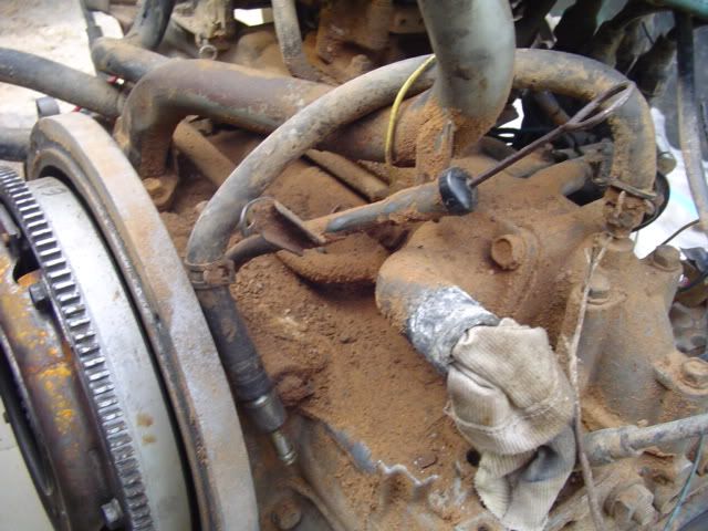

Here's some bonus pics.
The motor before I started cleaning it:
Lots of room:

yes your engine is way cleaner now seems it had never been cleaned in the car it cam out of. on the radiator side of things are you going to mount it on the front of the Kombi or somewhere less noticeable, as years ago a friend put a 6 cylinder in his Kombi and mounted the radiator on his roo bar and ran aluminium pipes from the front to the engine bay for some reason the police didn't enjoy his enthusiasm

now that you have found top dead centre you can time your engine by small increments until under load the engine pings then back it off until you have no ping
I would say it would all be with in a centimetre or 2 of the TDC mark
love the use of the drinking straw to find top dead centre
