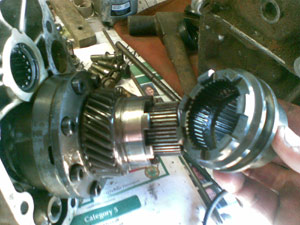

the diff lock light sw is at the bottom on the drivers side of the extention housing below the diff lock lever
these boxes also have a neutral sw and a sw that tells something when its in 5th gear (i think its 5th anyway)

a pic of center diff locking mech
- diff_lock.jpg (25.26 KiB) Viewed 5495 times

Matt the RX's part time box has three switches (mine is a series 1 RX ie 85 built 86 sold here) and the AWD one I have has four switches .
My original ser 1 Aus RX turbo box goes like this .
1) Drivers side .
Nothing , there is an unused boss where a switch could go - neutral if you needed it which a 3 plug ECU RX-T doesn't appear to .
2) Passengers side .
Upper Switch - Low Range .
Lower switch - Reverse light switch .
3) Rear plate , above and in front of the tailshaft .
Almost certainly the 4WD in light switch .
For the record my original gearbox's ID sticker shows TW75FCB-A1 .
In theory I just need to splice the diff locks switch into the original 4WD switch wiring and it should work as per normal except show "4WD" when the diff's locked .
Somehow Subaru have buggered up their WSM for the DR AWD box and it looks like the upper pass side switch is for the low range light and the upper drivers side one the the Neutral switch - not the other way round .
Also it looks like the neutral switch is only required for 4 plug MPFI cars anyway . If your carby or 3 plug ECU ignore it .
Coffee - quickly , cheers Adrian .

To use these gearboxes in an Aus spec L RX Turbo you have to modify the shift mechanisms stay or steady bar because the lower rear of the AWD transmission is deeper and longer than the part time box to house the center differential . The upper rear of the box where the tailshaft slides in is dimensionally the same as the part time 4WD gearbox .
You have to shorten the shift mechanisms steady bar because the gearbox end mounting sits further back and also its cross pin that the steady bar mounts to is shorter than the part time boxes one.
*snip*
The stay bar on mine was shortened and narrowed , see my earlier posts for details of how much . At this stage I think it was shortened too much and 5mm less would be a reasonable guess but I am going to experiment by shimming the rear bracket back from the gearbox case
I can't find the earlier posts on how much to shorten stay and shifter - anyone able to help?
Fang
- Posts: 753
- Location: Lawnton
Post
by Fang » Tue Sep 30, 2008 2:49 pm
I recently nutted this out. If you have Number 35 in the below picture from the donor (Full Time 4WD) box, you should not have to modify your shifter rod.
If you are using Number 35 from a Part time 4WD box they you need to make the modification. I can't remember exacts - but it is a case of trial and error.
