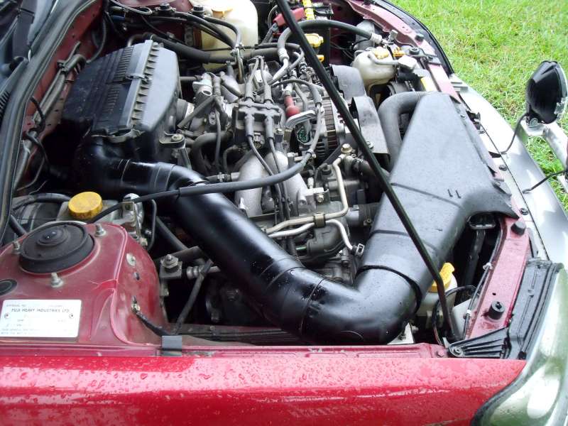

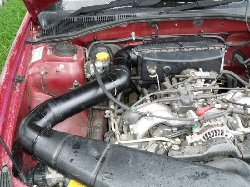

Anyway, i got bored and got thinking about the tiny size of the intake on my Outback, so i went to the hardware and bought two 90, one 45 and one 22 degree 90mm stormwater bends.
I got a 90mm holesaw and cut a bigger hole in my airbox, and then used the bends to connect it to the over radiator intake funnel.
It isnt finished yet, im gonna drive it for a week and see how it goes, it needs a support bracket and its kinda noisy at low revs (sounds awesome above 4000rpm) so im thinking of grafting the resonator back on.
Pics
Not bad for about $17 in materials

I used 50mm PVC pipe from the same family as your bits and the heat under the bonnet of the GLTA caused the stuff to collapse.

looks good and free flowing.
the resonator is a known restriction and gives you couple of free kw if you bypass it. hope the heat doesnt kill it.
i got a kit from supercheap for 70 bucks, with a heap of ali bends and straights and rubber joiners.

Yep, and then you get stuck into the engine with a 9" grinder, eh Gannon? Not likely to be a problem though - that's the standard Outback intake position, and seems to work well.
If you're interested in doing a stage 2, I'd aim to bend or replace that intake funnel to give the air a straighter path straight back towards the airbox entry. Looks good now though.

The little bit on the end of the funnel is a woeful restriction. Thats why i cut it off and heated the funnel up and jammed the piece of 90mm pipe up there. Its much larger now.
Im gonna use one of these Image halfway, as a place for any water to fall into, and i'll drill a little hole in the bottom. It may also quieten it down a bit

You would have to be doing very well to get water into the intake funnel on the outback, i rekon the front of the bonnet would have to be under water before water was sucked up over the top of the radiator. And even if it did, there are numerous channels and holes in the funnel to let the water out.
These pics compare the size difference between the original end of the funnel and whats in there now
