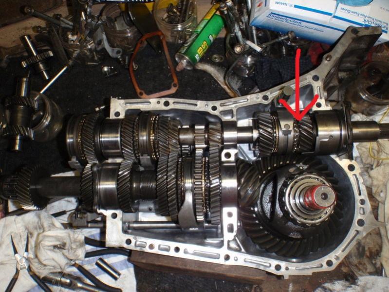

fårwildrajv
Posts: 3
Joined: Fri Aug 03, 2012 4:55 am
Location: sweden
Post by fårwildrajv » Fri Aug 03, 2012 5:19 am
Hello!
you seem to be good at subaru gearbox.
I have a question...
is there a needle bearing on the inputshaft between the HI and LOW speed?
Im sorry if my English is bad and some word get wrong... I live in sweden :rolleyes:
My problem is a bearing noise when i drive in HI but not in LOW so my guess is a bearing between the HI and LOW.
Thanks!
wagonist
Posts: 597
Location: Sydney
Post by wagonist » Fri Aug 03, 2012 5:40 pm
To the best of my knowledge, the bearings supporting the input shaft are the big wide thing to the right, and the thin one in the wall of the casing behind the diff.
When the synchro is engaged, it locks the 2 pieces of the shaft together.
However, when the synchro is the other way, the load goes via the side shaft via the gears which is hidden behind in that pic.
That short shaft is on bearings also, so that might be the problem area.
Anyone disagree?
