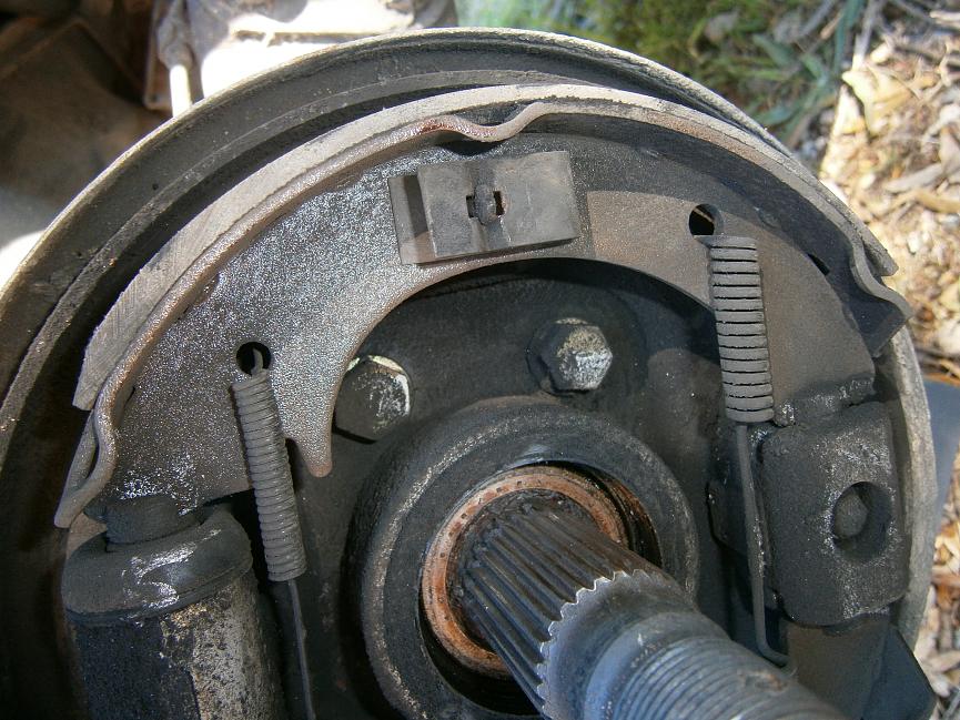

Take a misting spray bottle for damping down the dust with plain old tap water and a basin below to keep mr engineers place clean. The bits come up amazingly clean so long as no oily residue about and not likely given the diff has sals a few feet away :)
A BFH is quite often needed too - backing off the adjusters before even trying to pull the drums off also helps

Went to check my shoes today and one of the axle nuts came off easily (someone didn't tighten to spec) on both sides the washer and conical washer thingy fell out easily and the drum slid straight off, no bashing required. Both sides the pads are bonded onto the shoes, so no rivets to worry about and there is plenty of meat left on them. Thinnest one was 3mm, thickest 5mm (new?) but one brake pad on each side was tapered; 3mm at one end and about 5mm at the other. Brake drums are in great nick and a smidge over 181mm inside diameter, service limit is 182 but they don't need machining anyway.
Engineers advice is they don't need replacing, he's seen pads with about .5mm (:shock:) left and still working fine. He and I still had no idea what could be making the noise, I'm thinking I will replace the shoes anyway since they are very old and only $30 odd to replace, I got pics for Mr. parts guy too, below is the most tapered shoe.

Drums can wear out of square ( I know, they are round to start with :D ) You will appreciate a disc rear end one day :)
