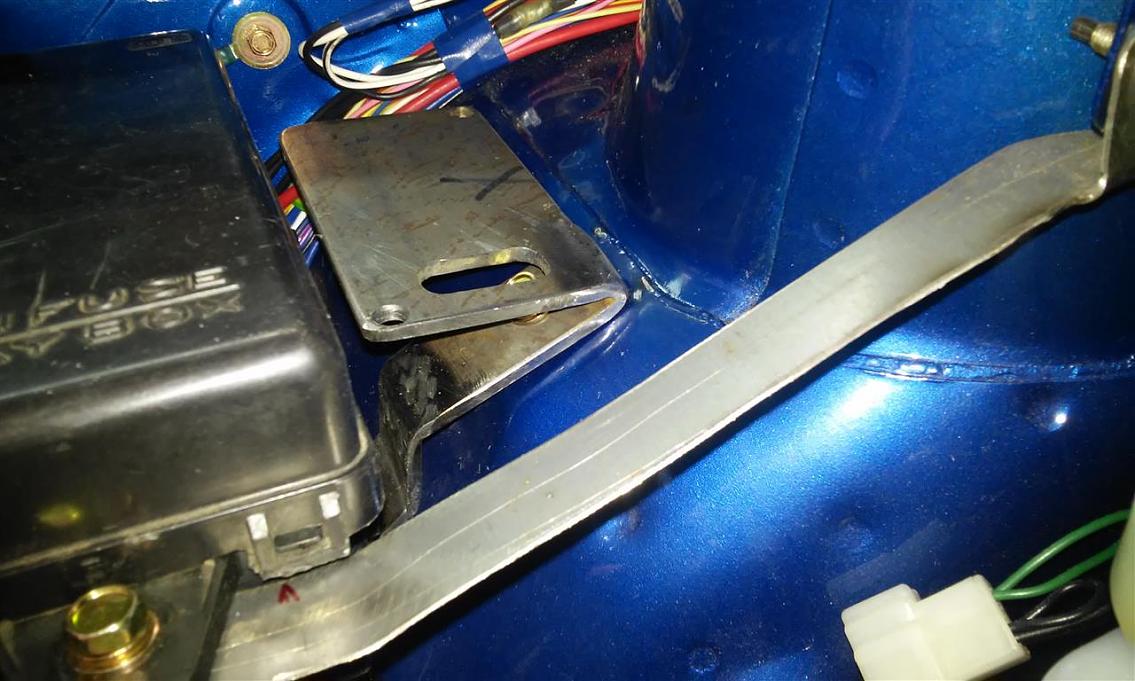

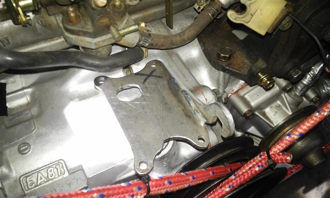

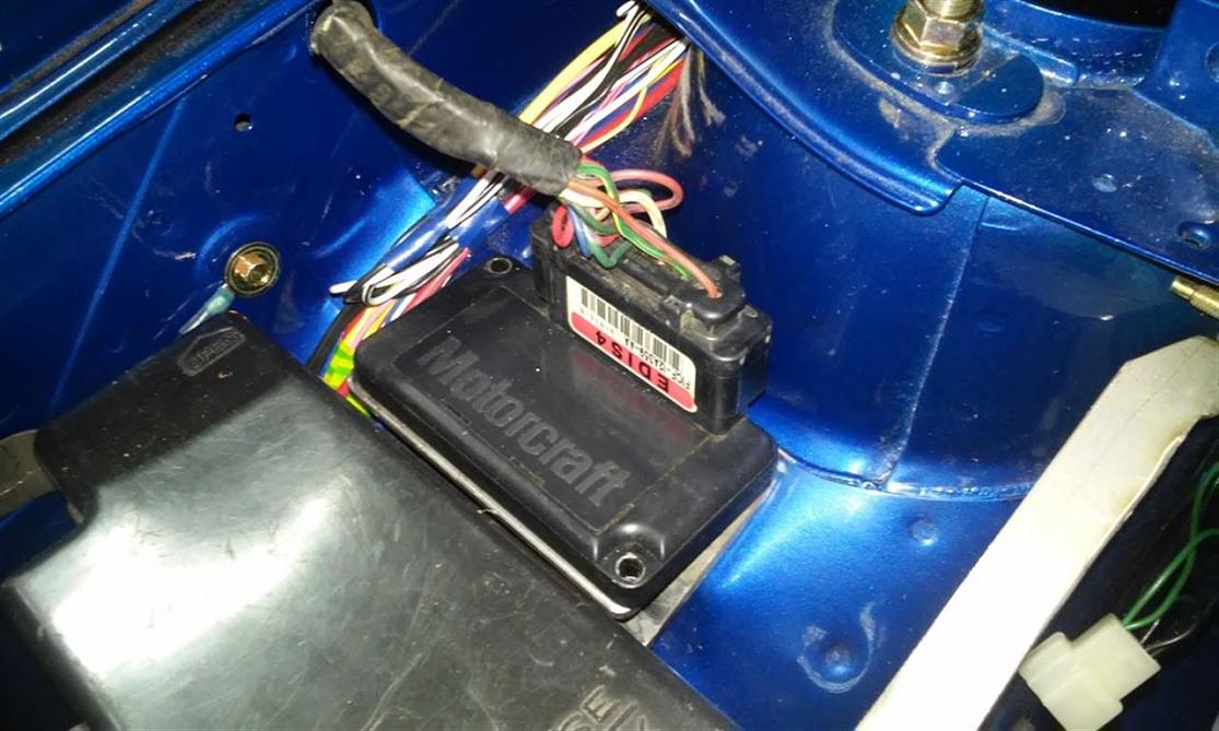

This is where I put the Ford EDIS module; where the original coil pack used to be. A custom bracket was required. If you can't fabricate something like this, you could also potentially just bolt it to the firewall or some other flat spot in the engine bay.

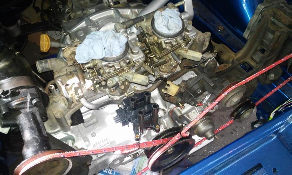

The coil pack was the hardest one to get right, as I couldn't find any convenient flat space to put it around the engine that wouldn't make the ignition leads a mile long. Then it occurred to me - why not put it where the dizzy was? So that's what I did :rolleyes: This needed a very custom fancy bracket to be made since the engine isn't exactly a flat space. Basically the platform is welded to the engine lifting hook on one side. Also there is a small angle piece below the platform which ties into the M6 bolt hole where the dizzy locking plate used to bolt up. The hole is for access to the bolt. I'll also need a plug made to plug up the old dizzy hole.
The rope was to mock up where the belts were going to be.

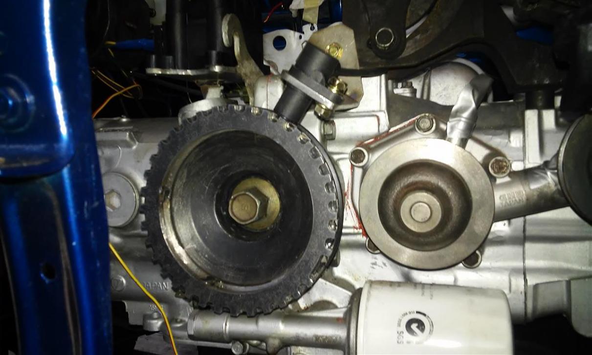

In this image you can see how I mounted the trigger wheel and VR sensor. I found it best to make the sensor bracket and finalize that first, then position the trigger wheel to suit. It is VERY IMPORTANT to get the missing tooth of the trigger wheel correct in relation to the sensor. Basically, the 9th tooth before the missing tooth needs to line up with the sensor when #1 cylinder is at TDC. An easy way to do this is count 9 teeth from the missing one, on the 9th tooth put a center pop mark for reference so there is no way of putting it one tooth out. Since I was welding my trigger wheel to the pulley there wasn't really going to be a second chance! I don't think there is any way you could bolt a trigger ring such as this to the pulley as the pulley material is just to thin. Any bolts going through the walls would hit the belts in no time.

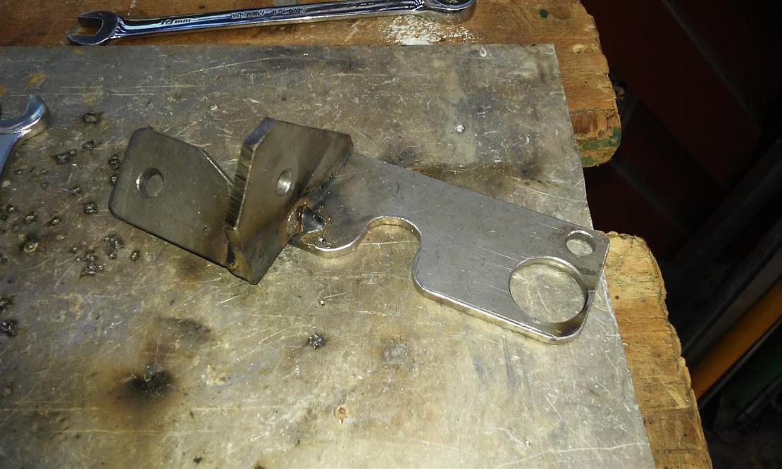

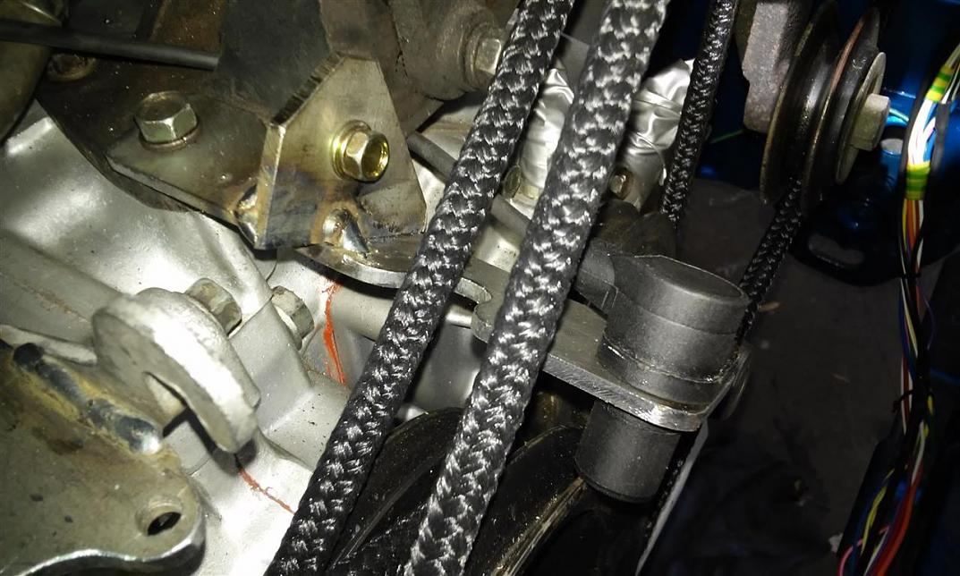

Here is a more detailed shot of my sensor bracket. It bolts to the A/C compressor bracket using existing holes. If you don't have A/C, you'll have to find another way to mount this. Mine isn't fully welded yet, this was in case I needed to change it.
I think that just about covers the mechanical installation part. The only other thing is the Megajolt module itself which has to be housed inside the cabin as it is not weatherproof. This part depends entirely on where you can fit it. Mine is bolted in the area behind where the A/C and heater controls used to be. Since I'm putting a tablet there and not a double din head unit I've got plenty of room behind there. As long as you can easily run the wires to it and a vacuum soupply for the MAP sensor inside the Megajolt.

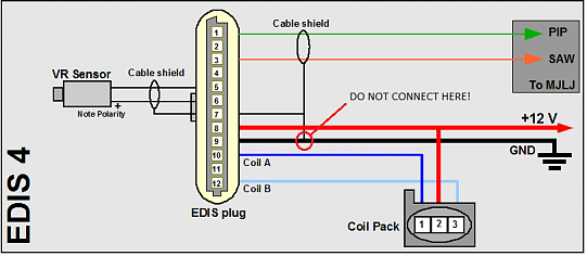

Probably the hardest part is wiring up the EDIS module itself. Since these are all used modules they come with a pigtail of wires hanging off them which you have to solder to. I was really not happy with this but new plugs aren't really available or are horrifically expensive. So make sure you know how to solder and heatshrink for this. Label each individual wire coming off the plug following the guide so you don't make any mistakes. I made one error (explained below) since the wiring diagram was wrong and so ended up with one wire that was nearly not long enough to solder to. That was a bit stressful!
The main error in this image is circled in red below; it shows the sensor cable shields connected to pin 7 on the EDIS module and also connected directly to ground. This is WRONG!!! Do not connect the sensor shields directly to ground, only connect them to pin 7. Pin 7 is internally connected to ground inside the EDIS module, so by connecting the shields to pin 7 and ground there is a ground loop going on, which in the sensor circuits side of things is the worst possible thing that could happen. So first time round my ignition did not work, some research on the net told me the wiring diagram on the Megajolt website is wrong.
It says in the Megajolt guide to ground the Megajolt ECU and the EDIS module at the same point. So I ran a wire from the ground pin of the Megajolt to the outside of the car, and joined it to the ground wire for the EDIS module which was then bolted to the chassis/body. For 12v+ I added a relay with 2 x pin 87. The fused power comes through the relay then one pin 87 to the EDIS module and coil pack, the other 87 goes inside to the Megajolt.

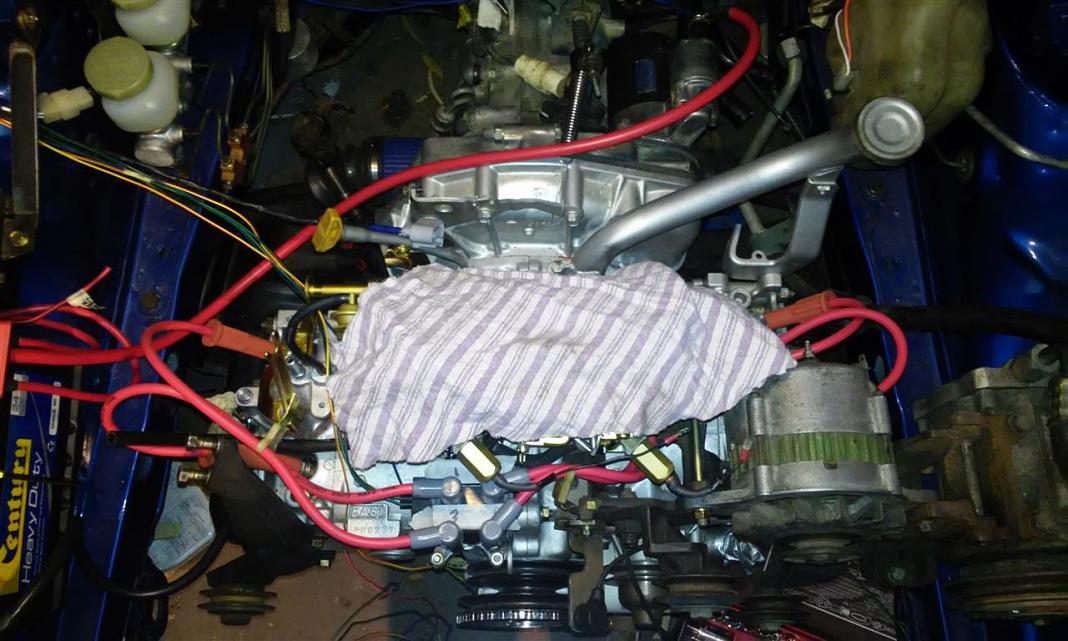

Below is how I arranged the ignition leads.

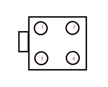

With the coil connector on the left this is the numbering, pretty straightforward

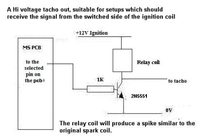

Now because we essentially have 2 coils there are really 2 coil negative posts (the two outer wires at the new coil pack) If you were to connect the old tach to just one of the coil wires I'd be willing to bet the tach would indicate half engine RPM. The Megajolt installation guide mentions their wiz bang tach adapter board (which I bought) that has some diodes on it as pictured below. This didn't work for me either on the first engine fire up and I couldn't work out why. Some more thought on the subject has led me to thinking the tach adapter circuit below is wrong for our cars, the diodes should be the other way around. I'm yet to test this for myself so stay tuned.
***EDIT*** 4/7/16
Can confirm the above circuit with diodes does not work with the stock MY tacho. Neither did my idea of turning the diodes around in that circuit. Having done some more research on how the stock tacho works, it seems something a tad more complicated is required. See below:
I will try the above circuit with a gutted relay which should imitate the original ignition coil. That picture is for megasquirt ECU but the megjolt ECU also has a positive + tach signal pin which can be used to drive the transistor. Full explanation on page 2 of this thread since I don't want to clog up this post with super technical jargon :)

So my plan is to build the circuit which I've added to the main posts. Using a gutted relay (using the relay coil only) and a transistor, hopefully this will simulate the original ignition coil (relay coil still makes a magnetic field, which will collapse when switched off and make the same high voltage spike) The signal to turn the transistor on and off will now have to come from the Megajolt ECU, not the coil pack.
Fingers crossed this will work, if it doesn't then I'm out of ideas on how to drive the stock tacho with EDIS :(

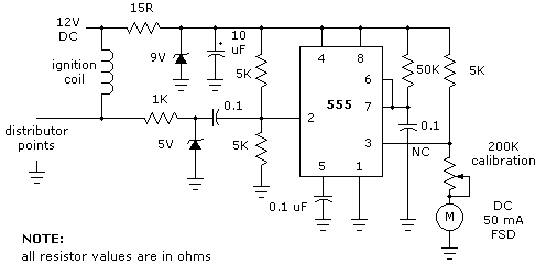

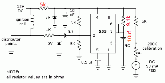

Post by Silverbullet » Mon Mar 13, 2017 11:08 am
I know this conversion is done and dusted now but I just thought I should update the stock tachometer situation in this thread. As I said in earlier posts, the stock tacho doesn't work on the EDIS signals - I didn't end up doing the hacked relay trick because I was convinced of a better option. I ended up pulling the instrument cluster apart, removing the stock tacho PCB and making my own from scratch using the 555 timer IC chip. The 555 tacho circuit is as old as the hills; tried, tested, simple and effective. I initially had some problems after I made the circuit with it not working, or the needle being very jumpy and vibrating. It took me a long time to work out why - all the circuits for this you'll find online are just what some electronics whiz has dreamed up and what he thinks should work, most of them haven't even been tested on the bench let alone on a car :-x
Here is the circuit diagram I initially followed:
This circuit has a number of problems:
1. The input resistor (15R) is completely wrong, with 15 ohms here the 9v zener is dissipating something like 4-5 watts! With most zeners being 1-2w rated I went through a few zeners before I realized what was happening. A 5k resistor here is much better.
2. The timing resistor and capacitor on pins 6 and 7 are are bad choice (especially for this application) This choice of values gives an output pulse of .001 seconds duration. The end result of this is a shaky/vibrating needle since there's too much off time between the output pulses going to the meter. I worked out the maximum on time I could have for each pulse at 10,000rpm was something like .012 seconds, so I changed the resistor to 9.1k ohm and the capacitor to 10 microfarad to get .010 second pulses. This is when taking a signal from 1 coil only out of 2 so I'm getting half the pulses than if I was reading off both coils.
After this it worked much better. To calibrate the circuit on the bench, I found a 240v to 16v a/c transformer and connected one line of the 16vac to the input, the other line to ground of the circuit. This triggered my circuit at 60hz mains frequency, which on a regular 4cyl car would be 3000rpm. On mine because I'm reading off of one coil, I calibrated it to 1500rpm.

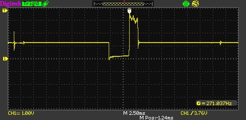

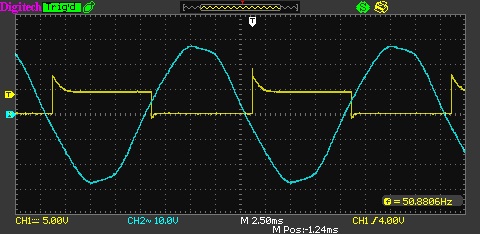

I borrowed the oscilloscope I use at work and it can save screen grabs to USB so:
The blue line is the 60hz mains sine wave (stepped down to 16v) you can see as soon as the sine wave goes negative, the tacho circuit triggers and makes a positive pulse at the output for the set duration. If you count the squares, you will see it is exactly .010 seconds :cool: The constant pulses going to the needle movement is smoothed out by the movement giving a stable reading at the needle. As the input frequency increases (higher revs) the output frequency will increase and the needle will move higher.
If you're interested, this is the signal coming from the ignition coil:
This was with the probe at 10x division so each square represents 10v. You can see the coil sits at 12v approx until the EDIS module disconnects it from ground for about 3 milliseconds. At this time, the coil fires from the secondary to the spark plug but also there is a huge 40v spike on the primary. This is the spike I was talking about it earlier posts, you get this when you turn off any inductive load (coils) e.g relays which is why they have supression diodes. The 5v zener, 1k resistor and .1uf capacitor in the tacho circuit prevents this spike from damaging the 555 IC.
Okay so the last little bit was probably not necessary to explain and maybe too technical but I thought I'd post the scope screen shots anyway, so you guys can see what is really going on when I'm talking about pulses and duration etc etc. Oscilloscopes are great fun :)

As for the other coil likely in Sam's project pics - it looks to be also in our Ford Focus of 2002 with a Fuelmiser packaged, Delphi labeled coil CC239, which correlates to being a GOSS C220. This , I think is "type 2" trigger wheels refers to, smoke stack smooth coil towers with a male centre pin.

I bought a trigger wheel from trigger wheels in the UK, recommended me to get the one with half inch hole, rather than their ring gear style.
An old machinist mechanic skimmed the rear pulley V down square and flush to take the ring gear he made out of the wheel.
Oddcomp from USMB wished he made his ring gear an interference fit rather than loose as each time he welded it and found development problems, loose fit was no longer his choice. It was his discovery of welding a trigger wheel to the outer damper of the EA82 turbo harmonic balancer was not a good idea as it started to slip on its hub - causing timing of CAS and missing tooth to go out. He had to cut his weld, re-align, weld n go gain.
Interference fit , loctite might mean no weld.
Using Sam, Oddcomp and a few other online experiences and that of my machinist - the trigger wheel attaches to the hub of the harmonic damper to avoid problems should damper outer balancer slip or fail. Using trigger on a rubber mount may also play with sensor gap between trigger teeth and CAS
