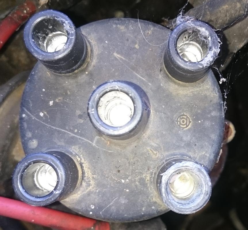

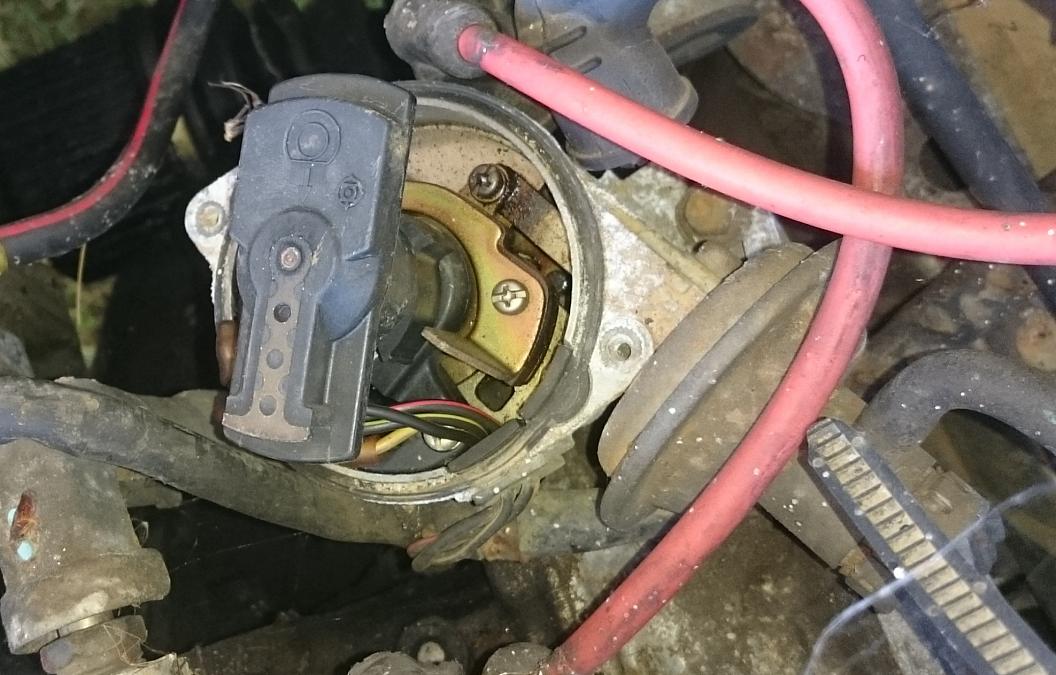

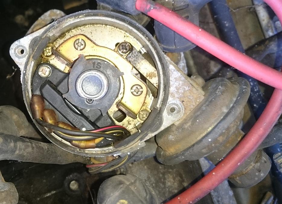

Not sure of dizzy number or other internal parts info but I can tell you that these attached pictures are of the distributor in my 1987 Vortex with the EA82T engine
