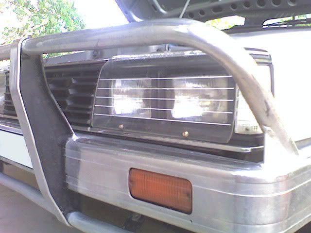

P.S - One of the first things I did was put on some spare headlight cover's that I had laying around :
For something different ... :) ... ( Also help's to keep the bugs out ) ...

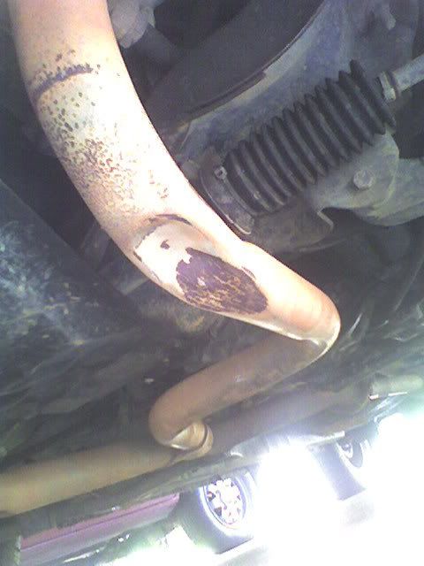

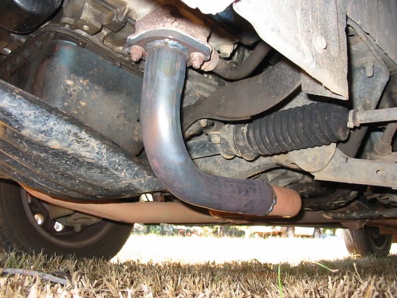

During my travels ( back in 2007 ? ) I somehow mangaged to hook up on something and did this ...
With a restricted airflow + the resulting odd sound eminating from below, I promtly had the offending bit cut off & replaced ...
Now there's another odd sound comming from it ... :rolleyes:

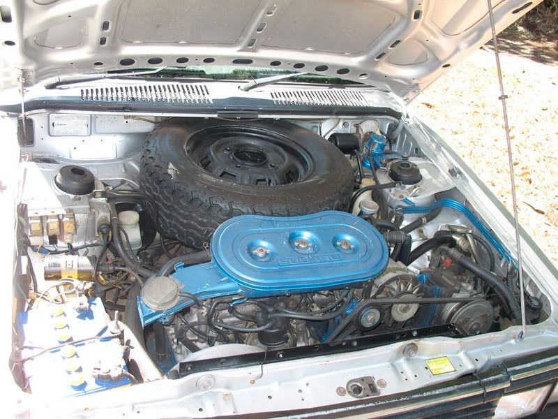

Here is what's in it now ...
For the observant among - you will note that the dizzy & Leads have been installed back to front, I had to remove it & put back correctly ... ( it still ran though odly )
Well after that a new engine was next on my agenda, but the GFC has put a stop to that for now.

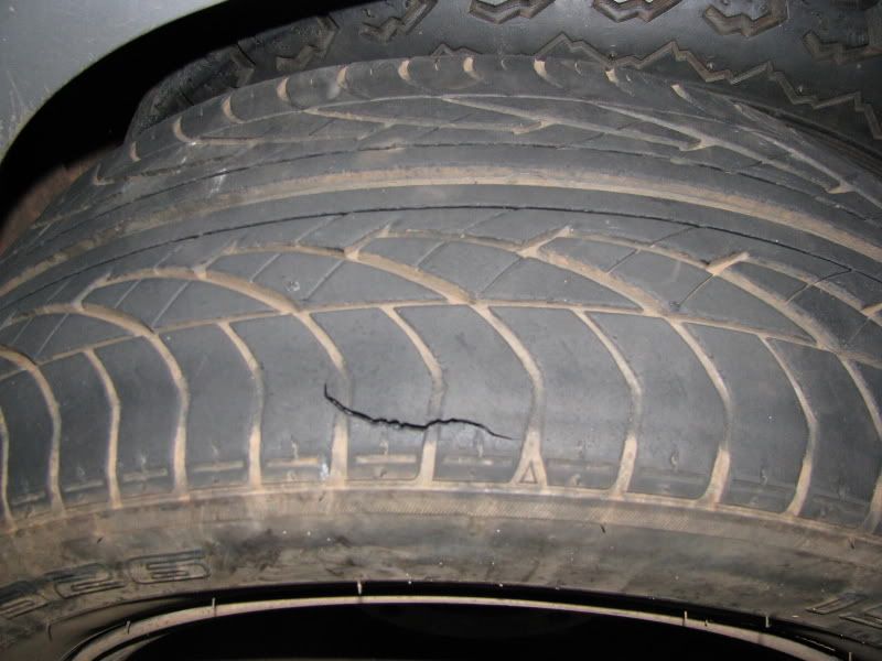

Here is something that bugged me as to what it was ...
Untill it finally let go ... :oops: ... ( It was about 3 years ago now )
Happend to the other one as well ... :( ... ( same brand: Falken )
Must of been a 'bad tyre' as it had delaminated ... probably too old too !
Has any one else come accross this ?
Note: The above images are of not the same trye ...
Post by steptoe » Sun Oct 14, 2012 8:41 am
run a tyre flat and it can be damaged, pump it back up and no one knows until some time later when things like this may happen. I used to wonder why some tyres had all these varying size balls of rubber inside when striping off rims - comes from running on a flat tyre like above. I've also recently pumped up some old tyres on a gauge that tells lies. Gave me 44psi in tyres made for no more than 35 and 36 psi. Within weeks I had odd vibrations and suspected unijoint or centre bearing and started to remove tailshaft - next thought was tyres. Both on the rear were rooted with slight delam bubbles. Wights and measures need to sort out the dodgy gauge
Posts: 2067
Reputation ...
Post by Bantum » Sun Oct 14, 2012 4:44 pm
:shock: ... Yeah that's what I thought of at first, but had been keeping eye on tyre pressures & I'm pretty sure I hadn't run on them flat ... :)
It's probably more just a case of old age I think, as the rubber had hardened due to age - not sure how old they were, but they had been there since I purchased the Ute.
I've also herd that particular brand has had a bad reputation for longivity ... Also you can't get them any more, so that would suggest something to me.
All fixed now though ... :)

Also thinking about it now that I've replaced them, I can tell you it was making noise / vibrations which were felt through all wheels as they started to 'delaminate'.
Hindsight is a great thing somtimes ... :)

Bantum wrote:Here is something that bugged me as to what it was ...
yea my rodeo did that to a set of kumho,s... may have been my fault... bridgestones fixed the problem till they wore out and did the same thing

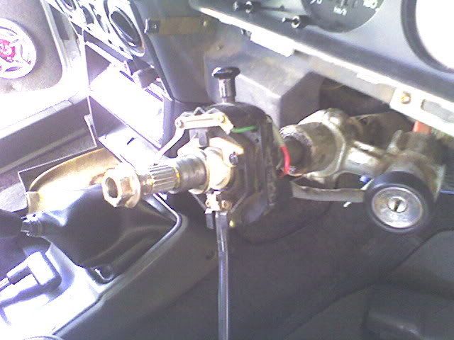

Post by Bantum » Sat Jan 05, 2013 2:01 am

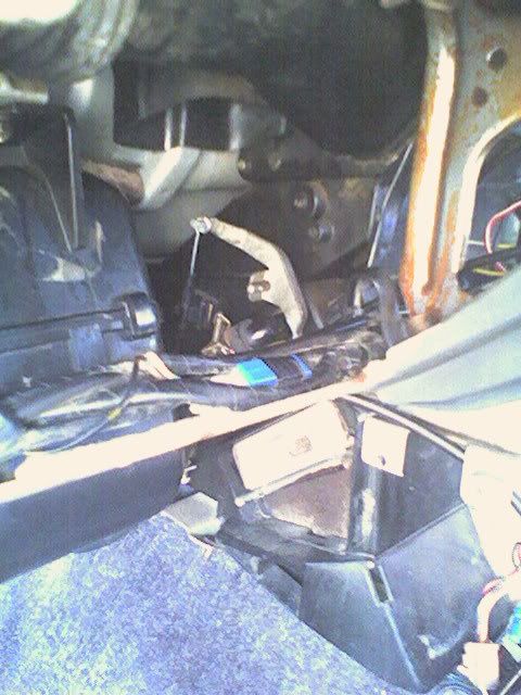

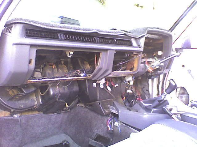

Next on the agenda was to fix the wayward indicator return ...
Link to 'fix' process here ...

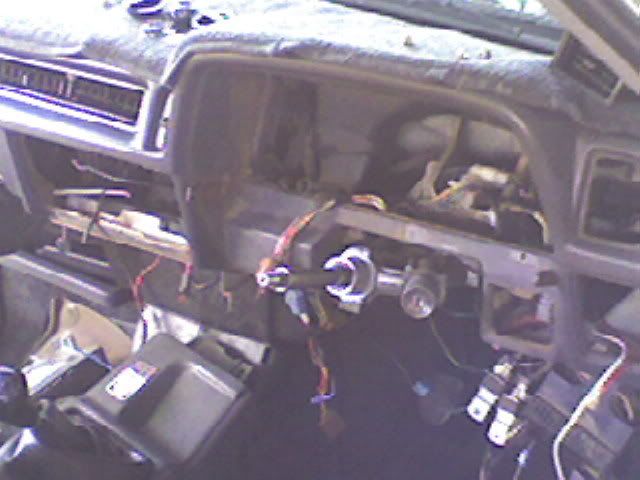

I ended up having to strip most of the dash to fix a few other problems too ... :D
Another shot of dash stripped ...
Note: Apologies for the quality of images as I didn't have a camera at this time, just an old mobile ...

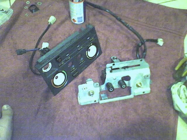

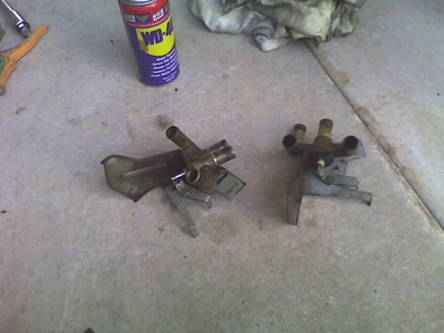

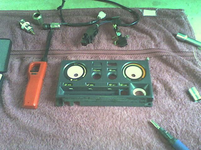

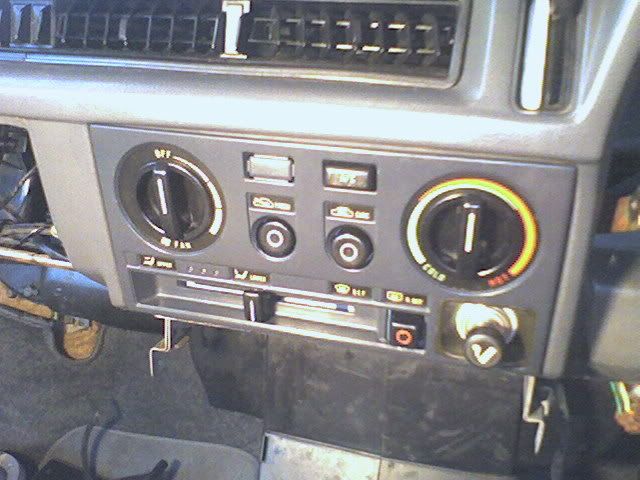

The heater contols also needed some work to them free up ...
Contol panel cleaned up and repaired ...
Heater control cable made working again ...
Also swapped out heater stop valve ...
Old one is on the right - it was corroded & not working ... :(
Now back together & all working as it should ... :)
Anyone come accross the dimister button ? as it's not linked to anything on a brumby ...
Post by steptoe » Sat Jan 05, 2013 7:39 am
That button can be handy if you have it for a manual fan relay switch, driving lights, supercharger clutch :D ....must be out of none ute , or I guess if Smiths still sell rear window demister kits......
Posts: 2958
Post by Silverbullet » Sat Jan 05, 2013 12:36 pm
My Brum has that button too, not sure why they didn't just leave it blank :confused:
