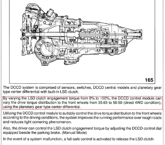

Yeah spot on, when locked its a 50/50 split, but when open, its 65/36 open diff with no LSD'ness. Its also variable between these two extremes too. You'd be surprised how many Subaru enthusiasts have trouble grasping that.taza wrote:I like the idea, nice work! Does that mean that you would hit the switch and it would lock it 50/50 for that small amount of time? Then when unlocked but be like a standard AWD centre diff or 65/35 split?
My understanding is that the torque split is always 65/35 no matter how much lock is dialled in. The 65/35 is derived from a mechanical planetary gearset with differing sized gears that still give the same output speed. This mechanical connection cannot be changed therefore the torque split cannot be changed.Gannon wrote:Yeah spot on, when locked its a 50/50 split, but when open, its 65/36 open diff with no LSD'ness. You'd be surprised how many Subaru enthusiasts have trouble grasping that.
The DCCD simply adjusts the time the LSD plates are locked via a PWM (pulse width modulator), or the LSD'ness as you put it
I think you just need to switch the DCCD Pro to manual and dial up the amount of LSD Lock you need (which will be 100% more often than not I would guess). You will soon know if you have left it locked as it will bind up and let you know in which case you simply wind the lock off.guyph_01 wrote:Now,

Yeah common misconception. If the centre was locked and gave a biased torque split, the front and rear wheels would have to be turning at different speeds, which would chew your tyres or twist your tailshaft pretty quick.niterida wrote:My understanding is that the torque split is always 65/35 no matter how much lock is dialled in. The 65/35 is derived from a mechanical planetary gearset with differing sized gears that still give the same output speed. This mechanical connection cannot be changed therefore the torque split cannot be changed.
When the diff is open and driving on a straight road, the output shafts are forced to turn at the same speed because the front and rear wheels are turning at the same speed, but the planetary gearset is trying to turn the front wheels slightly faster than the rear.
Under acceleration in open mode, because the rear output shaft effectively has a lower reduction ratio because of the planetary gearset, it gets a higher share of the torque.
Imagine having an open centre diff and a 3.9:1 diff in the front and a 4.44:1 in the rear. The rear has more reduction, thus gets more torque, but the diff gears absorb the speed difference and there is no binding.
In locked mode, the clutch plates lock the front and rear output shafts and force them to turn at the same speed, like any other locking diff.
The clutch plates override the gearset and thus the output torque split is 50/50.
Imagine the above example with the 3.9 and 4.44 diffs and then run a belt from the front to the rear wheels on each side. The torque split from the planetary gears/different diff ratios is still the same bias, but because the locking force is on the outside of the bias, it creates a 50/50 torque split.
Its physically impossible to have a locked diff with a biased torque split AND have the front and rear wheels turn at the same speed.
I hope I have explained that right

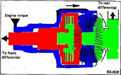

Although this drawing is rather rough and shows bevel gears rather than planetary gears, the theory is the same
The green side gear to the rear is larger than the red side gear to the front, which provides the rear biased torque split because it has a higher reduction ratio, with the blue spider gears providing torque from the engine. The clutch plates lock the red and green shafts together, cancelling the bias and providing the 50/50 split

According to the technicians reference for the dccd, it requires a PMW signal of between 300Hz and 2kHz at a maximum current of 4 amps.
So what you need to do is get a PMW controller that works in that frequency and adjust its maximum to limit current to 4A. It should read about 7V on a multimeter in this condition.
