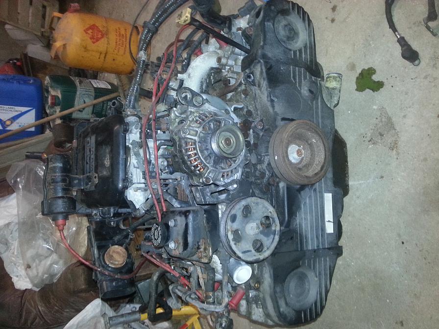

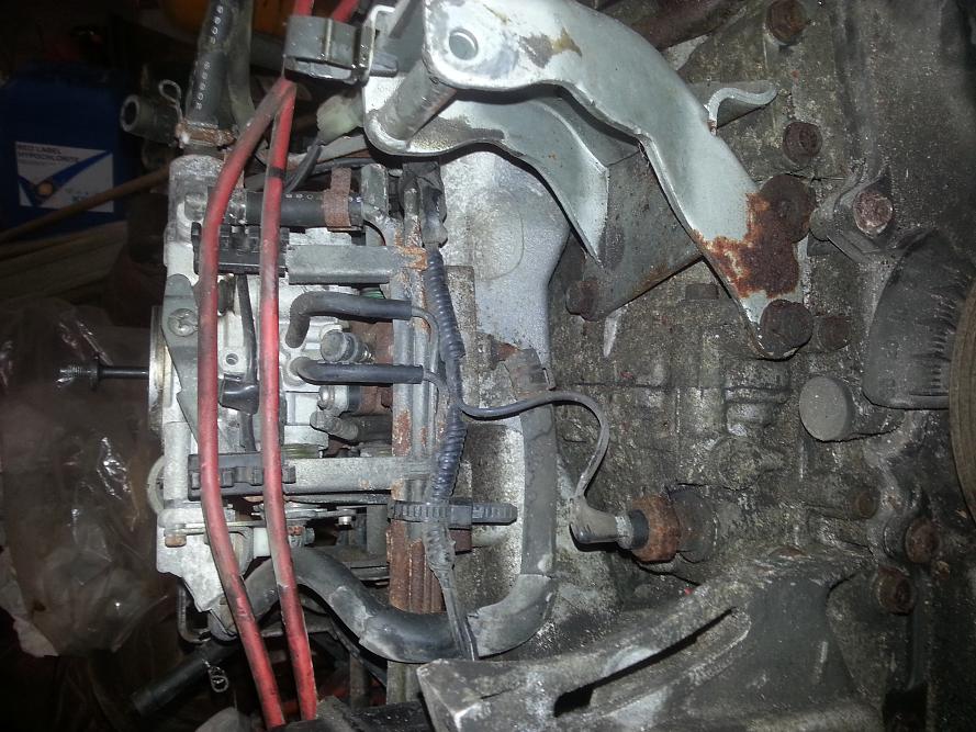

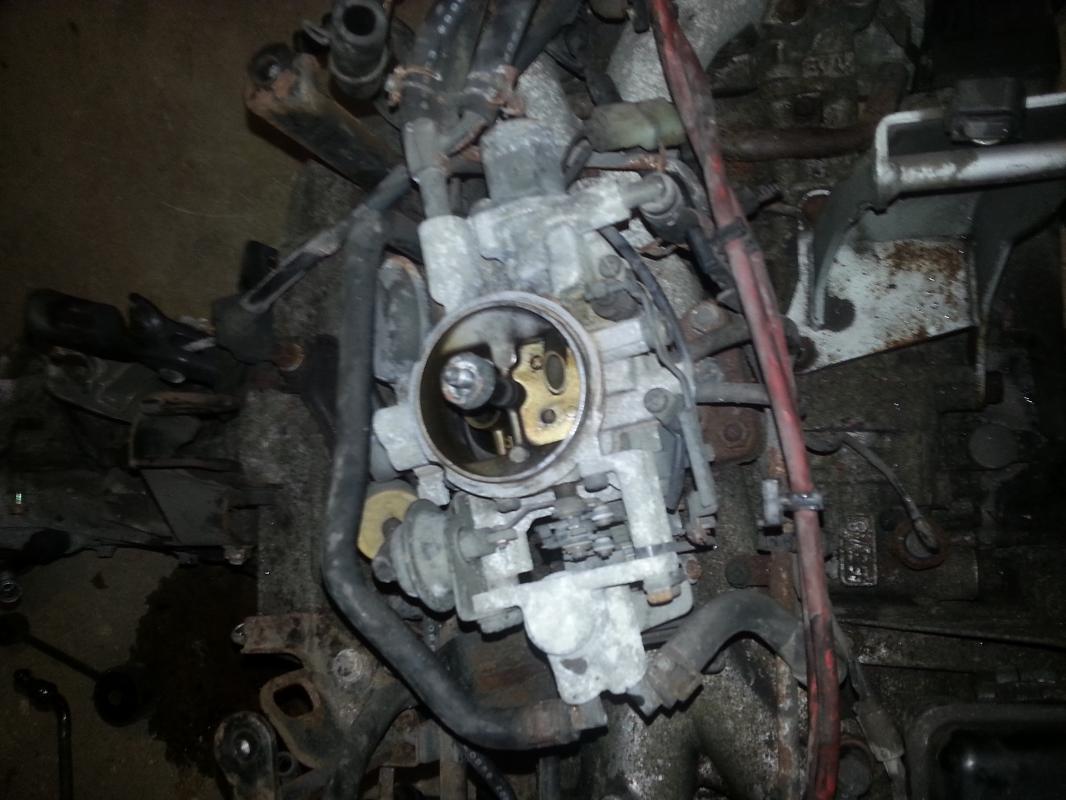

lifted the engine today. It has 32k miles with dealer service history so thats a good start.
He has another if anyone wants it :grin:
Anyway heres some pics
Post by TOONGA » Sun Jan 19, 2014 12:43 pm
Ah the mythical carbied EJ very nice :)
I would love the manifold, carby(+air cleaner) dizzy and coil from the other motor, but I would say the dealer would only part with the whole lot.

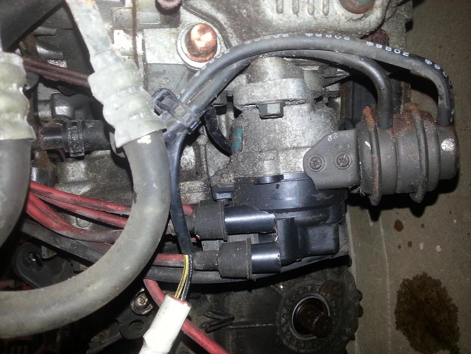

Post by wagonist » Fri Jan 24, 2014 1:58 pm
I've got a crook neck from the photos :p
Trying to pick where the dizzy mounts, but can't get it.

Post by Gannon » Fri Jan 24, 2014 5:20 pm
Dizzy mounts to a removable blank cover on the back of the driver side head

Sorry about the bad pics . I had spare time this evening and got the fwd gearbox of the engine . Im having fun trying to get a dual range ej gearbox to swap casings with my ea82 item, and this is tempting me to just use a single range awd transmission from a 1.6 impreza that I can get. Im not sure if it would be as strong as other n.a single range ej transmissions from the larger displacement cars, but its close to hand and available.
