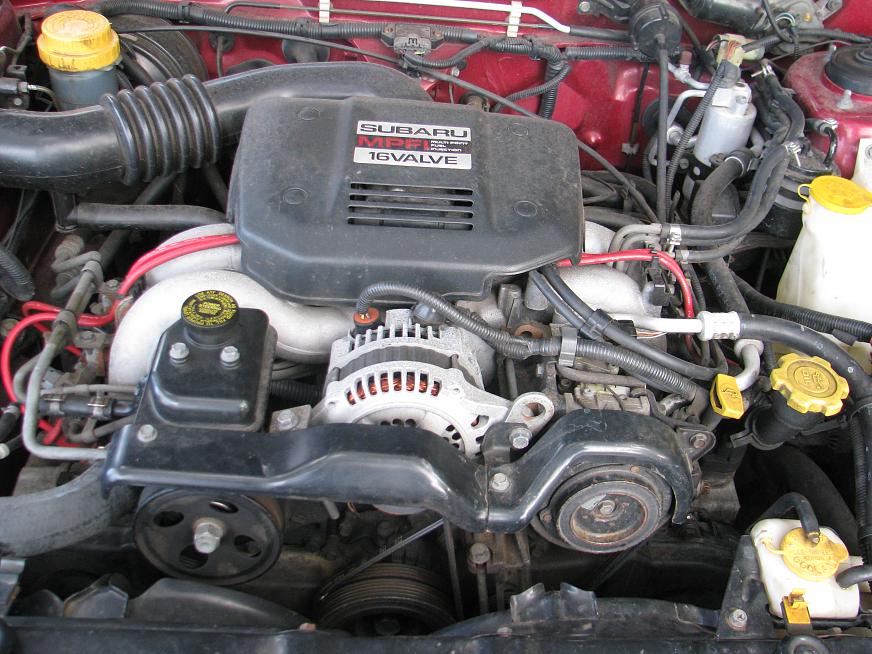

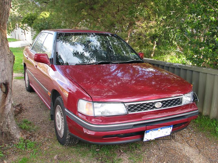

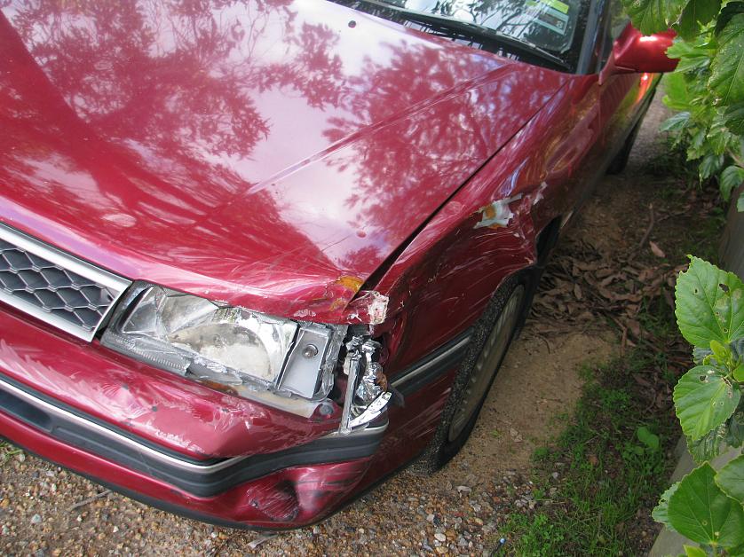

well, i went shopping the other day and came home with a liberty gx, 1991, auto
still got a months rego, 230k on the clock (a little bit more than i really wanted), runs well, electric eveything still works. the guy i got it off had his wife prang it, and he decided it wasn't worth fixing --> refer to photos for damage (the globes are even all still fine!). it also had a very very flat battery, had been sitting in his yard a couple of months but swapped in the one out of my L and we were away. got it for $500, so i reckon i did all right!
so i now have a predrilled flywheel, adaptor plate, an ej22, wiring to cut down and ecu
just have to wait till uni ends this sem to get really stuck into it
it does kinda seem a shame to wreck the Lib though, it still runs excellently and its still licensed!...
anyway, i will make you guys look at a couple of photos anyway, sorry i know how much you guys hate them
