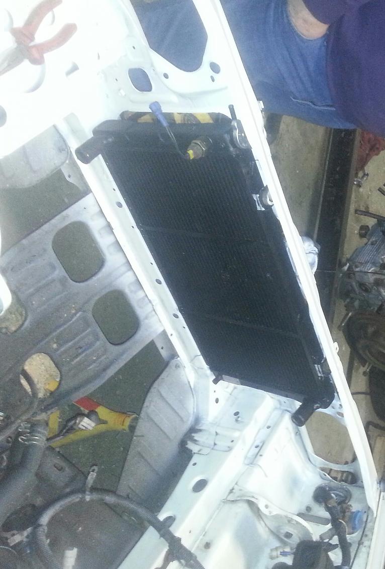

I'll get those pics right yet. Heres another of the saab radiator in place. The rubber grommets from the old l series rad fit onto the dowels on the bottom of this rad also. I may be lucky to get one of the original holes for the lower dowels to work, but it won't be difficult to drill two if its nessecary for best location.
New holes have to be drilled for the top fixing points on the rad when I have it exactly where I want it

yobhgareb wrote:I'll get those pics right yet. Heres another of the saab radiator in place. The rubber grommets from the old l series rad fit onto the dowels on the bottom of this rad also. I may be lucky to get one of the original holes for the lower dowels to work, but it won't be difficult to drill two if its nessecary for best location.
[ATTACH]4379[/ATTACH]
That's an awesome fit - the radiator outlets are 40mm as well? And this came from a 2 litre turbo saab correct?

Pretty chuffed with the radiator myself, took a few evenings of trawling
through ebay looking at all the rads for sale and reading dimensions
before I chose this one. It is indeed from a saab 900 turbo , the model
that came out in 1985.

The outlets are the same as ea82 radiator.

yobhgareb wrote:The outlets are the same as ea82 radiator.
Bummer - but might look into it as an option too. Looks like I might have a few options to follow now :D

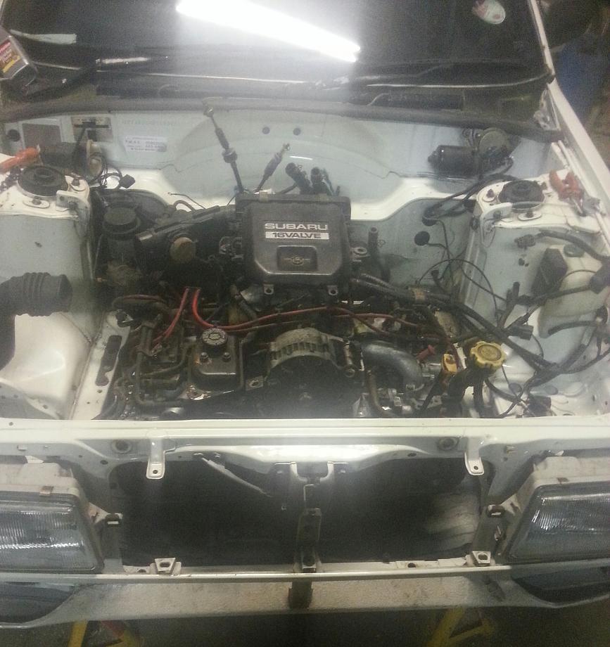

[ATTACH]4404[/ATTACH]
Just dropped the engine in to see how it fits. I believe I'll still get my spare wheel in too:D
