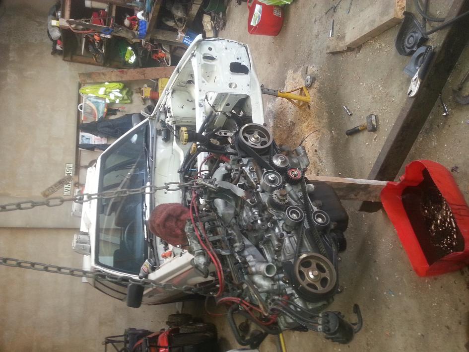

Post by yobhgareb » Mon Feb 24, 2014 3:48 am
I removed the ea82 engine and gearbox today.
[ATTACH]4362[/ATTACH]
Here is the old ea82 unit in the middle, with the ej dual range in front, and the carbed ej18 in the back ground.
[ATTACH]4363[/ATTACH]
I noticed my ea82 dual range has 25 spline stubs , the same as the ej dual range box I got for
the casing. The fwd ej box that came attached to my carb engine has 23 spline stubs.
The distributer and coil are on the opposite side on the ej engine, so I have to extend the wiring for the loom to reach to the drivers side of the car. The saab radiator has the temp sensor on the other side, so the wiring has to be lengthened again.
Im going to spend the next few evenings giving the engine bay a good clean and touch up some surface rust.

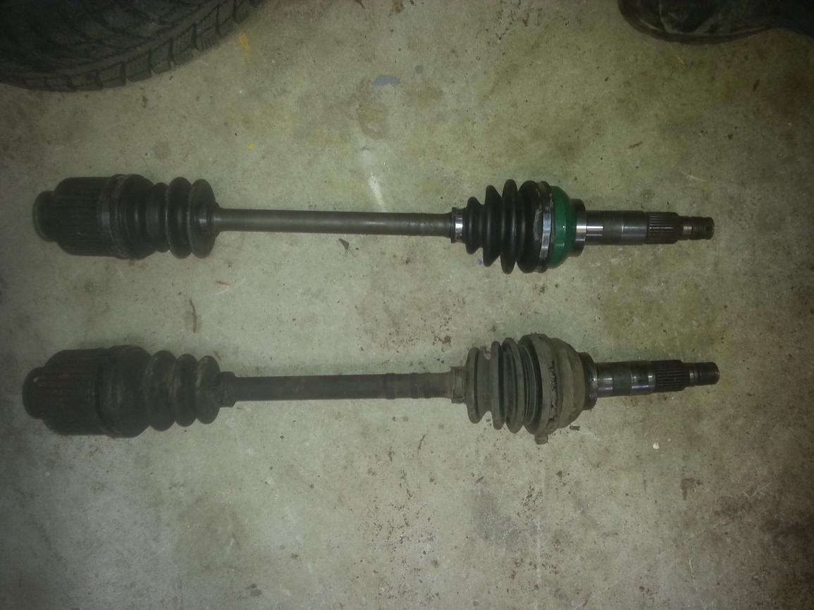

Post by yobhgareb » Wed Feb 26, 2014 5:14 am
The dual range was the original from my 1986 carb l series. It will be handy for axles being a 25 spline. I noticed the axle shafts are thicker than 23 spline items ive seen pics of. I have a new genuine front axle I bought for a non turbo xt. it has the same inner and outer spline count, but a thinner shaft.
[ATTACH]4365[/ATTACH]
We must have got turbo xt axles in the front of the 4wd l series over here:D

Post by RSR 555 » Thu Feb 27, 2014 9:04 am
From what I've found in Aus over the years it that...
1 band on the shaft = 2WD
2 band on the shaft = PT4WD
3 band on the shaft = EFI (incl turbo) and FT4WD
But this could be different around the world.
BTW.. this last picture looks a good size :)

Post by RSR 555 » Thu Feb 27, 2014 9:20 pm
El_Freddo wrote:^^ Really? Never knew this - never looked at those bands before to be honest!
This is only what I've noticed (on MY and L.Series) over the time I stripped them down in the wrecking yard in Japan and Aus. but I never seen any documents from FHI to support this.
The later EJ ranges seemed to use a similar pattern but the 2WD shafts were much thicker than the AWD ones.
