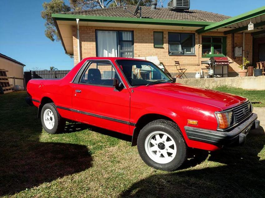

Post by Phizinza » Sun Jul 02, 2017 9:48 pm
Gave it a cut and wax today. Changed the oil to some fresh penrite full synth. Scraped overspray off all the glass. Made some small adjustments to the low range lever adaption to solve a reverse/low range clash.
Also swapped the 14"wheels back on the Lib so I can sell them separately.
Posts: 12695
Post by El_Freddo » Mon Jul 03, 2017 9:26 pm
Look good mate!
You found a set of 14 inch sunnies?
henpecked
Posts: 449
Location: South Oz
Post by henpecked » Mon Jul 03, 2017 10:10 pm
Look closer, i don't think they are sunnies ;)
Posts: 12695
Post by El_Freddo » Mon Jul 03, 2017 10:19 pm
henpecked wrote:Look closer, i don't think they are sunnies ;)
Well they're not scorpions or desert rats - and they have the factory offset.
Look like a set of 14 inch sunnies to me. I don't know who made them, but that's what I've known them as.
