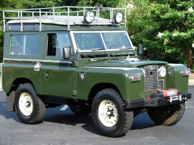

When it comes to in car cooling the three best things ever invented came out of the UK
Land Rover tropical roof is number one
Land Rover lift up vent panel below the windscreen is number two
Number three made it's appearance in Mini Panel vans and has since been stolen by all and sundry and added to their rally cars and Off road racers and is of course the humble Roof vent awesome for keeping cool and more important positive pressure inside the cabin so no dust comes in, Unless of course you spin out from tyring too hard and end up in your own dust cloud.;
