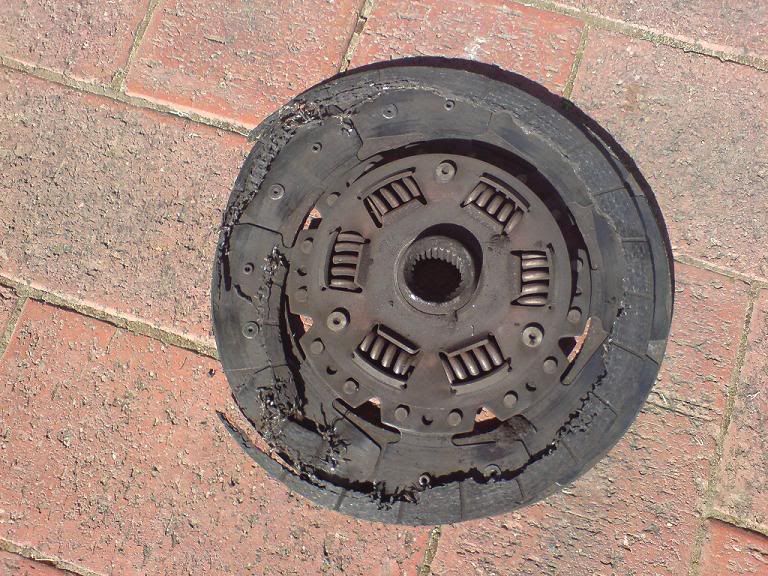

And you really did a number on that clutch plate haha nice to see it's going back together and "off the road" again

cool, Looks like its pretty much what happened to mine. Except i didn't keep driving to completely destroy it:D
- Posts: 12677
Dann wrote: And you really did a number on that clutch plate haha nice to see it's going back together and "off the road" again
guyph_01 wrote:cool, Looks like its pretty much what happened to mine. Except i didn't keep driving to completely destroy it:D
Hehehe... Thanks fellas. It didn't really dawn on me that I could have a bigger issue on my hands (not propelling forward to get home) until I said something to a mate that afternoon that it happened just before we left Lakes Entrance!Alex wrote:your clutch reminds me of mine
Alex - how the hell did you do that? I still don't understand how I did mine but that one looks toast! EA clutch I presume? Crazy.

Ok, so I could be a little toasted so bare with me... Alex, if you've forgotten, this is what we love most so take note
Here's a few more pics of the damage that I've noticed while looking at the various parts that used to be my clutch disc:
