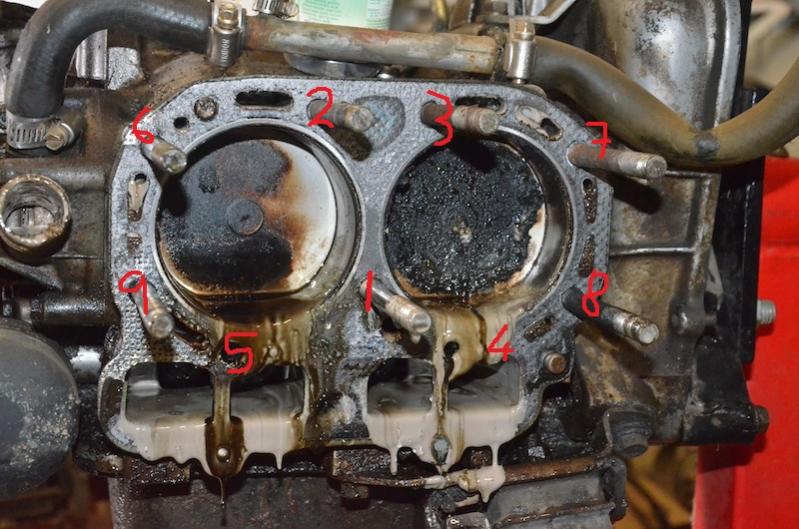

We were thinking there was a pretty major head gasket issue, until we removed the driver's side head:
This has been washed down, anyone notice what's missing?
There was a little bit of surface rust on the bores, it wore away well with some 1200 grit emery paper, but one pot has a tiny bit of pitting right at the top of the bore, hopefully it won't be an issue long term!
I'm hoping to get away with a new set of head gaskets, we'll see how that goes. As for all the sludge, I'm going to do this on the cheap - once the head gaskets are on and the engine is back in I'll fill it up with some used crankcase oil and a new filter, run it up to temp (if it starts - that'll be another issue), then drop the oil and filter for more used oil. Do the same, up to temp and drop. From here I'll gauge wether I should go another run with used oil or go for a fresh batch to run it with.
This will also tell me if there's other damage/wear with the engine - once I see it's not blowing smoke I'll be happy!
Also, if you look at the pistons, while not really clear in the images, they look like after market units to me - no fuji/subaru boomerang in a circle like symbol on the faces of these units... So hopefully all is good!
A question for the EA81 gurus out there: The two bolts holding the rocker assembly to the head, are these head bolts that need to be torqued in sequence? If so, how do you head bolt #9 in the sequence? I can't get socket in there to do anything, which means no torque wrench...

What a mess! Are those two welch plugs completely MIA? :o
The two bolts for the rocker assembly are two in the torque sequence, this is the cue for Jonno to post the pic of his special ring spanner for nut under the rocker assembly. Alternatively you can do what I did which is buy a cheap socket and grind it away until you can get a turn on the nut (most of the socket will be gone before it fits) I've still got mine and you can only get about 1/16th of a turn before you need to reposition it but it works :rolleyes:

Silverbullet wrote:What a mess! Are those two welch plugs completely MIA? :o
Nah, only one is MIA:
Silverbullet wrote:The two bolts for the rocker assembly are two in the torque sequence, this is the cue for Jonno to post the pic of his special ring spanner for nut under the rocker assembly. Alternatively you can do what I did which is buy a cheap socket and grind it away until you can get a turn on the nut (most of the socket will be gone before it fits) I've still got mine and you can only get about 1/16th of a turn before you need to reposition it but it works :rolleyes:
Brilliant, not. Might have to shave up a socket for my use on this too.

Post by Subydoug » Tue Aug 20, 2013 10:02 pm
Here you go,
Doug
Posts: 12719
Post by El_Freddo » Tue Aug 20, 2013 10:06 pm
Thanks Doug,
Sorry I got it backwards as I was referring to the pattern to remove the heads as #9 being the painful one - it's actually #1 as you've correctly stated above.
I was hoping your image would be the tool used to torque up that nut behind the rocker assembly ;)
Posts: 2958
Post by Silverbullet » Tue Aug 20, 2013 10:17 pm
Hehe it's funny how I'm the one suggesting it to you Bennie when just a couple years ago you suggested the exact same thing to me :o That page has the tool you're looking for ;)

Post by El_Freddo » Tue Aug 20, 2013 10:29 pm
Silverbullet wrote:Hehe it's funny how I'm the one suggesting it to you Bennie when just a couple years ago you suggested the exact same thing to me :o That page has the tool you're looking for ;)
showthread.php?t=19634&highlight=EA81+overhaul&page=11
Thanks mate, that's just what I needed! I remember giving that advice thinking it was like the EA82 setup where you have to shave a socket to do the job ;)
Now to scout out a cheap socket for the job!
