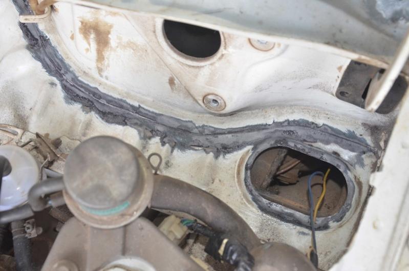

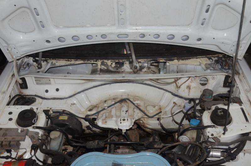

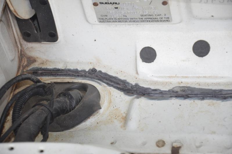

Ok, so after doing the rear tray and cab wall area I really needed to get stuck into the seam across the top of the firewall that skirts around behind the spare tyre as this was showing signs of rust:
Here is the Driver's side up close - this is the area that caught my attention in the first place, unfortunately I've only got after wire wheeling photos:
And the Passenger's side. I also found rust under the rubber grommet into the cab and to access the area the wiper motor had to be removed - pretty easy but the plastic clips are pretty US :(

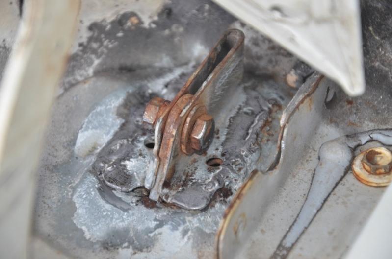

I also wired the LHS bonnet hinge and acid treated it:

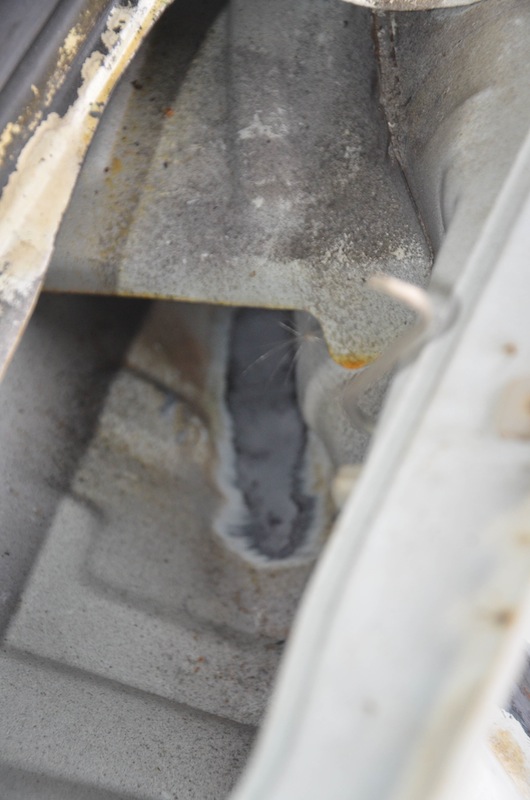

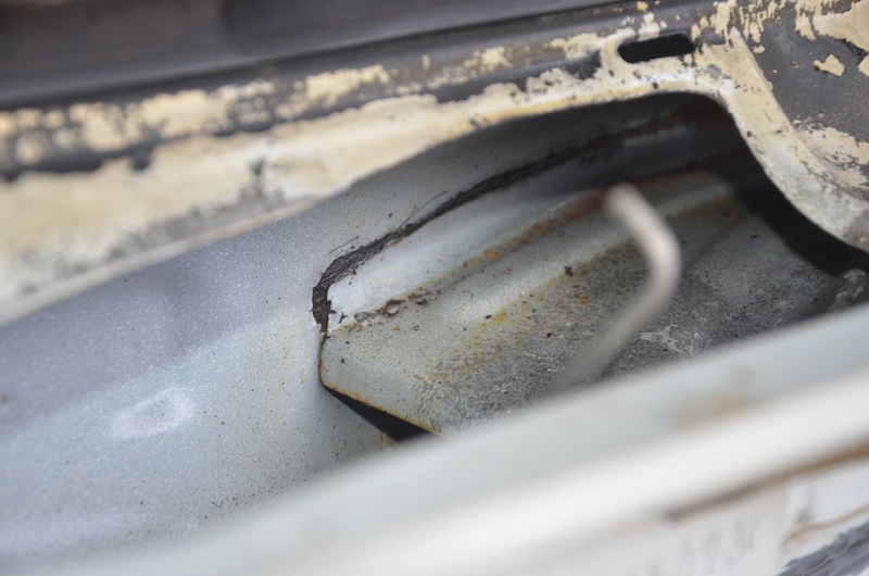

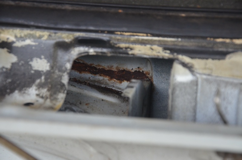

I also attended to some rust in the air vent area behind the firewall below the windscreen. It's totally out of focus but I think you get the idea of where it is - the shiny/grey area is what I've worked on - managed to get the drill with the wire wheel in there too!
Then I had some fun getting to a very rusty area that is quite amazing - it's high up above the above image, directly under the windscreen. I couldn't get the drill in there so have scraped it out with a screw driver then acid treated these areas tonight - I used an art paint brush that was long and skinny to get in there; also removing the wiper arms out of the way helps with access:
And the passenger's side:

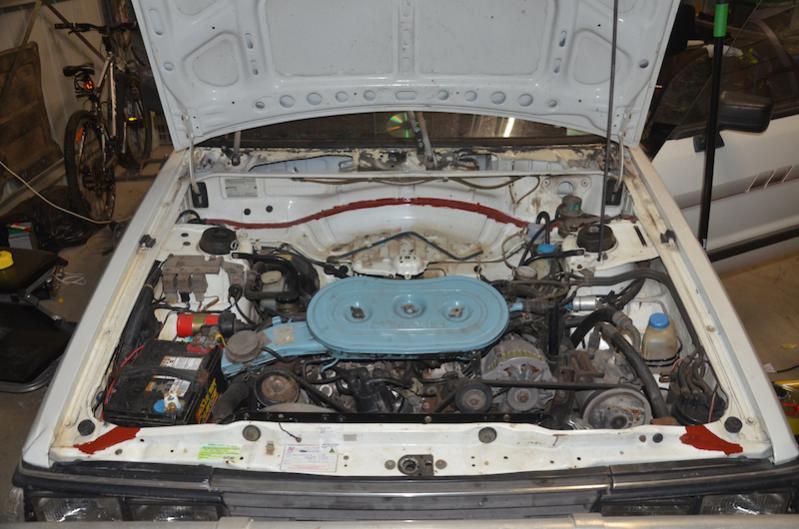

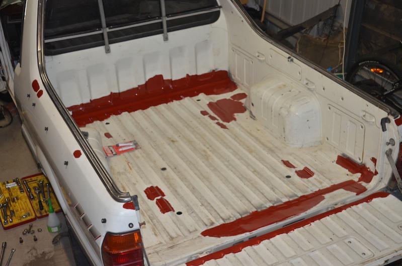

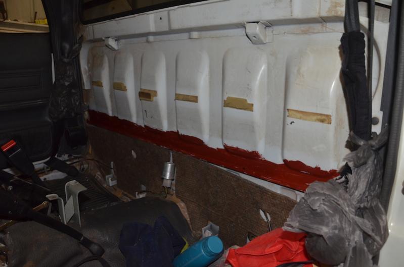

So this is what Sunnie now looks like:
It may not look like much but after wire wheeling the whole lot, sanding the edges with 240 grit, vacuuming the dust then prepping the surface with some thinners it was finally time to paint!
Long process! I've also got a patch of rust I'm dealing with on the underside of the tray directly above the tail shaft - it's a serious hole that's not gone all the way through thus far, hopefully this work will halt that from moving any further!
I also found a rust hole on the side of the rear RHS guard - rusted from inside the guard through to the tray :evil: I guess 20 something years of mud/road grime build up behind the shock mount will do this... Not happy but not much I can really do other than deal with it.
