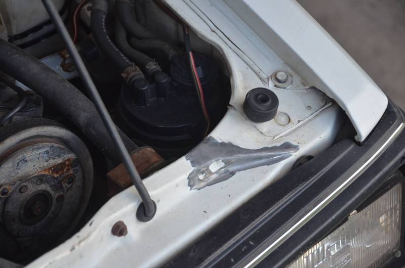

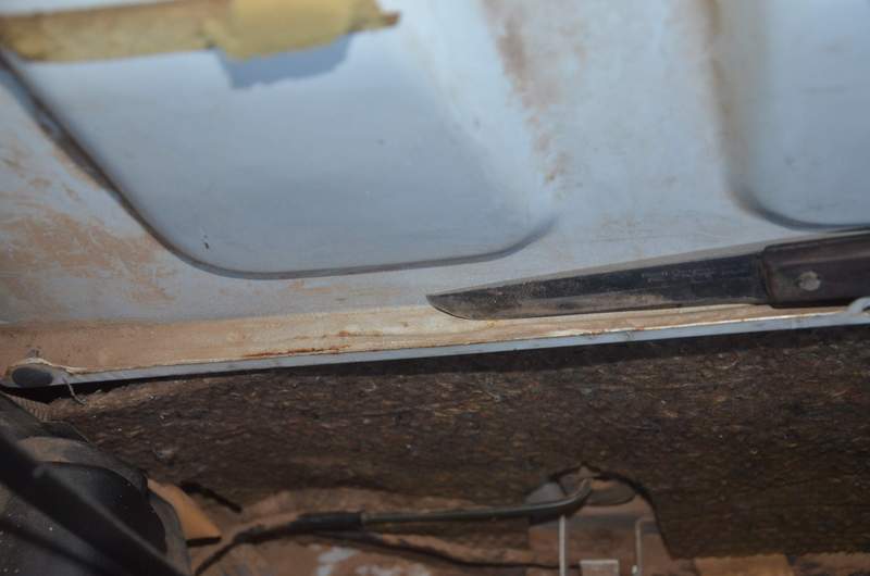

This is what I found: - Passenger's side:
Driver's side (repaired previously):

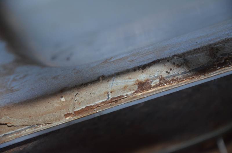

And this is primarily what's put the new seal on hold:
^ This is the upper edge of the windscreen, the old hard seal has rubbed away at the paint exposing the metal below. I need to clean this up and protect this properly before I put the new seal in. Now I'm waiting for the weather to clear up. The passenger's corner isn't as hard as there's less area to cover and I don't have to be as fussy about the paint surface around this area unlike the roof.

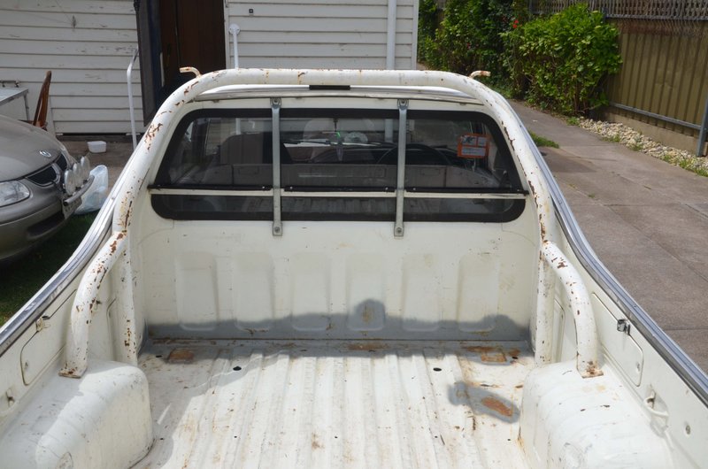

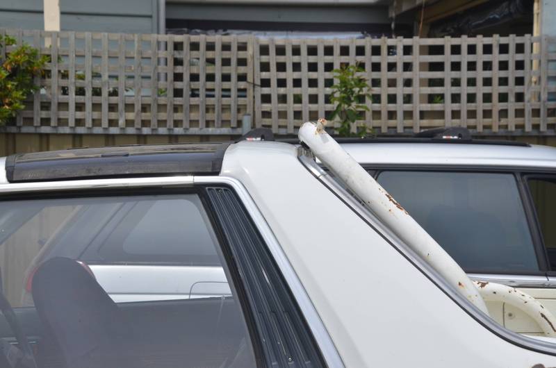

For now I'm after some tips about fitting the roll bar. My idea is to get some plates to put under the mount points to help sandwich the tray metal so the load is spread. The tips I'm after are any tricks to get it dead centre. Currently I'm going with the measure twice, drill once theory.
A rubber strip will be put under each mount point as well. This will help reduce the risk of rust through vibration and hopefully naturally correct any difference in the height of all the plates as it doesn't sit perfectly flat at all four points.

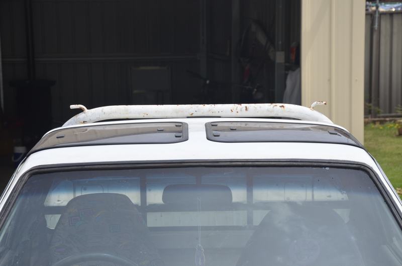

Anyway, here are some pics. We're going to sand it and paint it black, we think it would look better this colour plus it's what the true owner wants!

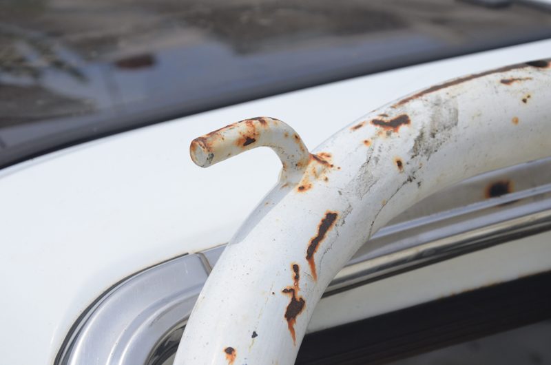

I want to change these hooks to a loop and drop them below the roof line view so you can't see them like you can in the pic above:
I should look good once it's painted etc. The first task will be to brush off this rust, acid treat it, buff off, prime, buff, prime, buff, sealer, then for the hole I'll have a crack at using this stuff:
Once all the rust has been treated, primed, sealed, double sealed and painted with a kill rust enamel white the roll bar will see some attention.
Other things to do on this beast are: Install the carpet I purchased on ebay years ago (now); Thinking of better seats, we'll see what happens there; clean up the interior as it's just dirty. I wouldn't mind doing the five speed conversion, just time and equipment I don't have up here at the moment, so will probably wait on that one.
Front and rear brakes will be seen to. Thinking of new rotors and pads up front to improve the braking response. Fresh brake fluid might be the go too.
I'll keep you posted as to what happens

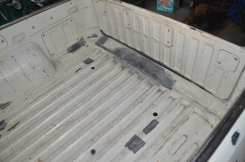

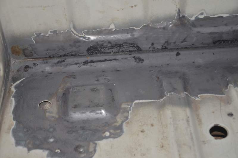

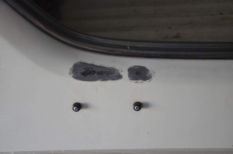

Here's what's been going on:

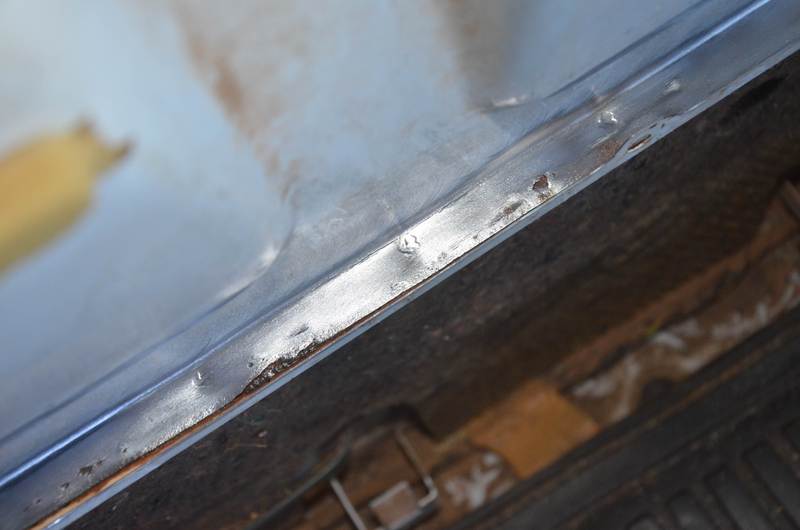

Used a flapper disc on the grinder to clean up the surface rust areas and some spots that had light rust due to loss of paint:

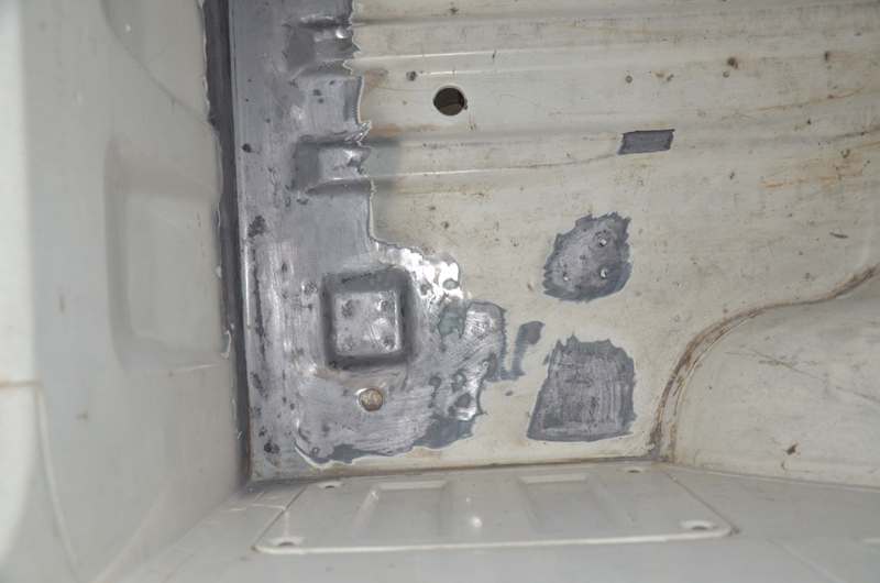

I've also attacked the rust areas that the tonneau cover has created. It's not going to look show quality when it's done but there won't be any rust in there which is what I want.
Re-doing the rust repairs from a few years ago. That didn't go so well. Learnt a lot since then (hopefully!):

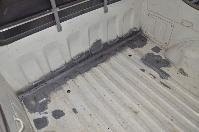

More on the rear of the tray - mainly aiming at the seam area where it seems to have taken hold, it's not serious rust but it would be one day. There's one hole in this area too:

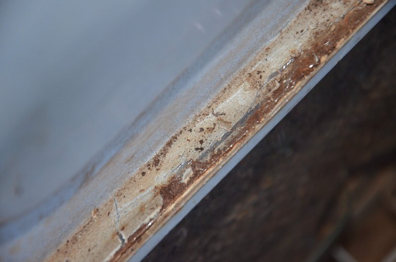

And the seam where it all began - and what I am ultimately out to resolve:
Next post (maxed out attachment limit) I talk more about this seam - I'm very glad I looked further into it!
It's going well, still need to get some paint but for now the acid can hold it up for now.

In this image you can see the areas that I've hit with the rust buster that are a dull grey, the bits I've missed are still shiny:
This is where I'm glad I looked into it further. This is the seam from in the cab. Near the knife you can see a little brown area along the seam, this is what I wanted to look into further:
With the seam sealer removed you can see more. It really is a cancer:
And a better image of that rust with the seam sealer removed:
Then I spent some time wire wheeling the whole seam area. You can really see the rust in the area now - there's even more than what I thought was there after removing the seam sealer. This was then covered with rust buster and is currently sitting there doing it's thing:
Looking forward to having all of this cleaned up during the week then applying the first coat of paint - red oxide. Then it'll be primer followed by some white kill rust.

- dsc4170rusttray.jpg (32.45 KiB) Viewed 24900 times
