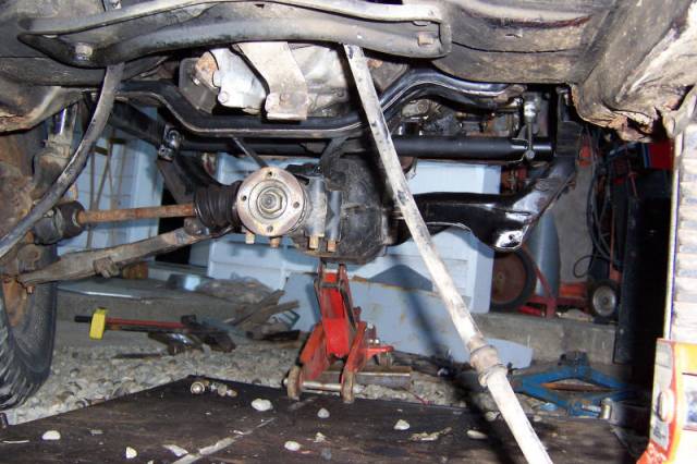

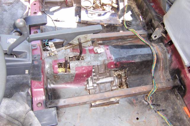

As they say a pic is worth a thousand words,well done.Looking forward to pics of em in place.As for transfer cases some early datsun/nissan ones have the same flanges as subaru
attached a couple of pics of transfer case and front diff in subaru.

Post by AndrewT » Mon Oct 13, 2008 8:32 pm
Awesome thanks for those pics, I havn't found those yet in my search. I hope I don't end up having to chop the tranny tunnel up that much.

Post by stamp_licker » Mon Oct 13, 2008 8:35 pm
That tranny tunnel was choppesd so it could be fitted with like a 2" lift.I do have more pics somewhere of different transfers in place.If i find i will post.

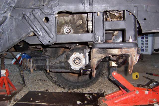

Post by AndrewT » Thu Oct 30, 2008 11:25 pm
Pics as requested;
The car is currently sitting on the back wheels with half a boot-load of crap and the entire roll of new interior carpet and heavy sound deadening I bought for the other car sitting in the back seat. The front end is up on axel stands.
Rear end view (yes I know I gotta fix the negative camber, I think I'll try the "loosen the 3 bolts" trick).
Side angle view.
Currently have 2wd GX struts and springs in, and a very crusty pair of GX brake rotors. Will naturally be replaced with new Outback struts and Kings springs and new rotors.
Passenger side, control arm not bolted up yet.

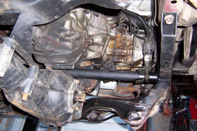

Post by AndrewT » Thu Oct 30, 2008 11:26 pm
Side view, I slapped a few bolts thru a very temporary gearbox mount (way too low) just so I don't have to use my jack to hold it all up for now.
Yes the body is quite high in relation to the motor. Can almost return to stock L series position for the spare! That's a 14" liberty rim with a new tyre on it.
Front end view.
