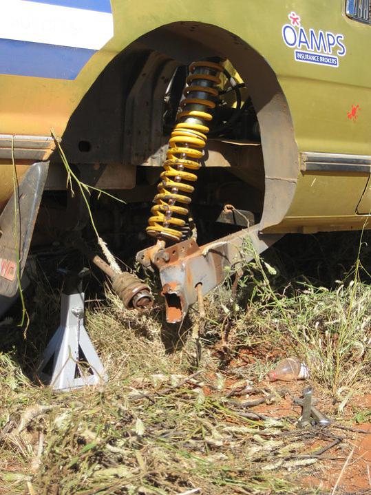

Brett has just rung, and Stuart has torn the back wheel off the car. His race is over unfortunately. Brett will update when more known.

What a bastard hey? It was the factory welds on the rear hub that failed. When it let go the wheel, hub and brakes went one way and the ute the other. It tore the cv joint apart while it was at it. We went out and recovered them about 65k's from the start line.
Ended up taking the rear swing arm off, pulled the brakes and what not off and then welded the hub back on. Put it all back together and drove the ute on to the truck and sat and watched the bikes go by while we all sat and had a bit of a sulk.
That's racing I suppose.

You can see what happened in this pic. Plans are already made for more strength for Gundy in October.

what a bugger hay. its far better to fix to steel then bones, and quicker to.
and we all know how good Stuart is with a grinder and a welder.
Just glad that Stuart and jim are ok.
Rik.
Posts: 12707
Post by El_Freddo » Mon Jun 14, 2010 10:08 pm
Bloody hell! Glad stuart's ok - I bet that gave him a fright! Looks like anything that's factory needs a going over! Probabily why vehicles that are built for the dakar don't look anything like their factory counterparts...
All the best with the rebuild!

the need for chromoly all round......
what gave way first??
