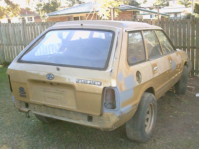

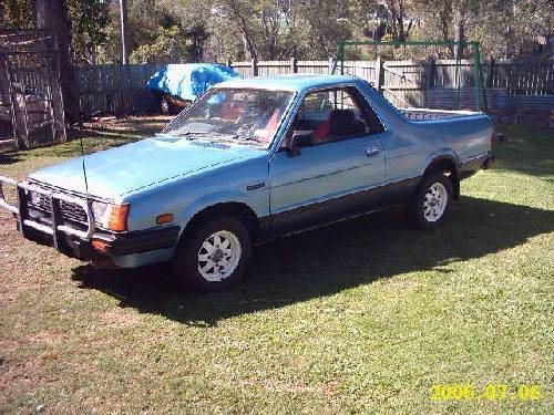

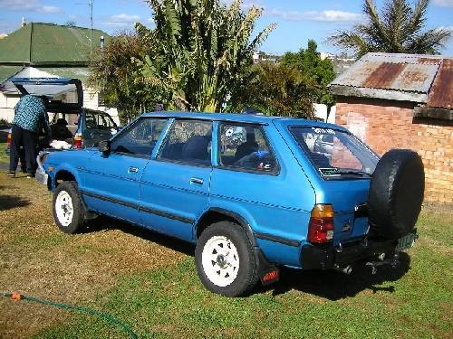

Just a couple of pics of the progress of my Subie. I've only just got into these cars for myself, but have been working on and fabricating parts for them for a few years now. Decided to do a serious "remanufactured" custom job for myself. This one already had power steering, air conditioning, digital dash, electric windows, auto box and a pretty good body.
The body had hidden faults though, so I've cut all rusted sections open and have been fabricating entirely new sections in order to return the body to new condition (with more rust proofing though).
What I'm adding is, central locking, keyless entry, full 6 stud conversion with ventilated discs and 14x7" wheels, full rubber flares, modified front fenders, Pacific Turquoise metallic paint, cruise control, custom made muffler with WRX style exhaust note (already tested prototype on friend's Subie), sill guards/side steps, small built in fridge, DVD/digital TV (mobile set top box) with roof mounted 7" screen, MP3 stereo (no CD to skip), custom front and rear bumpers with towbar (3 different elec sockets installed) and front pushbar (with offset towball for manouvering my caravan), and a few other little extras.
There'll be more info and pics to follow.

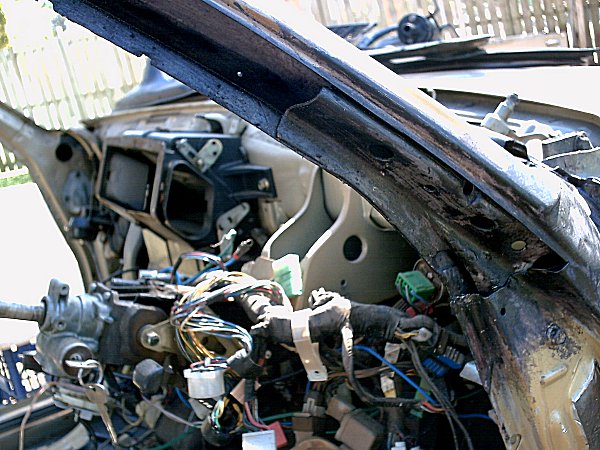

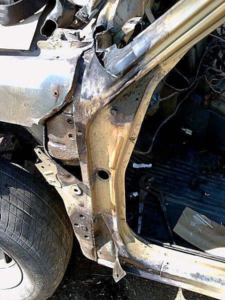

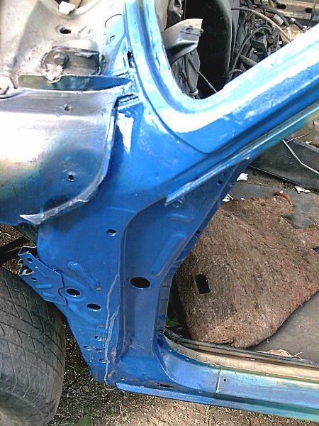

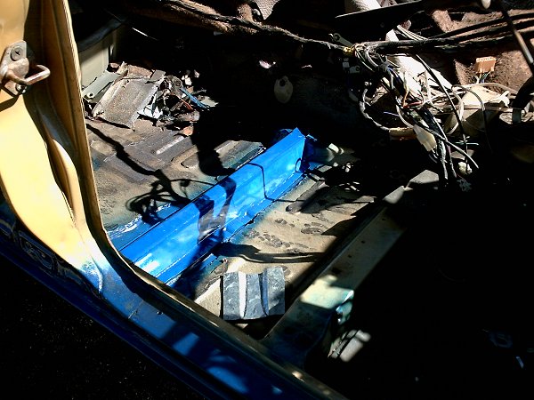

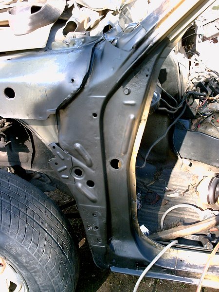

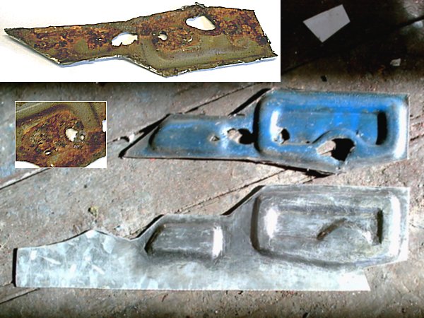

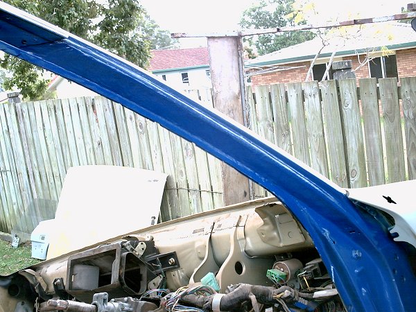

Ok, time for some progress pics on the work I've been doing on this car. There was not much rust evident, and most of it was only small holes that would normally get treated and filled, but I decided I'm only doing this resto once, so all suspect areas are completely cut open, all signs of rust removed, then new sections made up and fully welded in. This car will be going on the road with a completely renewed body and framing.
Oh, the outside front seat mountings leave a bit to be desired in this model, so I've fabricated a full "tophat" member that replaces that mounting and joins the sill to the tunnel. This will make the front seats very solid and stop any deterioration of the floor in the future, as the weight bared on the seat is supported entirely by the framing instead of the floor.

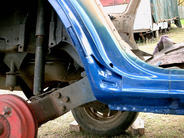

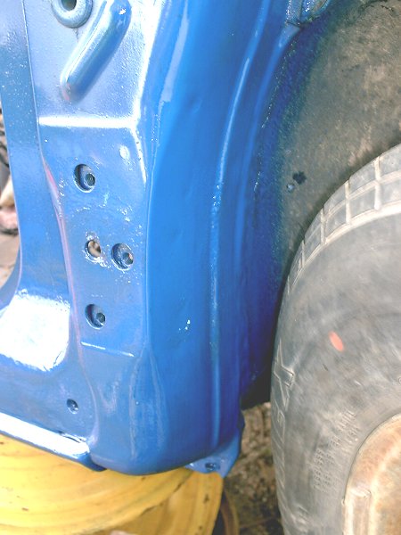

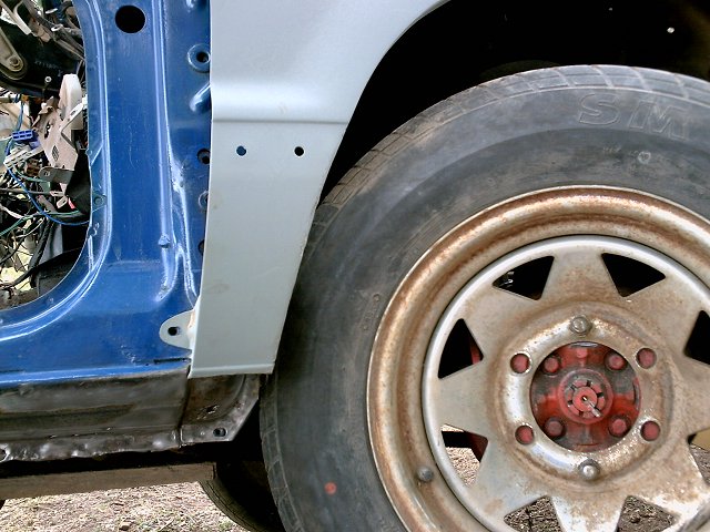

It's getting painted Pacific Turquoise, which is the Holden Statesman equivalent of Mopar Everglade Green (a Dodge Charger colour). Very similar to a genuine Subie colour, but didn't want the generic shade.
As for the rust repairs, they are far more extensive than what you'd normally do. Usually you'd have someone tack a few bits into the bigger problems and bog them over so you've got a nice paint finish. But the paint is only really there to protect what's underneath, which should all be original steel. To get someone else to do the work (or for someone else to get me to do it) would set you back in the vicinity of $5000, just for the steel work. Then there's the stripping, prepping and painting, reassembly and mechanicals to fork out for too. Good thing for me I'm a professional and don't have to pay myself the $60 an hour (until I send myself the bill).
Because I can, I've engineered a few modifications with this car. The beam under the back of the front seats will make everything very solid and allows for increased crash protection (will still crumple, but will offer more room inside if hit). The front wheel arches were an issue with clearance, due to the bigger wheels and tires, since I'm using 14x7 inch with a wide offset and 235x65 tires. So I sliced a layer out of the footwell/pillar pinchweld and turned it 90 degrees then seam welded it from the inside.
She's only been slowed down over the last week because of continuous rain and flooding here. Back on to it again tomorrow though... The body should be ready for painting in the next couple of days.
Oh, and the last pic is a sister car to mine that we're doing in the same yard at the same time. it's about to get a final coat, then it's just reassembly, apart from the molded steel rear bumper I'm fabricating for it.

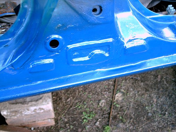

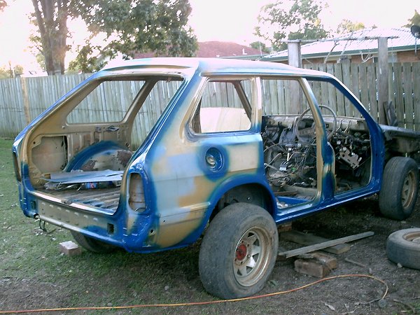

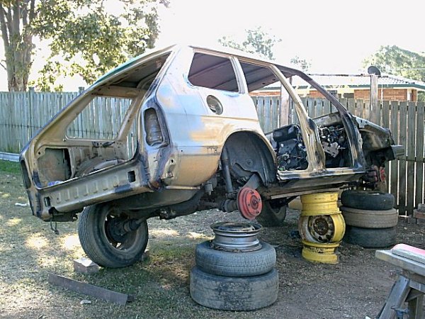

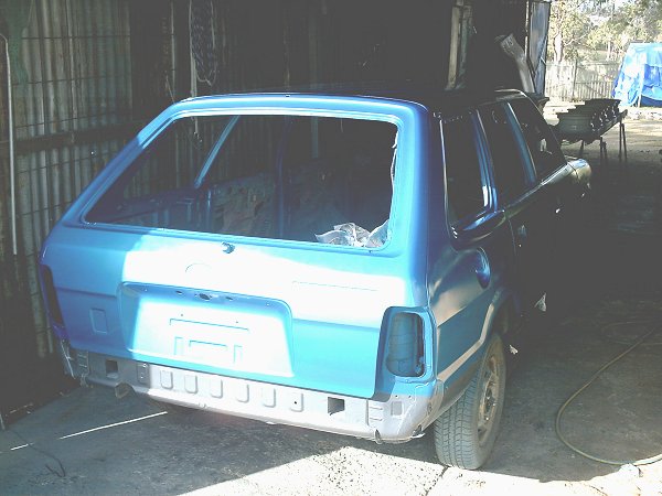

The car is back on it's wheels, until i jack the other side up for some minor attention tomorrow. All the blue areas are bits that have been stripped and repaired. There's no filler under any of the blue paint, it's plain treated steel, grinding marks and all...

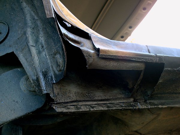

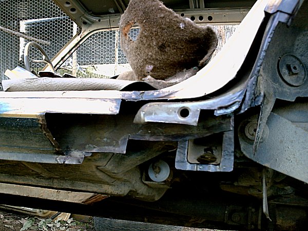

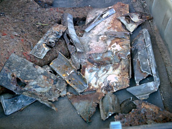

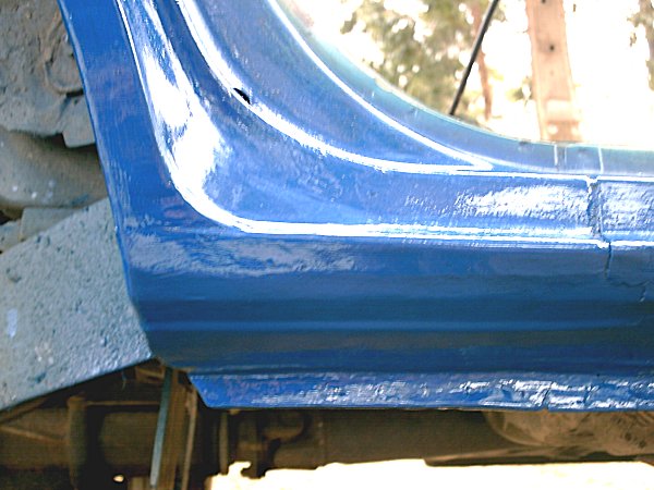

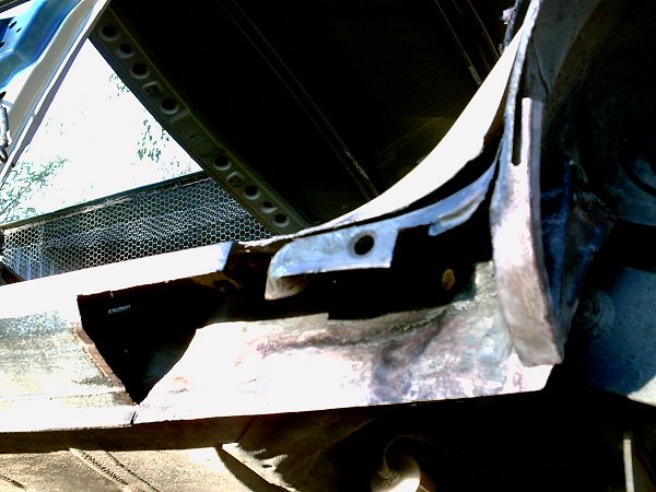

And here's the latest rusty bits I've been fixing up. First pic is all the bits i cut out of the left sill at the rear. Then is the vacant area where there used to be what appeared to be "car". Now I've started welding in the new bits to replace the other bits that were only bonded in with bog. The original skin isn't too bad, so it'll be cleaned up and welded back in tomorrow.
The outside of this area looked good, as it had been cut out and a new piece seam welded in some time ago. But under that neat job was just a mess of tin and bog, held together with luck. Whoever did the repair knew what they were doing, but were very devious and morally corrupt. This section needs to be strong enough to take a hit and hopefully protect the children in the back seat.

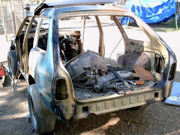

Thanks to the recent constant rain and flooding here, I've had to miss out on working on the car, but back into it again now. It's not far from paint and finishing off. We're about to put it right up on it's side tomorrow so we can fill all the seams and gaps under the car (with goop, which is a special technical name for brushable body deadener) before fully spraying the underside with proofcoat and a bit of good old black gloss...
Meanwhile, here's a couple of pics of one of the last bits of fabricating/welding...
