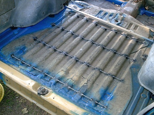

Here is the last bit of welding I did on it. It's the load space in the back, where I added tiedown points over the entire floor, including 6 loops around the perimeter that will poke through the carpet. When carting dirty or heavy stuff, the carpet simply rolls up and stores on the floor in front of the back seat, exposing the thickly tarred surface of the floor and the extra tie down points, allowing anything to be laced to the floor to stop it from moving around and doing damage to the car or the object. Afterwards, the carpet goes back in place and everything's clean and undamaged.

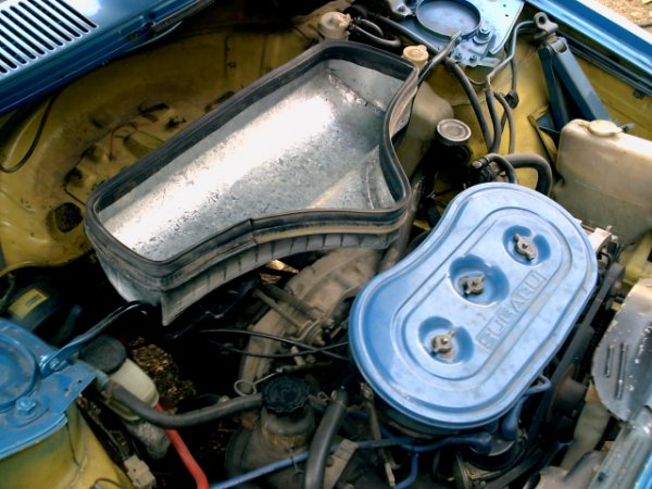

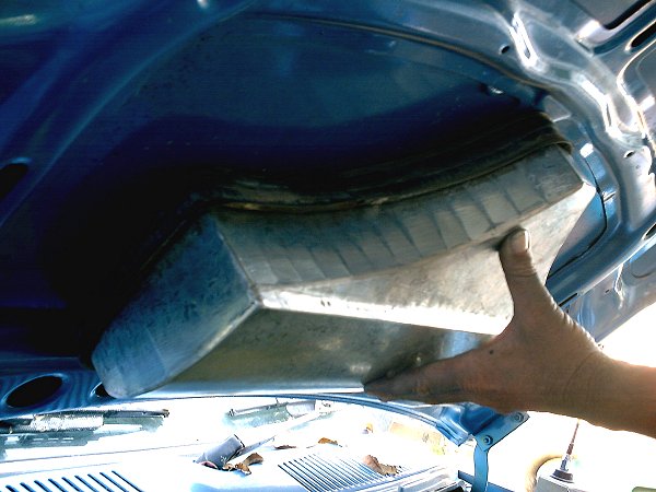

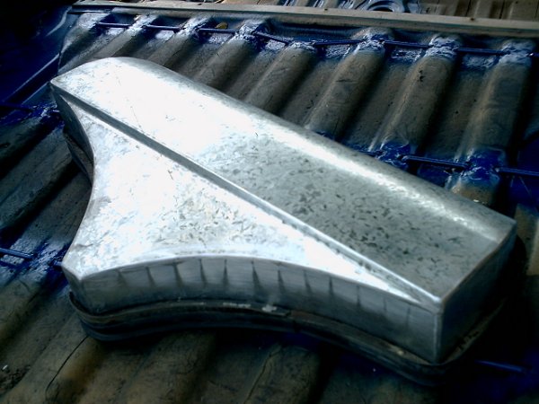

This is the simple box he wanted me to whip up, to duct air from the WRX scoop to the air cleaner. I couldn't help but design it with consideration for flow dynamics and water extraction...
The duct is made from 0.9mm gal steel sheet, with all seams fully soldered. It needs finishing yet...
