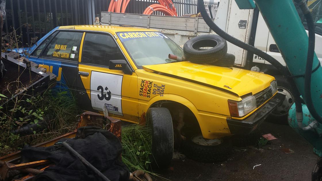

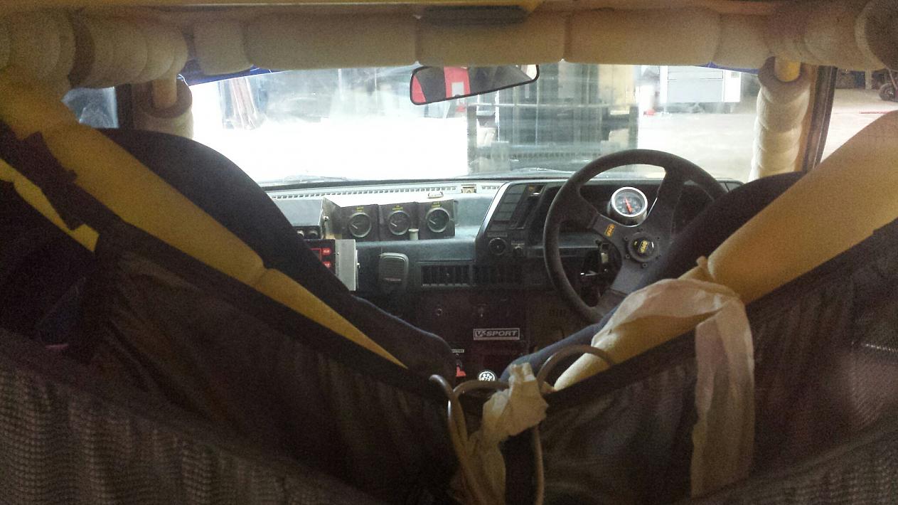

hey guys!
So I've acquired an 85 Subaru Leone rally car!!
It is very clean and straight with all the right gear in it!!!
However it has been sitting around for the past 4 or so years due to a blown head gasket/cracked heads and an unwilling owner.
When I got the car it was almost a rolling shell, the engine had been stripped and put on a pallet with the rest of the parts put in a tub that sat outside for the duration of its mid life crisis. there are cars in the ocean that have more hope of running again over this ea82t.
Going off the cams log book I found stashed under the seat in a puddle of muddy water, this is the 5th EA82T that has graced this former champion of a car.
So its time for number SIX
The basic plan so far:
  • source new EA82T
  • full strip down and rebuild
  • slightly bigger turbo and custom headers
  • tmic or waic
  • oil cooler
  • small cancer removal in the front cowl panel
I will upload some pictures when I get the chance.

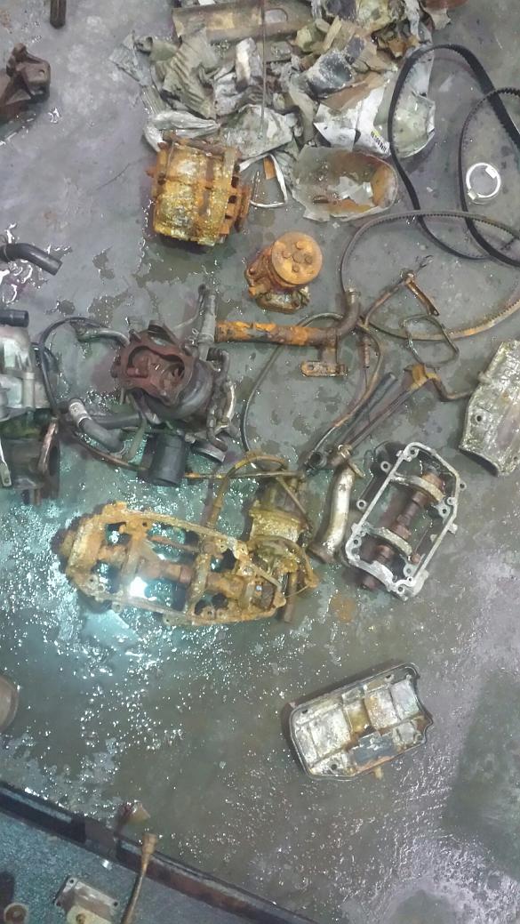

turbos are seized, the cams need to be reground, block needs to be bored to remove the rust (probably too deep for just a hone), heads are missing, timming belt pullies are destroyed in rust along with the distributor and the headers are rusted through (hence customer headers)....
The only part worth keeping is inlet and everything attached like piping etc.
All in all its going to be cheaper reconditioning a running engine than it is to replace and machine all the parts i have....
