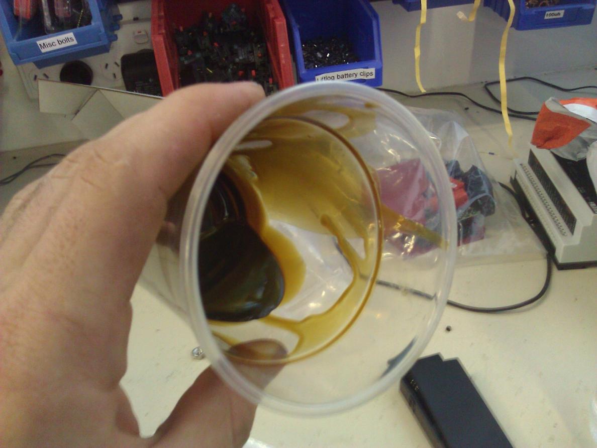

Off topic, just did a service on the shop compressor, poor bloody thing rarely gets any attention and is used near on every day. both laser cutter and csm84 need air.
This is what the oil that came out of it looked like,
Not only is it about an 1/8th of whats meant to come out, but its severely broken down and is thick as syrip. The compressor got so hot everything plastic on it has melted and fallen off. So a word of warning, DONT DO THIS TO YOUR CAR!
