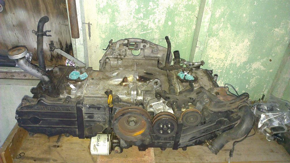

Hi everyone,
With the wreck that I bought a few months ago I acquired another ea82 that I plan to rebuild. It has 200k on the clock as opposed to the 330k on my current L Series. After a bit of thought and a lot of reading I have decided to do a mild rebuild: pistons rings, head gaskets and resurfaced heads, new timing belt, gaskets, seals etc.
Here she is: [ATTACH]3815[/ATTACH]
I'm not really after more performance but more so longevity. The body on my L is in pretty good nick and I'd like to have a strong motor sittin under the hood to see her through.
Before I get started however I wanted to post up my plan (see below) for people to comment on. Does this sound like I am on the right track? This will be my first rebuild so any advice will be greatly appreciated!

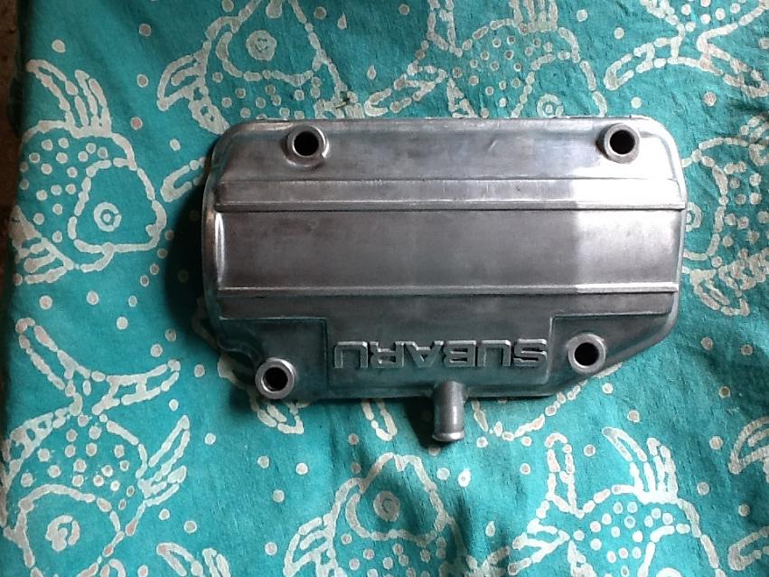

- image.jpg (121.64 KiB) Viewed 10638 times
First, I'll say I'm half way through my first rebuild so I'm not an expert - so take that into mind.
You will need to remove the flywell and the bell/flywheel housing to get to the rear gudgeon pins.
Your plan looks alright to me in. I'm not 100% but I think there might be an O-ring in the oil passage between the head and camshaft housing on each side. Could be wrong. It's been a while in my defence.
What are you going to pressure clean with? Water - you won't make much of a dint in the crap on your block imo. I sand blasted my block and it came up nice. But if you aren't going to split the block I would get a wire brush insert for an electric drill and spray a bottle of carb cleaner on the block and heads and scrub it with the wire brush. I had a bit of a go at doing this is it comes up as a very (surprisingly) shiny, clean finish but I wasn't sure about the longevity of it so I finished it off with glass bead.jims wrote:Pressure clean block.
Yes, you have to remove the pistons before you split the block if you were going to. They can be quite hard to get out (depending on age, condition of motor - they are supposed to slide out easily)- most people use a screw driver but I had no luck there. I ended up making a tool out of two M8x140 bolts - grounded down the head with a grinder stuck them together with a bit of metal on the outer one to make a slide hammer - which is what the Subaru tool is that is no longer available. I can show you some pictures if you need help. It was so much easier then the screwdriver method.jims wrote:Remove pistons (can i do this without splitting the block?) and measure piston bores. If within specs hone and install new piston rings all round. If outside of acceptable specs get them rebored and buy over sized pistons.
Personally, I'd just get a new pump for the simplicity of swapping them over. But I did have a set of O-rings for the EA82 pump somewhere here - if you want them - you can have them. My EA82 was toast before i got around to it.jims wrote:Disassemble oil pump, clean and inspect. Renew all oil pump gaskets .
Replace oil seal in flywheel housing and possible seal at the crankshaft front end.
I would probably get a complete kit with idler pulleys and new tensioners. Only risk not doing it is breaking the belts before they are due which will bring you to a sudden holt but cause no damage. Just depends on your budget - If it were me and I had the engine out on a bench I'd use the opportunity to do it.jims wrote:Timing belt
200,000km ? Sort of think there is no reason to rebuild it - other than for reliability as you have said. I say go genuine gaskets and seals - from experience.
Done a few with geniune gaskets now and they have never needed a retension after warm up - makes it worth the extra paid.
As for cleaning your block - even before you take anything more off scrub it with scouring sponges, wax and grease remover is good for greasy stuff. I bought a heap of little brushes from Honkers to fit my dremel like rotary tool and got stuck into it as well as drill wire brushes - nearly got th autosol out too
Yep there is a little O ring as Ron says - all available from Subaru / FROG

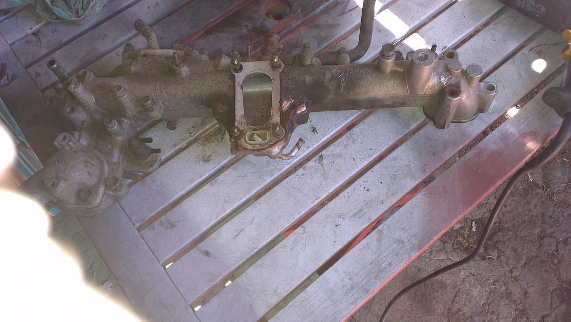

I had a few spare hours this afternoon so I began work on the engine. I attacked the intake manifold with some degreaser, a toothbrush and wire brush and cleaned it up pretty good.
Before: [ATTACH]3816[/ATTACH]

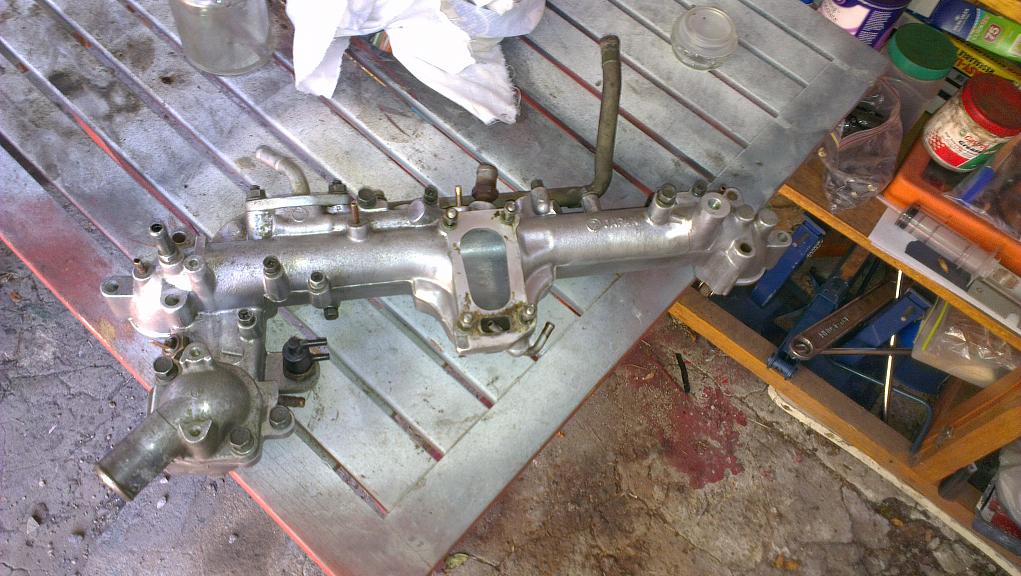

After:
Next I removed the timing covers and timing belt, cam pulleys, tensioner pulleys, idler and crank pulleys.
After:

ah, remonds me - all the hoses and pipes for pollution control will need a good internal clean so no crud enters your fresh rebuild. The breathers at top of rocker covers can be choke packed with crud. PCV valve in the manifold too and blow clean all the vac lines. Made a good start and sense to do inlet manifold. Dunno how many engine swaps people pay for and get a dirty old inlet tract !

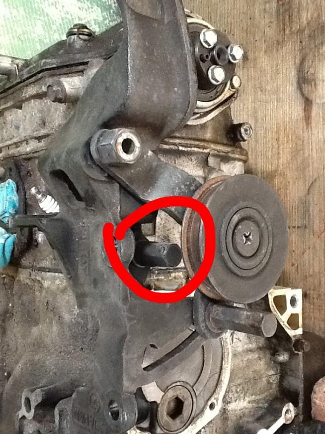

My next question is, how do I remove the alternator bracket from the passengers side of the engine?
I have removed all the bolts so that now the only place it seems to be connected to the engine is by that hexagonal shaft (inside red circle in pic) that seems to be bolted into the side of the camshaft casing.
[ATTACH]3821[/ATTACH]
Does this shaft unscrew? Have I missed something?

must do, those long nuts have long threads, and watch for a spacer ring to drop off from behind, then get some help to lift it off - bout as heavy as an old V8 cast iron intake manifold
