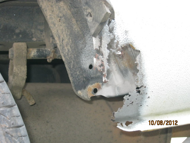

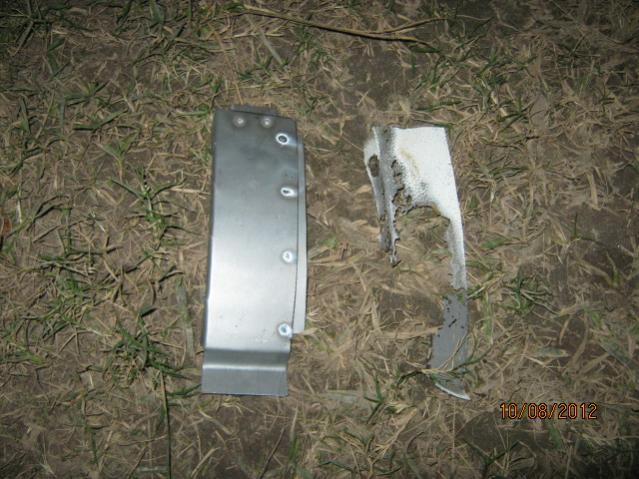

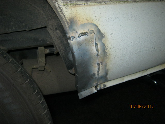

First repair rear quarter.
Post by TOONGA » Fri Aug 10, 2012 6:11 pm
Is that the left rear area where the mudflap should be?
good luck with the fabrication, lots of metal shaping and welding to come.

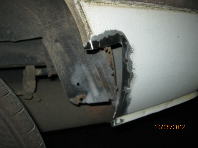

Post by revmax » Fri Aug 10, 2012 6:15 pm
yep.
too late to grind and blend it, cause it is dark outside now.

Fantastic! Looking forward to seeing more of this kind of work, since I'll be doing something similar. Questions: What thickness steel are you using? MIG welding it? what current do you go down to for this thin steel?

Post by revmax » Fri Aug 10, 2012 7:48 pm
SB The steel sheet, I think is called zincalume is 1mm thick.
Gassless mig has 6 power settings, for this stuff set on 1 and adjust wire feed to suit.
on 1 it is too powerfull to do a constant run so I just pull the trigger for a second wait another second, kinda pulsing the weld, once ya get going it can work well.
I am only doing a rough job to be structualy sound for reregistering it some time soon.

Yeah the white powdery stuff gives the zinc away ;) I've heard pulsing the welder is better for panels rather than running a continuous pool, less heat/distortion etc.

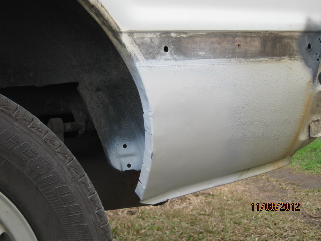

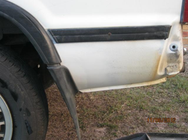

If ya have a look at the piece I welded in you can see on the edges I put a backing plate on the edges to take some of the weld.
OK jobs done.

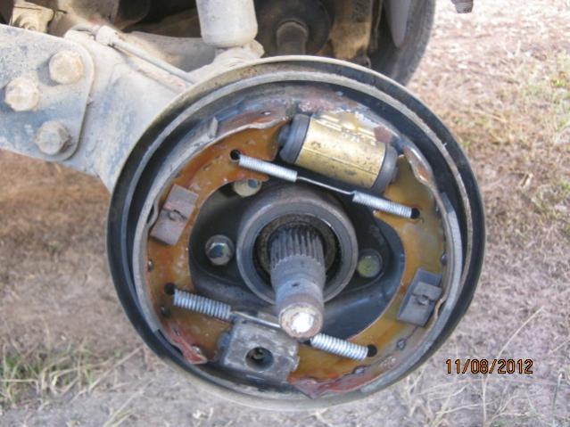

Had a look at and adjusted the rear drum on this side as i had to take the wheel off to drill new holes for the mud flap.
OH the white is just saturn white from a pressure pack
Post by TOONGA » Sat Aug 11, 2012 6:24 pm
very nice and those rear brakes look brand new.

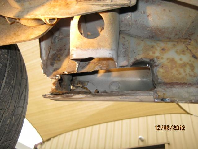

done heaps of repairs today but forgot to take a lot of photos.

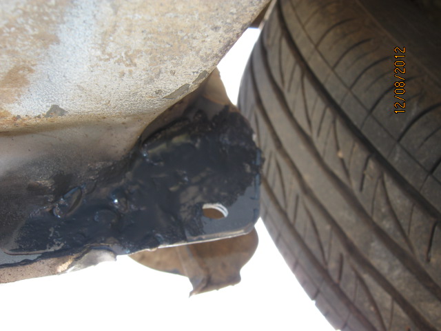

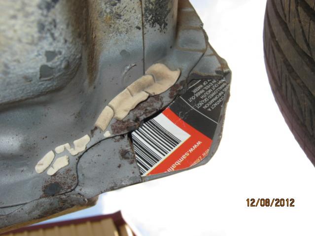

This one was blasted last week.
Cardboard template made.
Steel cut welded in place, dillberrys ground off, smear some seam sealer around and drill the hole.

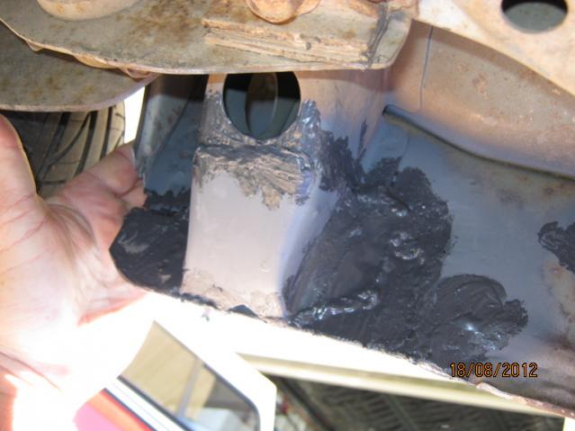

Post by revmax » Sun Aug 12, 2012 6:06 pm

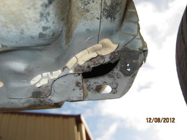

AHHH remember this one.

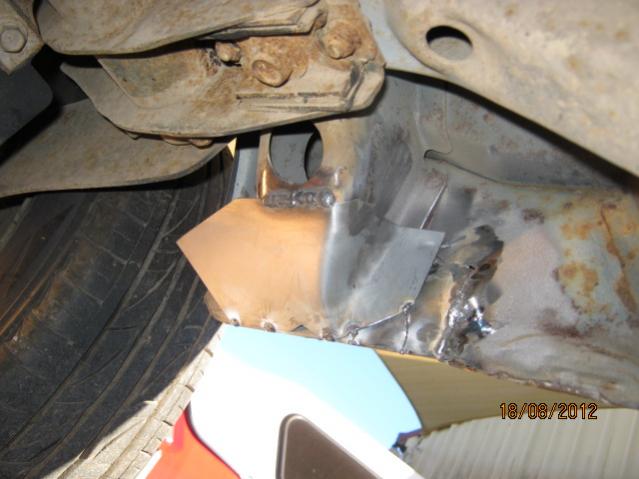

Managed to cut the rust out with a 5" makita angle grinder, it is 5" but has a 4" motor which makes it ideal for getting into tight spots. The cutting wheel was one of them 1mm thick ones.
Got the metal stiched in but ran out of wire, the welds were a bit like duck poo and I am thinking I should have used my shorter 15A extension lead that I used earlier in the day.

Post by revmax » Sat Aug 18, 2012 12:39 pm
ah that side is almost done
used a broom handle shaped to bend the sheet onto place then used a pneumatic chisel with the end ground down to a ball to peen the metal into the corner.
