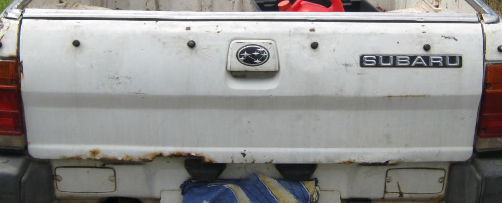

This one is realy rusty along the bottom and has some dints I had previously thought this one unreparable because of the rust, but I have an idea.

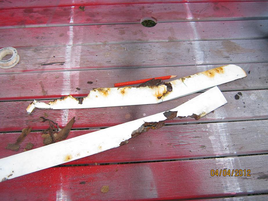

cut the rusty bit off along the bend.

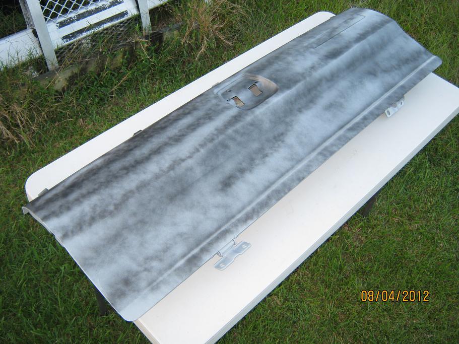

Blast all remaining rust and prime bare metal.

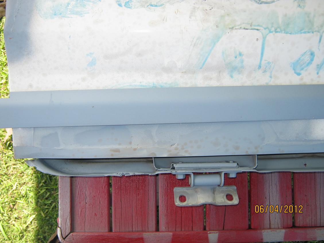

in this same photo you can see the strip I will use to replace the bottom strip.
it is 2mm steel sheet 50mm wide with a bend 25deg 15mm in from one side.
You can just see one end of the strip a knotch I cut in to locate the ends and the bent bit will tuck under the outer sheet.

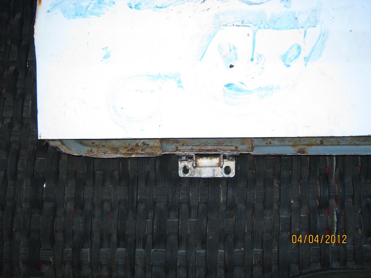

One side of the gate has had a heap of bog applied so I had to grind this out to get to the metal sheet , not visible but it is on this left side of the gate.

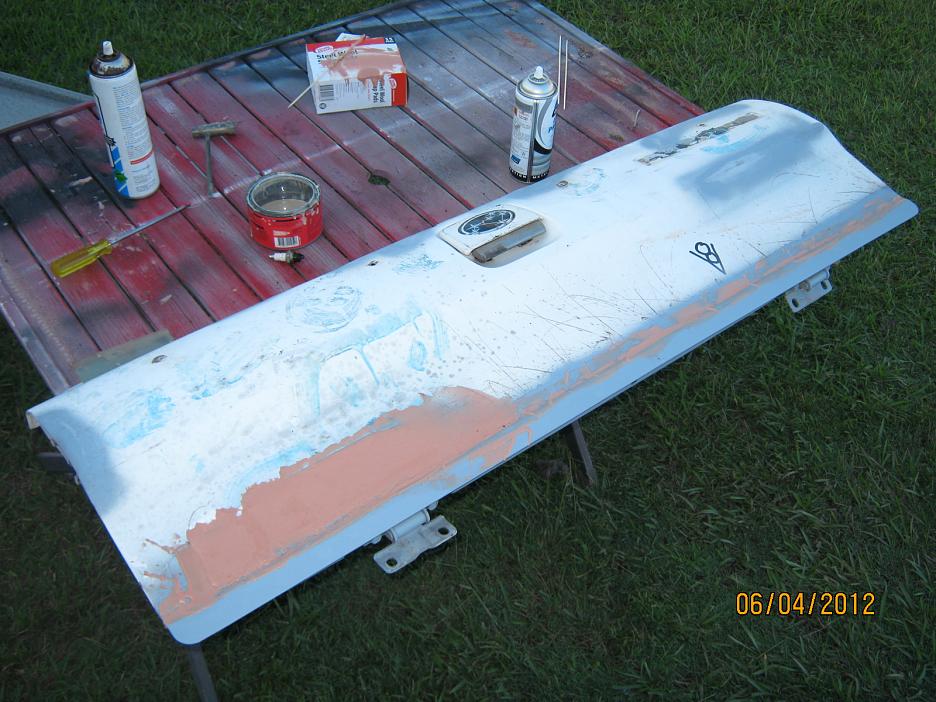

Metal stich welded into place ends trimmed and radiuses ground on corners and body filler applied. Ready for rubbing back tomorrow
