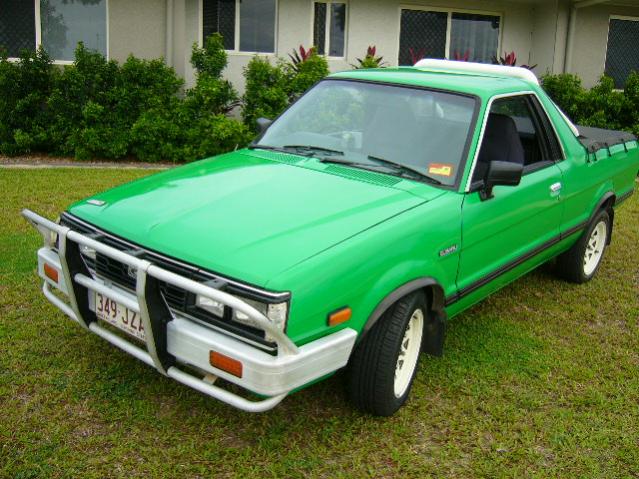

Very tidy Rowdy and great colour...where bouts are you???

Post by Rowdy555 » Tue Apr 03, 2012 8:37 pm
G'day mate I'm in the Townsville area

Post by El_Freddo » Tue Apr 03, 2012 8:57 pm
What style mags are you using there? They look a bit different from what I can see in that photo!

El Freddo: The rims are standard sunraysia
