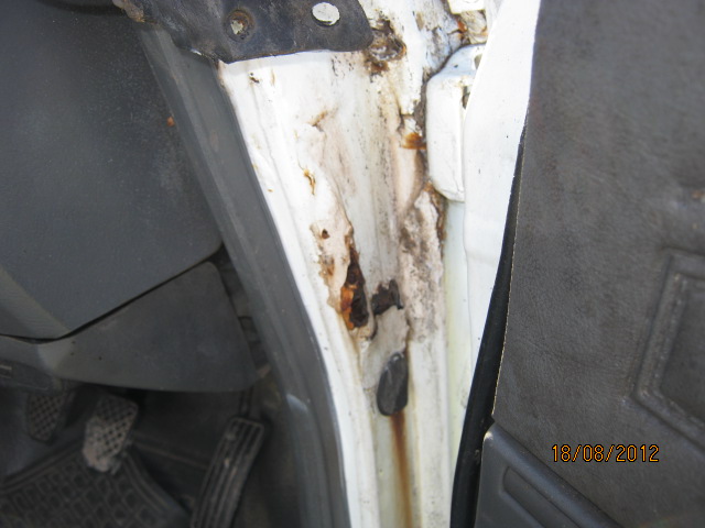

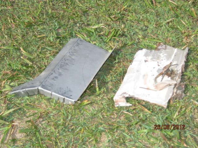

out with the grinder and some fresh metal.
- IMG_1418.jpg (71.72 KiB) Viewed 6126 times
- IMG_1416.jpg (36.27 KiB) Viewed 6126 times

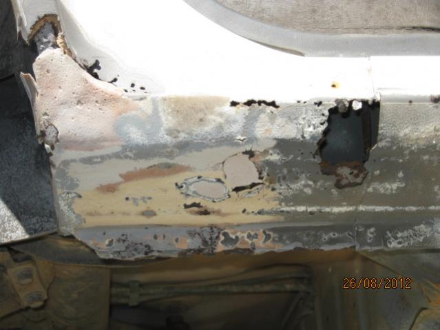

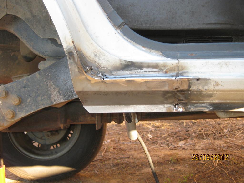

in front of the rear wheel drivers side.
- IMG_1419.jpg (37.32 KiB) Viewed 6124 times

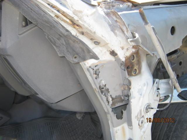

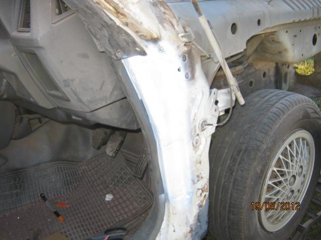

from the other day.
before blasting
after blasting
plate welded over and painted.
before blasting
after blasting

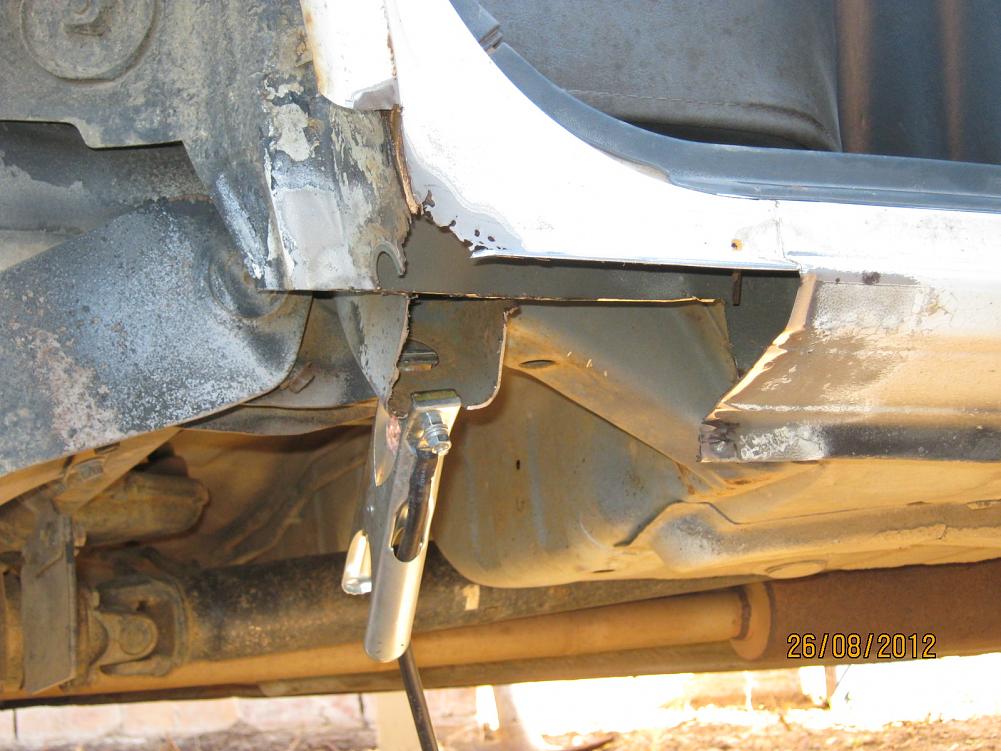

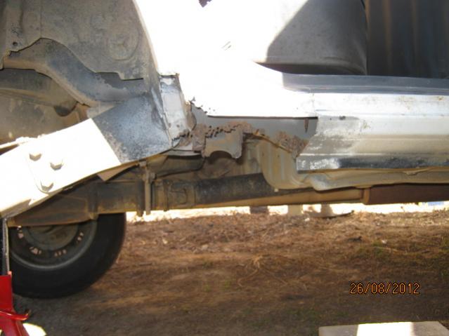

found me camera.
from the outside
still to weld a piece on the inside
from the outside
- IMG_1430.jpg (101.63 KiB) Viewed 5758 times
- IMG_1432.jpg (97.05 KiB) Viewed 5760 times
yer. I have welded the inside in but it was tricky to line up.
Once lined up it was point, pull the trigger, weave then stop for a few seconds, then start the cycle again. Got it in and it is structualy sound but the high spots had to be ground off the welds.
Have made a template and cut the sheet for the channell support and may get a chance tomorrow to weld and bend it into shape.
