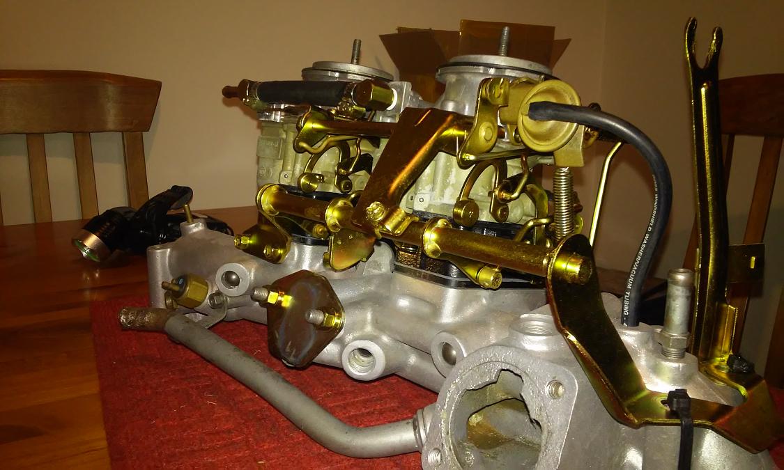

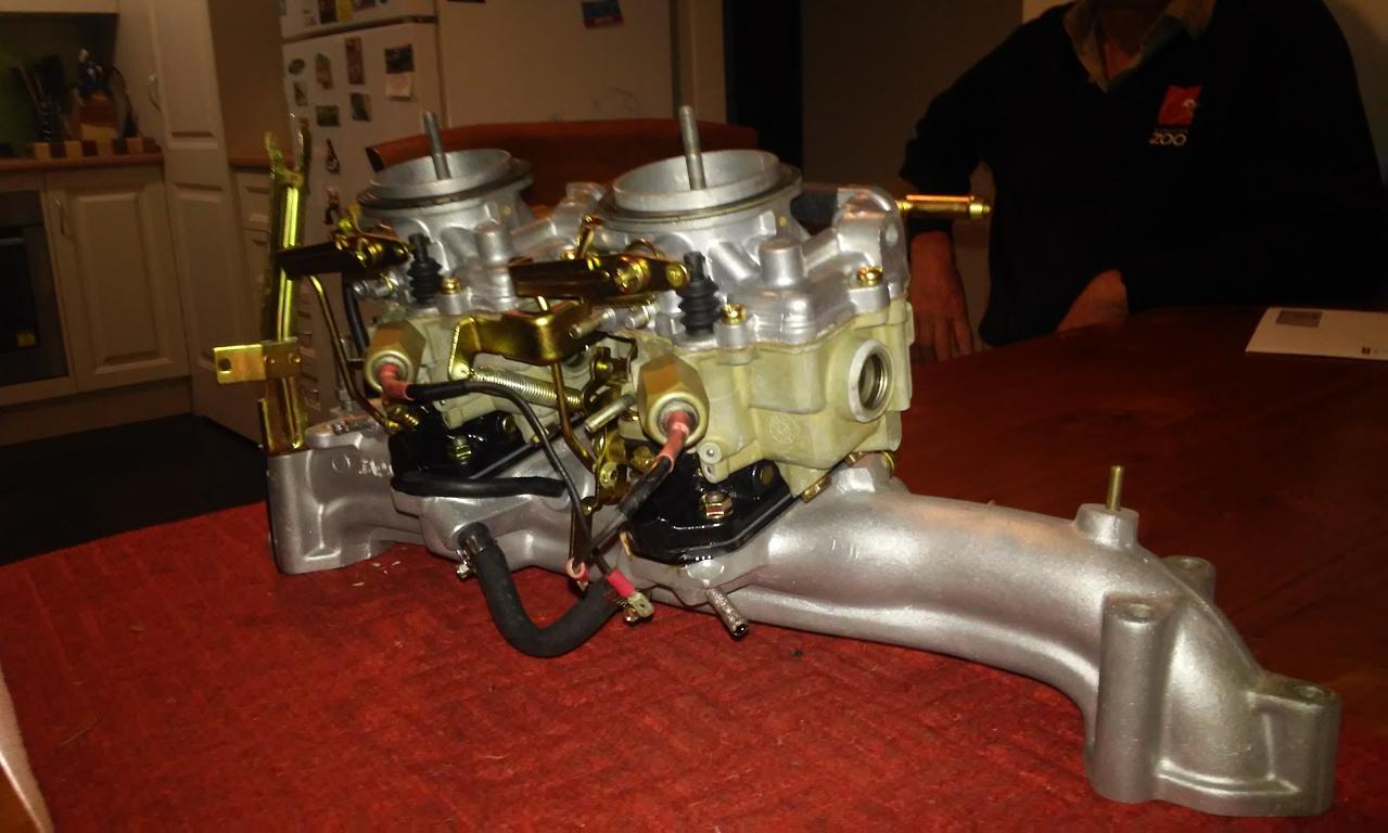

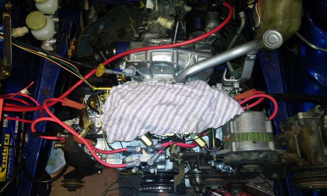

On the way home from work today I dropped by the carbie place, they've been taking so long so I was planning to put my annoyed face on. Soon as I saw them though, all was forgiven, couldn't stay mad, the guy was instantly my best mate :o
Here's a little teaser pic of what is to come, I will be picking them up tomorrow and hopefully install this weekend.

Post by Silverbullet » Thu Apr 21, 2016 7:27 pm
El_Freddo wrote:So with your wagon, once complete and better than show room spec - do you reckon you'll ever drive it due to fear of getting it dirty?
Yes, yes, a million times yes :) I'm not building this car to be a show pony, she will be my daily driver. Just making sure it will be a comfortable car with all the mod cons, and look like new as well ;) Everyone loves twins :p
I am totally chuffed, they don't look like my carbs anymore :) I handed the carbie guy a box of parts, 2 carbies and an intake manifold. He's gone above and beyond to re-assemble everything back on the manifold and done a fantastic job of it, considering he's never seen Subaru twin carbs before. Tells me he had to search around for pics of how they should look so he knew what goes where.

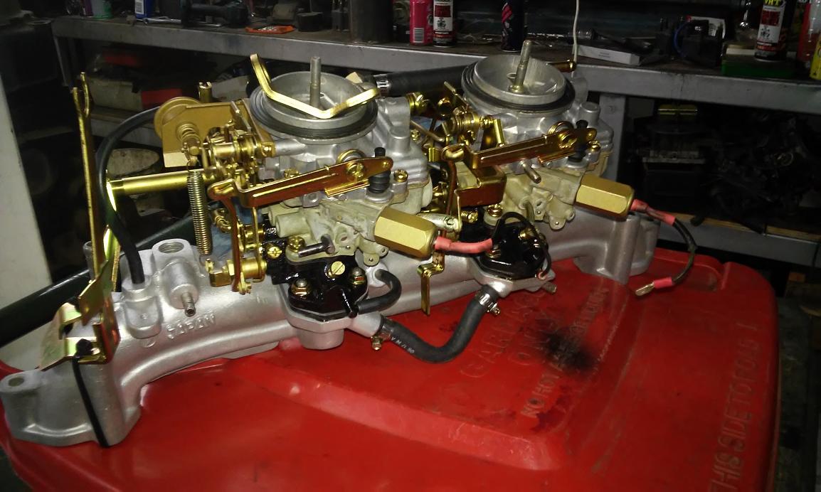

coulda send you a few pics of back-together twins if he needed. Old habits die hard Sam - is that a nut I see sitting down the open intake port :evil:
Post by Silverbullet » Fri Apr 22, 2016 10:05 pm
steptoe wrote:coulda send you a few pics of back-together twins if he needed. Old habits die hard Sam - is that a nut I see sitting down the open intake port :evil:

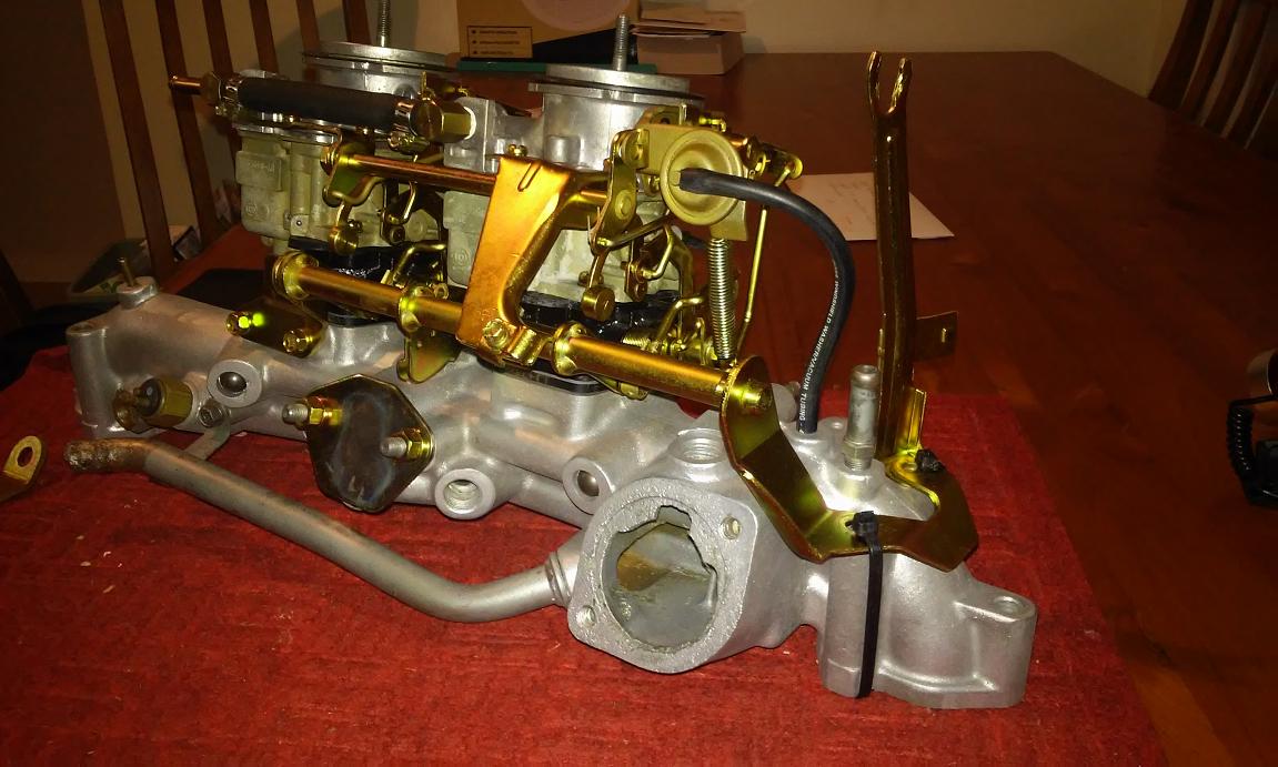

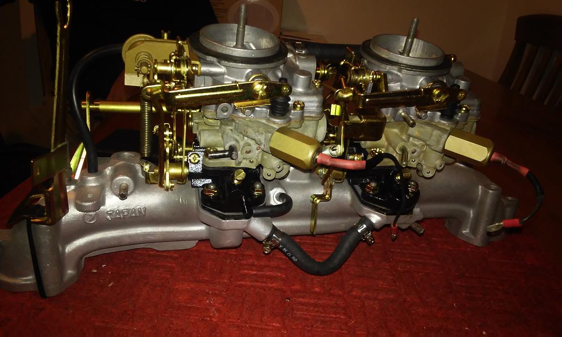

Not a nut, but an extraneous steel bracket which I included in the box of parts for rebuilding, I thought it was a support for one end of the throttle shaft but it seems not, so I dunno what it's for :rolleyes: But it's all nice and shiny gold zinc now. Don't worry, no chance of it falling anywhere dangerous.

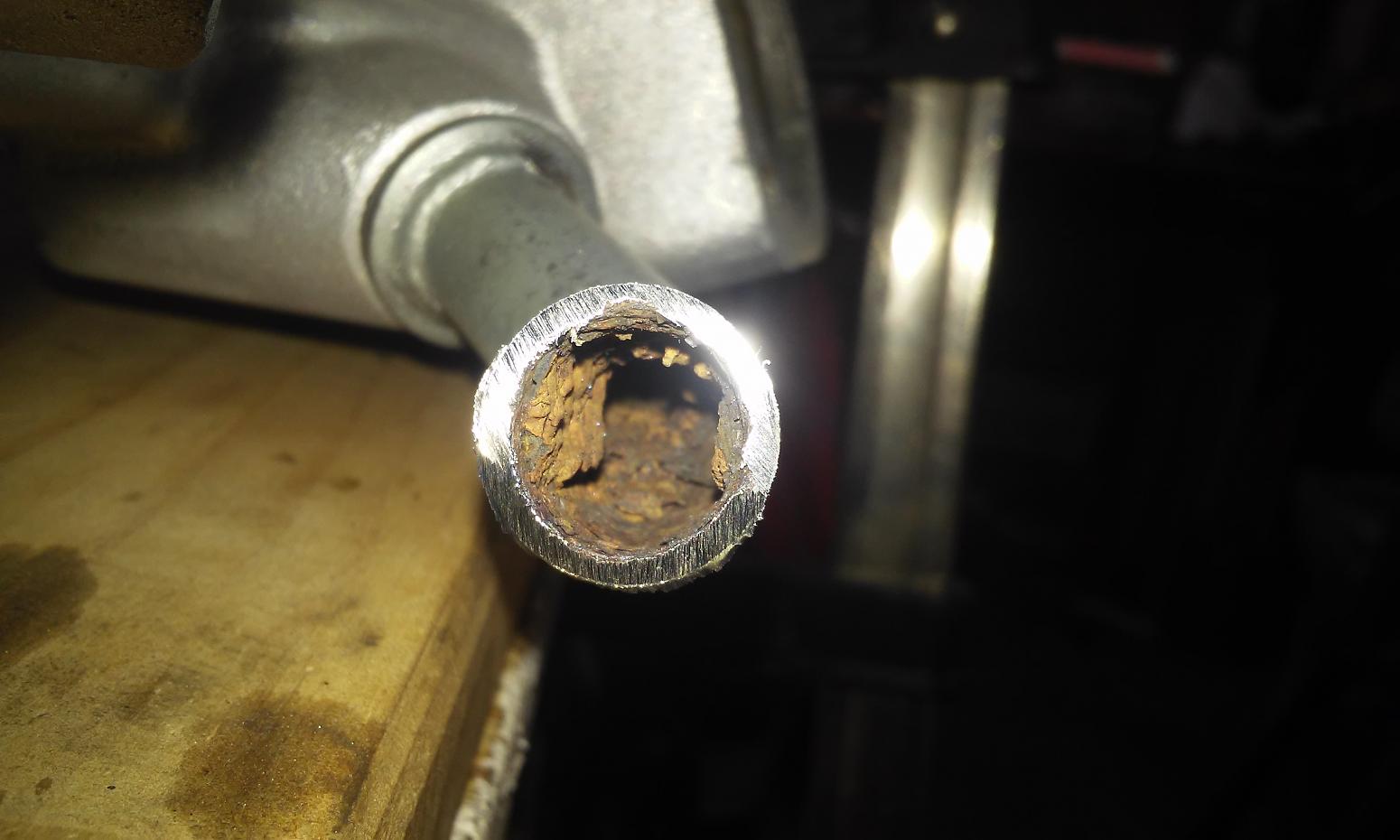

Picked the rig up today, man am I happy :twisted: There's a few little things I need to fix before I bolt it up namely the horrifically rusted heater pipe, not sure what I'll do here; I can't get the pipe out of the manifold so I think I'm going to have to cut the bad bit off and solder/braze a piece of brass or something onto it to bring it back to the right length. Also one of the coolant pipes under the base of the carbies is really bad, will replace it with the single stainless barb I have left. Here's some more porno for those who are interested :twisted: Don't worry about the smudged red heatshrink, I will cover that with black heatshrink.

Post by steptoe » Sat Apr 23, 2016 7:26 am

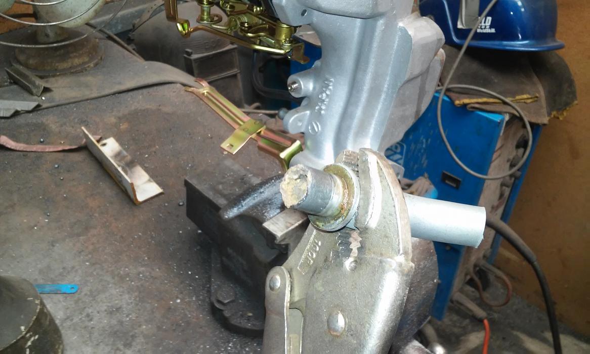

those heater pipes do NOT come out !! I have cut one short and just used longer heater hose. Looks like the thermostat gasket face needs a little TLC
I never got the end bracket with my twins - you too ?? I found a rose joint tie rod end looking item at a bearing suply fitted the shaft perfectly, then knocked up a crude bracket off the thermostat upper bolt

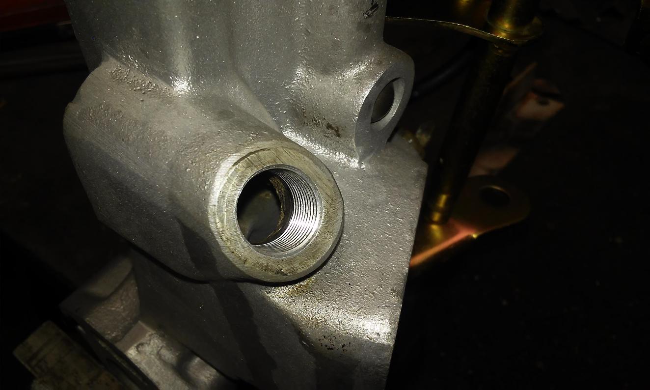

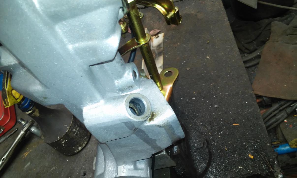

Hey Jonno, they DO come out! :) Today I was fretting about that steel pipe, having cut the bad end off and looking up the tube with a light, seeing endless stalactites of rust hanging down I wasn't happy. I planned to drill it out and put a copper pipe in there but I had no 16mm drill, quick phone call to an engineer friend of mine and popped round, he had the whole manifold in the vice, two vice grips on the stub of steel pipe, twist and turn and she popped right out! :) Nice clean smooth hole left behind, didn't even need to drill it to tap a 5/8" BSP thread in it ready for a brass 1/2" hose barb, and run rubber hose up to it from the heater. Pics below.

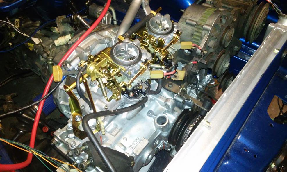

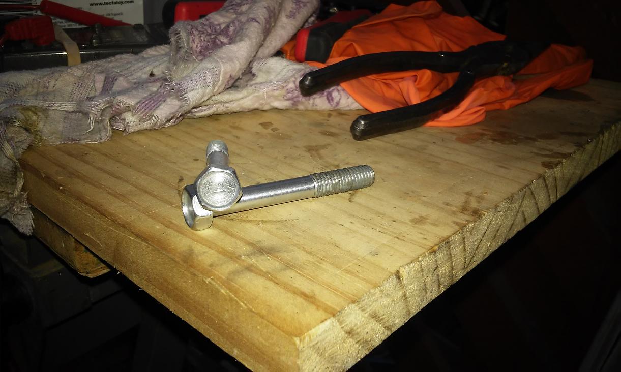

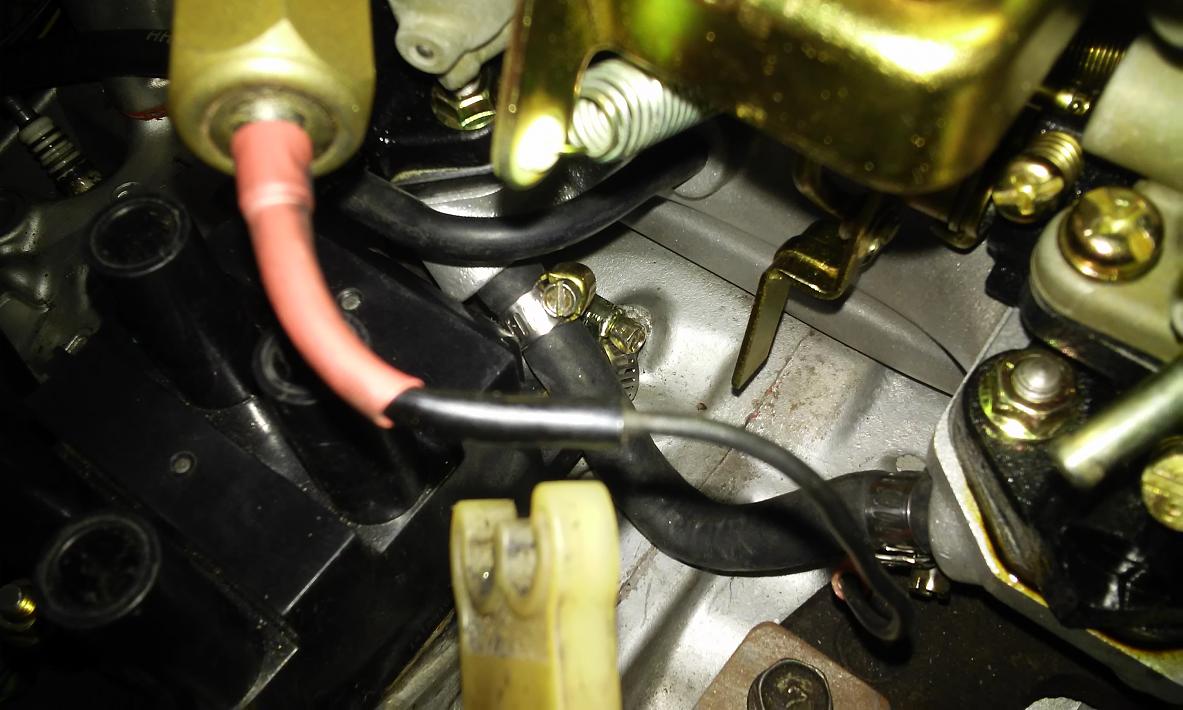

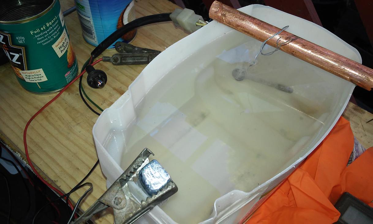

Also spent today playing around with doing my own electrolysis zinc plating and it turned out amazingly well. Just did a few bolts to start with, now doing a few other brackets and such. At about 8 PM tonight the twins got bolted in to their final resting place (with no rags in sight) genuine gaskets throughout. Found I might have some issues keeping the coil pack where I had it; couldn't bolt the manifold up with it in place because of coolant hoses in the area being in the way. Now the coil pack is off, manifold on, can't get the coil pack back in place :( 5mm more clearance and I would have been fine.

Stalactites of rust, couldn't live knowing this was in my engine so it had to go
Here's the rusty bugger, straight into the bin
Nice clean hole left behind
Nice clean 5/8" BSP thread

Experiments in zinc elctro plating
The first bolts I plated; they come out looking dusty dull grey at first but just need a buff up with some green scouring pad with bolt in the drill and they come up real nice and shiny
And the twins in their final resting place :)

That alternator is out of place!
Looks very awesome otherwise!

Ps: good effort on the plating, did it take long per bolt?
Post by steptoe » Mon Apr 25, 2016 8:01 am
write up on this zinc plating and what to get, where and how to Sam sometime ? I'd aso want a green plating trick too for those greeny bolts
Post by Silverbullet » Mon Apr 25, 2016 7:14 pm
Will do Jonno, it's pleasingly simple and not much special gear required which I was happy about :) Dunno about the factory green finish though, I'm one step away from the shiny gold chromate color but the chemical to do that is pretty nasty, not sure if its even available in Australia due to our nanny state laws. Also that Alternator is going! some time soon. Once I test run the engine I will get that A/C bracket blasted and coated, get the A/C compressor looked at and fit the new alt so it will be all sparkly and new.
Today a little more progress; got the coil pack back on happily by lopping off one stud/corner of my coil mounting platform to clear hoses. It's still plenty strong enough, I maintain that you could lift the car by that bracket :rolleyes:

Lots of hoses in close proximity to the coil pack back side
