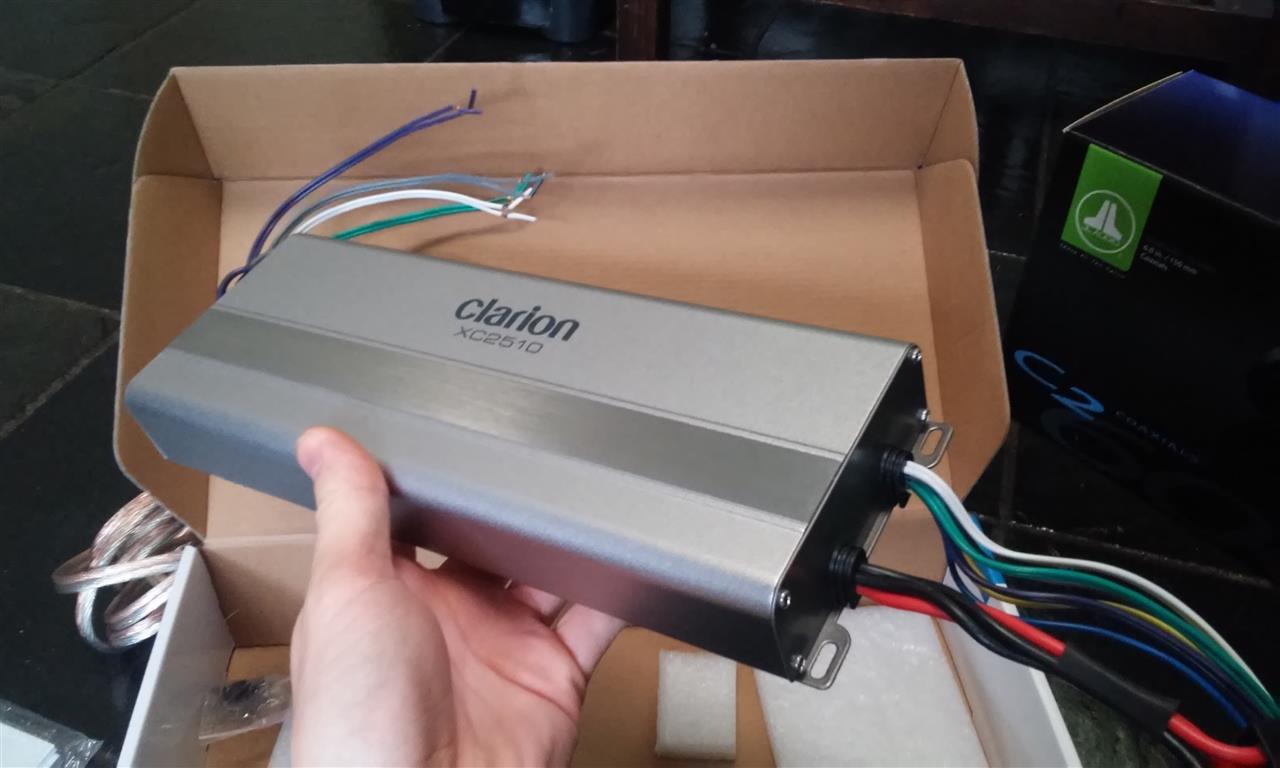

I've finally collected most of the bits for my sound system now
Except the head unit which I don't really need yet.

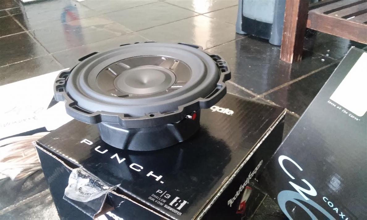

The sub I've gone with is a Rockford Fosgate P3 8" shallow mount, with dual 4 ohm voice coils. This little thing is a sweet little unit. It's seriously small but should still punch out some nice bass. I never wanted bone rattling bass so this should be plenty. I'll be wiring up the dual coils for 2 ohms.
My favorite part is the amp - a Clarion XC2510 marine amp. I went with this one because like the sub it is amazingly compact but still has some great features and adjustable everything. It's 700w 5 channels
Specs:
50 Watts × 4 + 200 Watts × 1 Continuous @ 4-Ohms
75 Watts × 4 + 300 Watts × 1 Continuous @ 2-Ohms
150 Watts × 2 Continuous @ 4-Ohms Bridged
Just have to work out what cable it needs to feed it. I will run a dedicated line from the battery (or alternator?) I haven't worked out the cable gauge required yet. It has 2 x 40 amp fuses on the parallel input lines so I guess the amp will be usually running around half that. If it ever pulls more than 80A the fuses will pop (which is good since my alt is only 90A

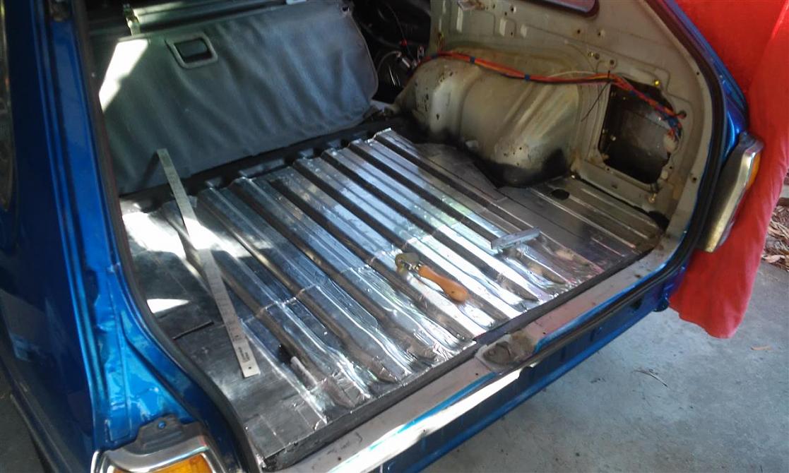

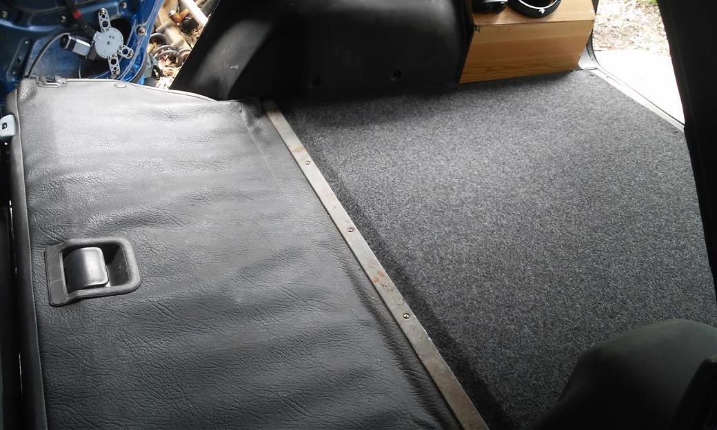

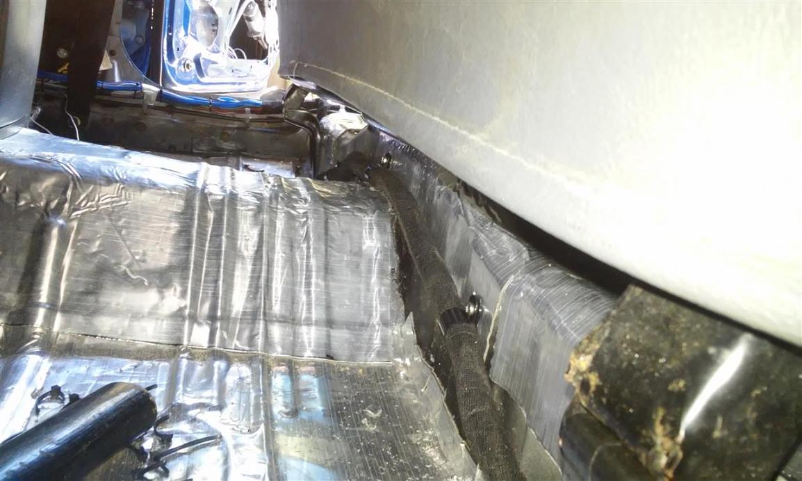

This weekend I've been working on the boot floor so I can make a start on the fiberglass sub box. The boot/carpet needs to be at it's finished dimensions before I start laying the fiberglass. The floor got the resomat sound deadening treatment, then I cut a piece of 7mm plywood shaped to fit the floor around the wheel tubs to give me a nice flat solid floor surface. The plywood then has some marine grade charcoal heavy duty carpet glued onto it. I still need to put some thicker foam underlay under the plywood to stop it rattling around but so far it looks great
Sound deadening resomat
Plywood and carpet in place

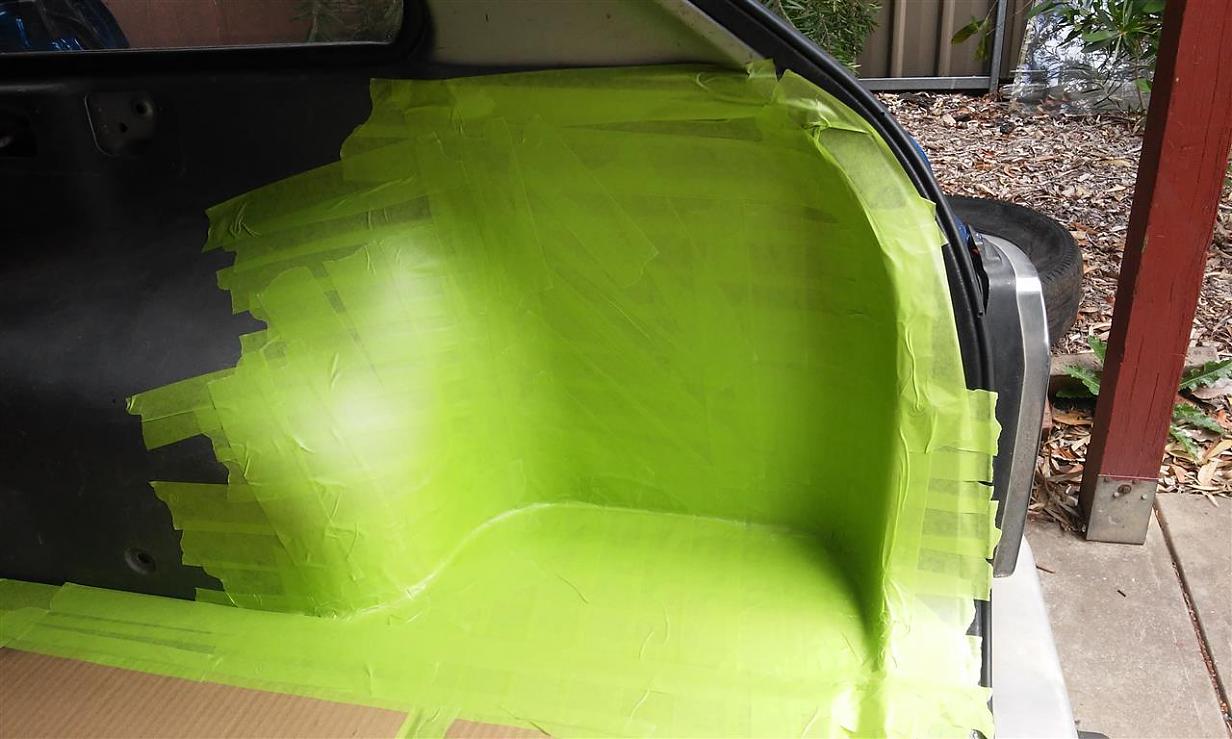

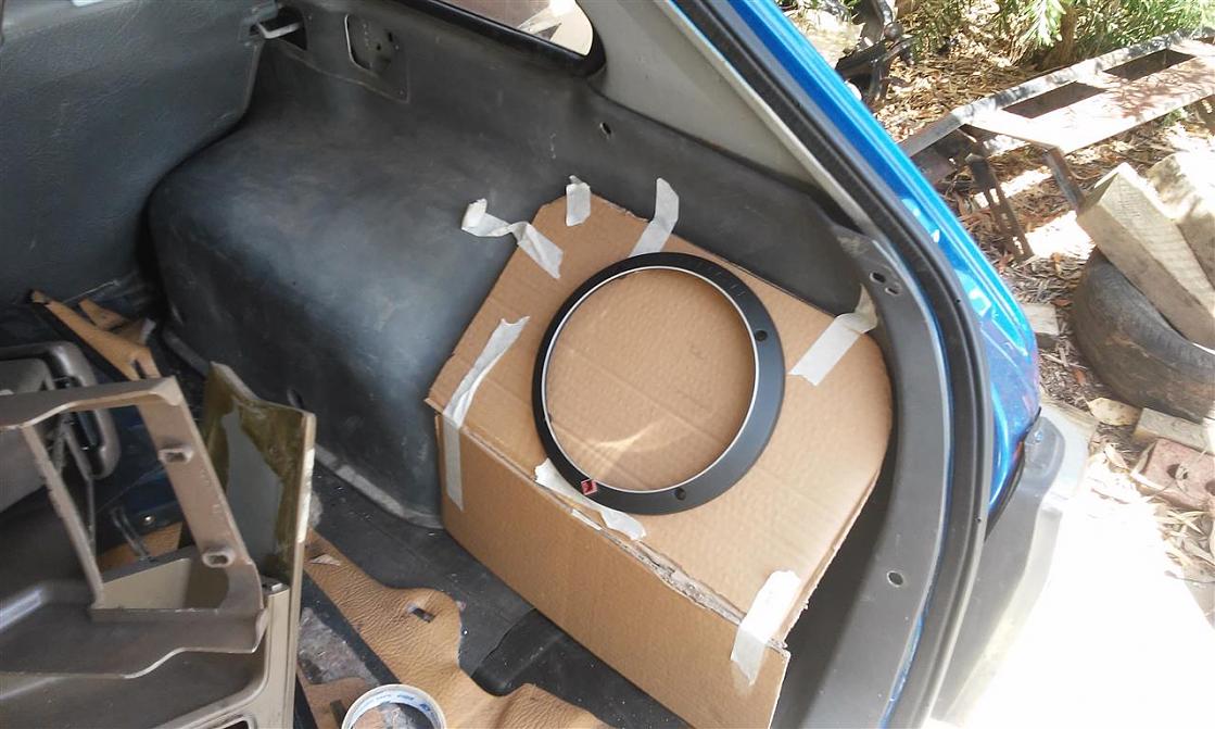

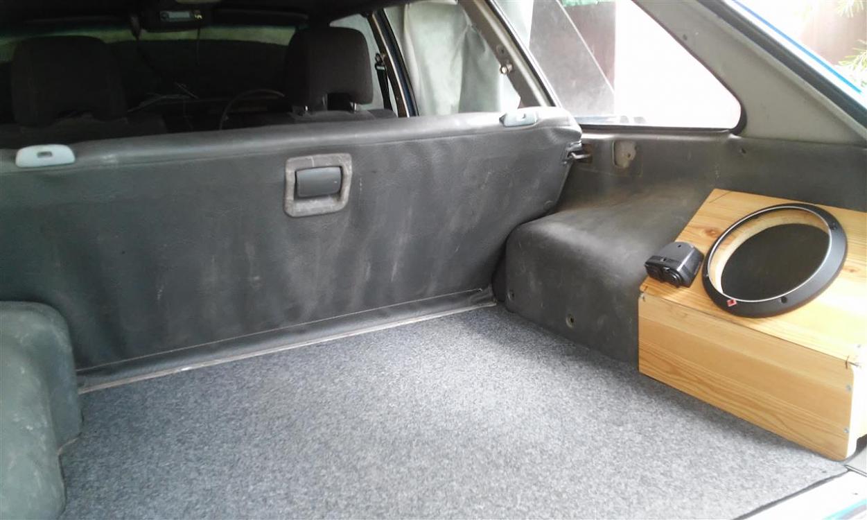

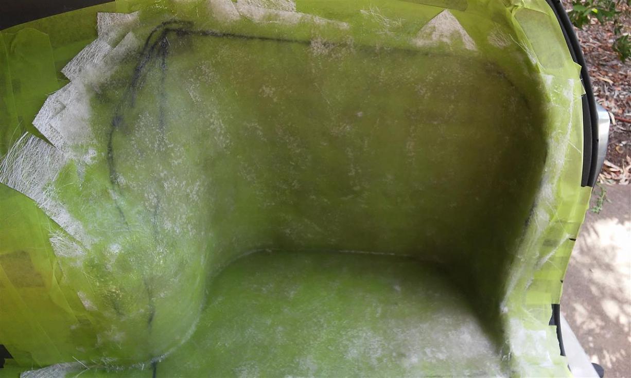

Here's a little progress report for the last few weeks - I've got all the speakers mounted solid in the doors, now have to sort out the door cards to go over the speakers. Not sure what I'm going to do yet but there will be some customization of the door cards.
Also a couple of pics of the beginnings of my sub woofer box for the boot. That wooden thing I threw together wasn't really that great, plus I couldn't think of a way to make the backside of the box so it would be sealed. So I'm going the fiberglass route - using the car itself as the mold for the woofer box
Just got the backside done today with a few layers of chopped strand mat and polyester resin (that stuff stinks!) Should be able to pop it out tomorrow and trim the excess, will probably need one more layer on the inside to make it really solid. I really liked the look of this method as once it's done it looks like it's supposed to be there, and uses up every possible bit of space for the internal volume of the box.
Layers of good masking tape to protect the interior and floor
Then just slather the goo and glass right over the top of it

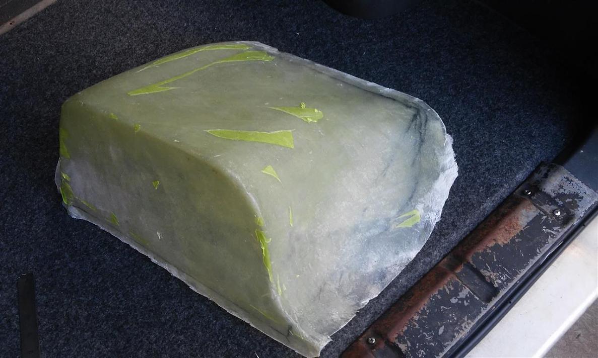

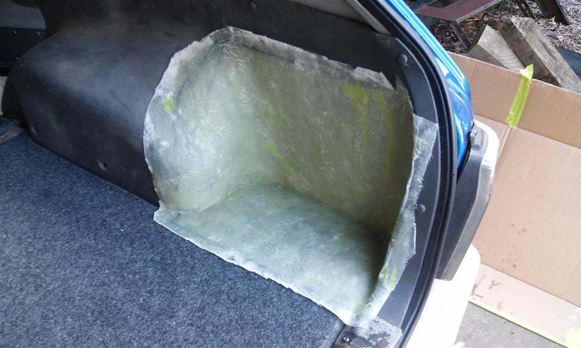

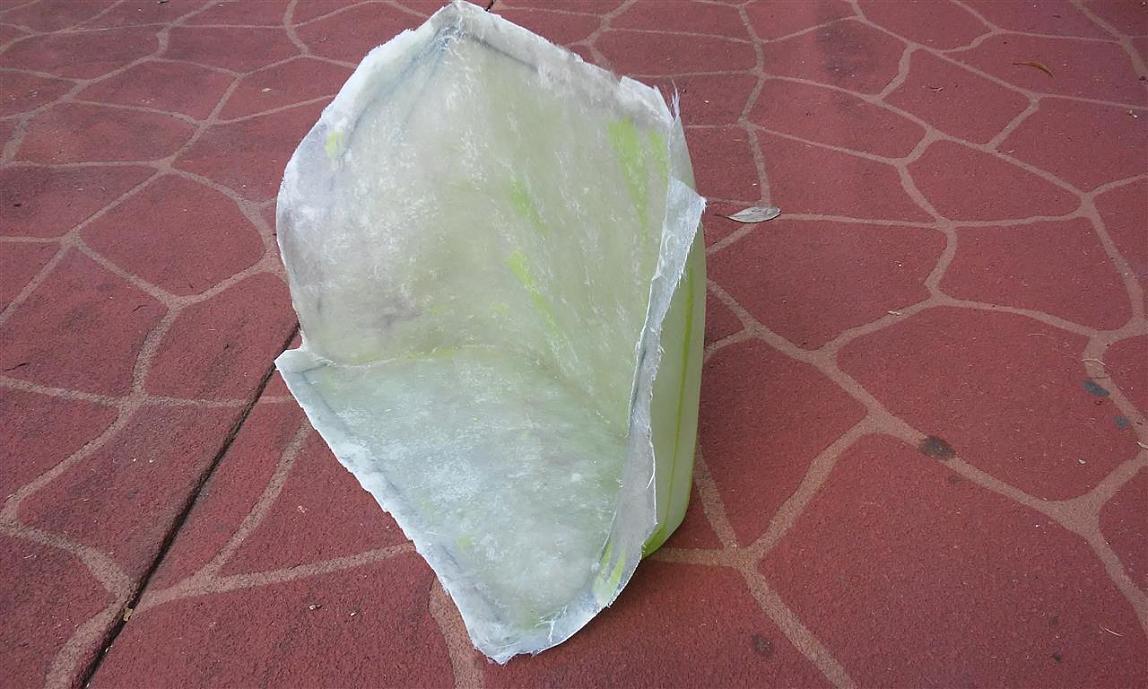

Actually scratch that - the resin set nice and hard in a few hours so I couldn't resist
This is going to be awesome
