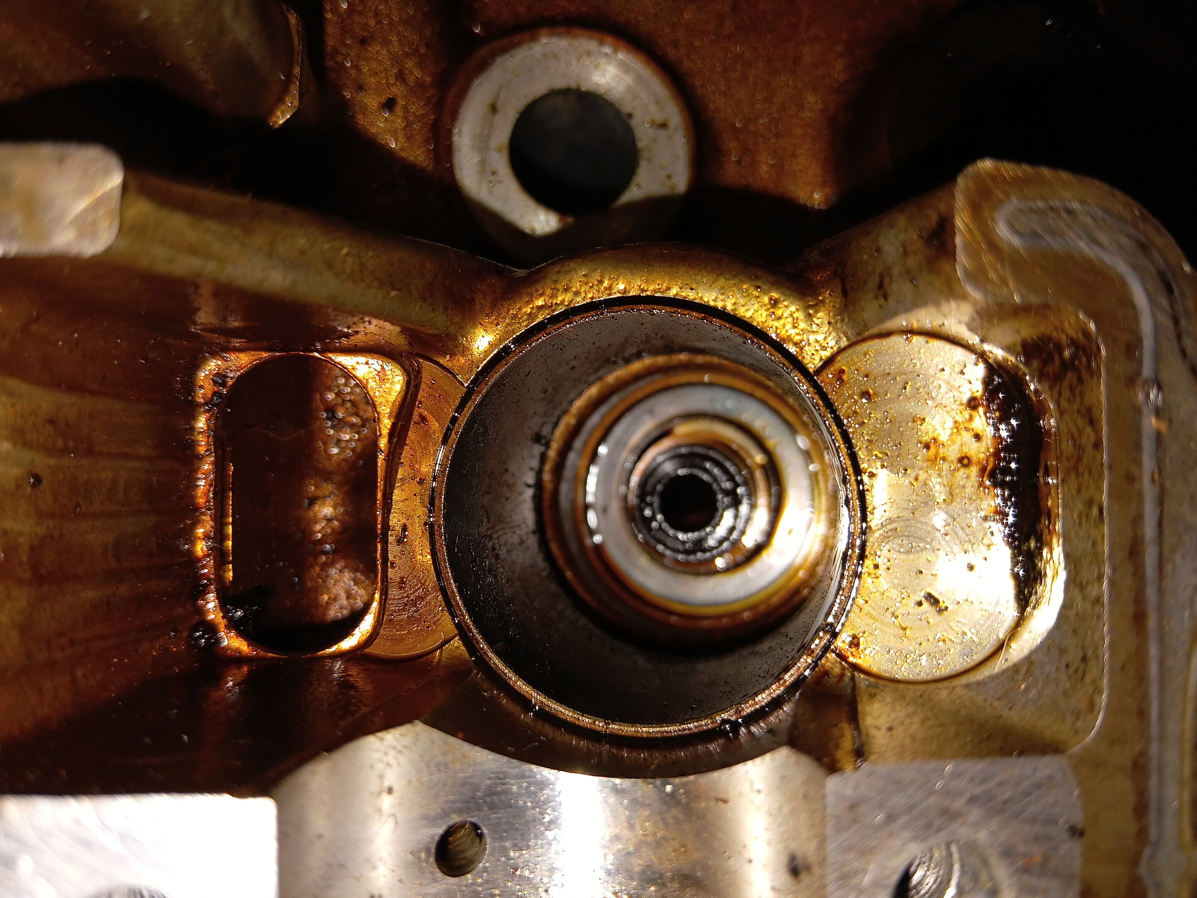

Cleaned up the heads over the weekend, really strange rust patterns. EX valves are coated in rust and crap, one IN valve will be rusty, and the other will look perfect on most cylinders. Looking at all new OEM valves, and may keep whatever valves are salvageable as spares.
Have been having a terrible time finding valves though. I only have a steel rule on hand, but as far as I can tell
IN - 36mm face, 94mm tall, 6mm stem
EX - 32mm face, 94mm tall, 6mm stem
I can't tell by how much, but the EX is marginally taller

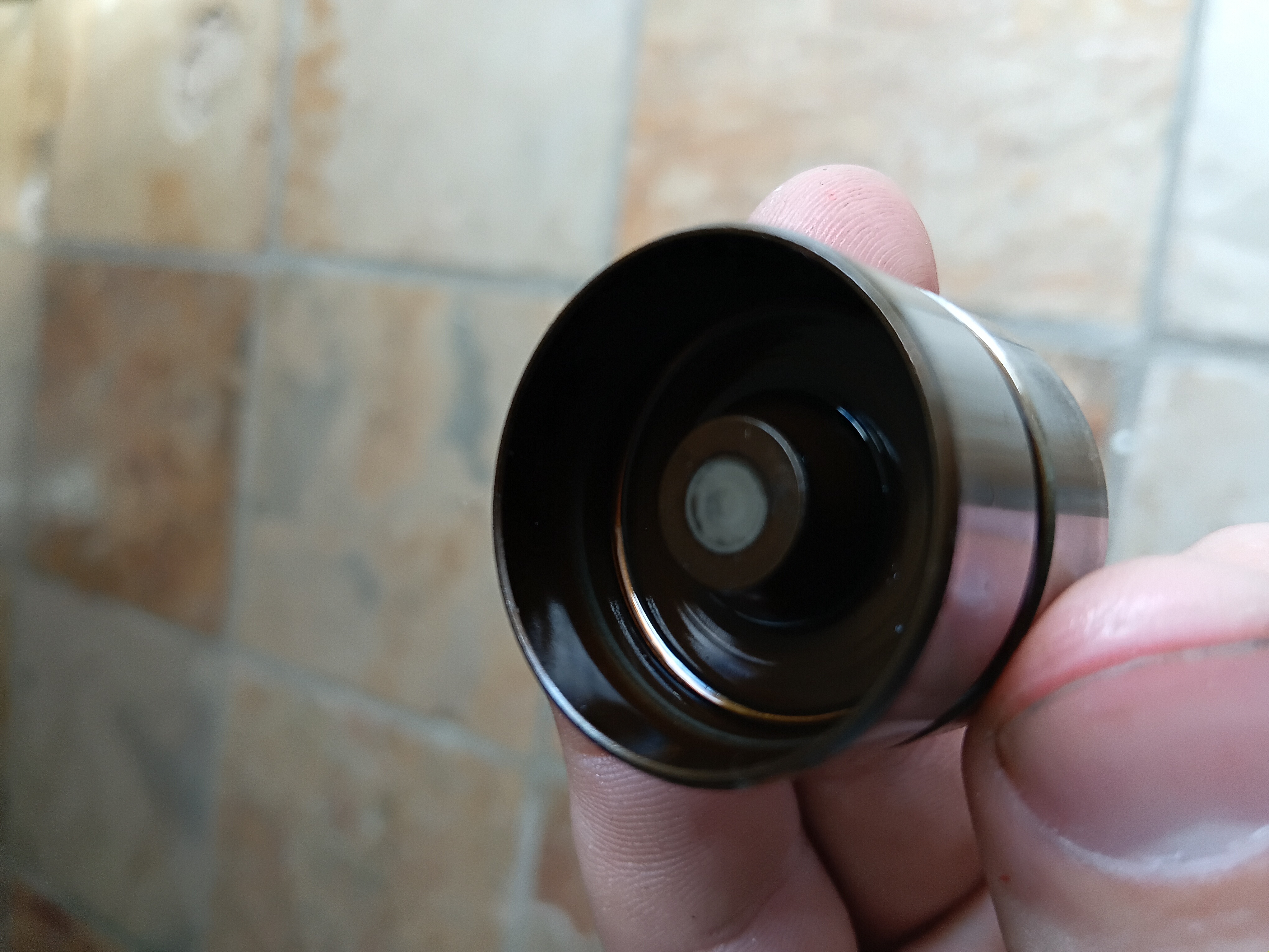

Intake valves is stamped 1251, can't make out anything on the exhaust. JDM hydraulic valves seem to be very difficult to find now. Haven't even found a parts manual yet.

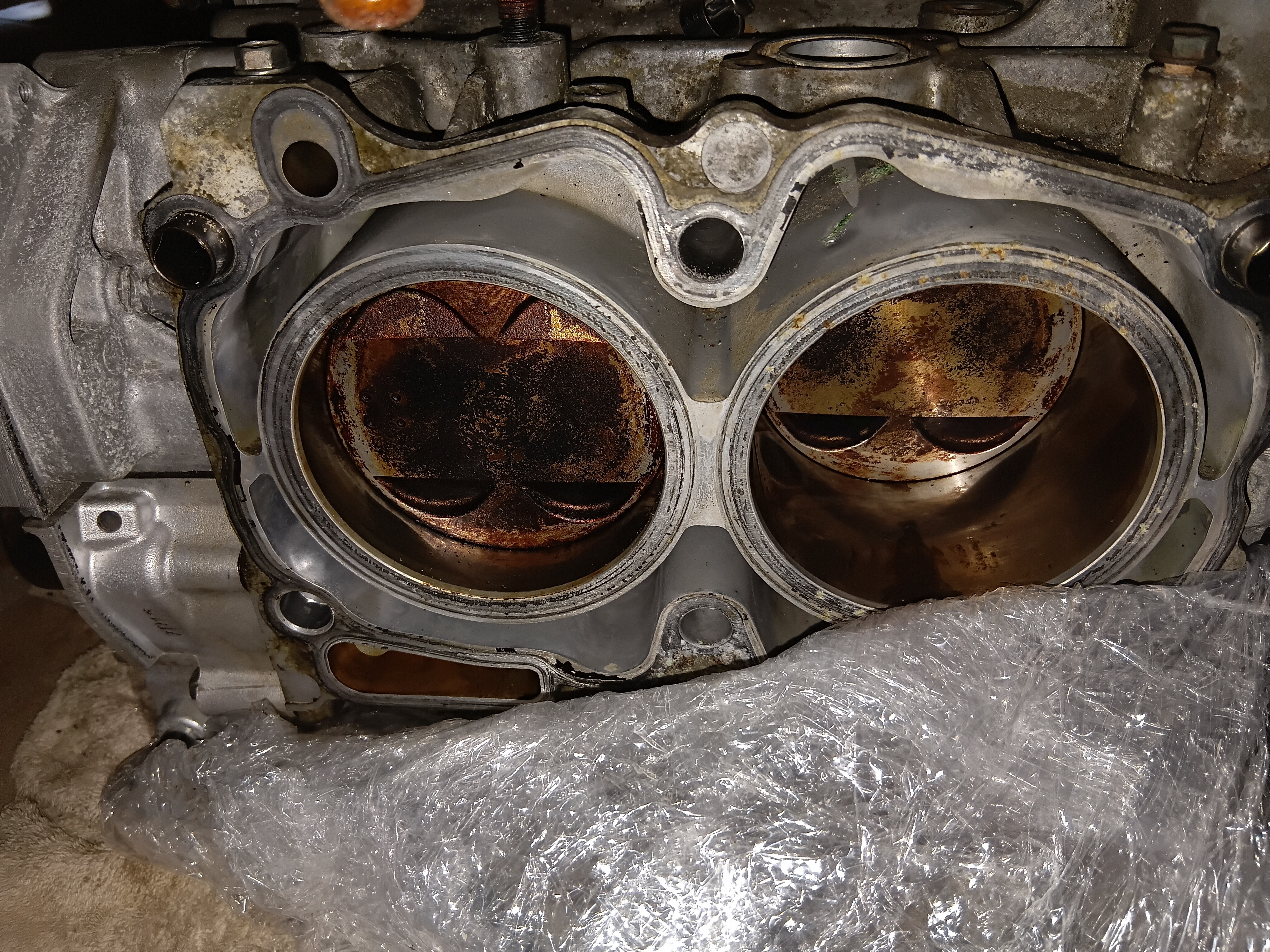

Here's the rust so far. Don't want to jump to conclusions but I reckon this should be the worst of it.
Currently trying my best to wait it out for a good block to save myself time and money in the long run. We'll see how long I can hold off for.

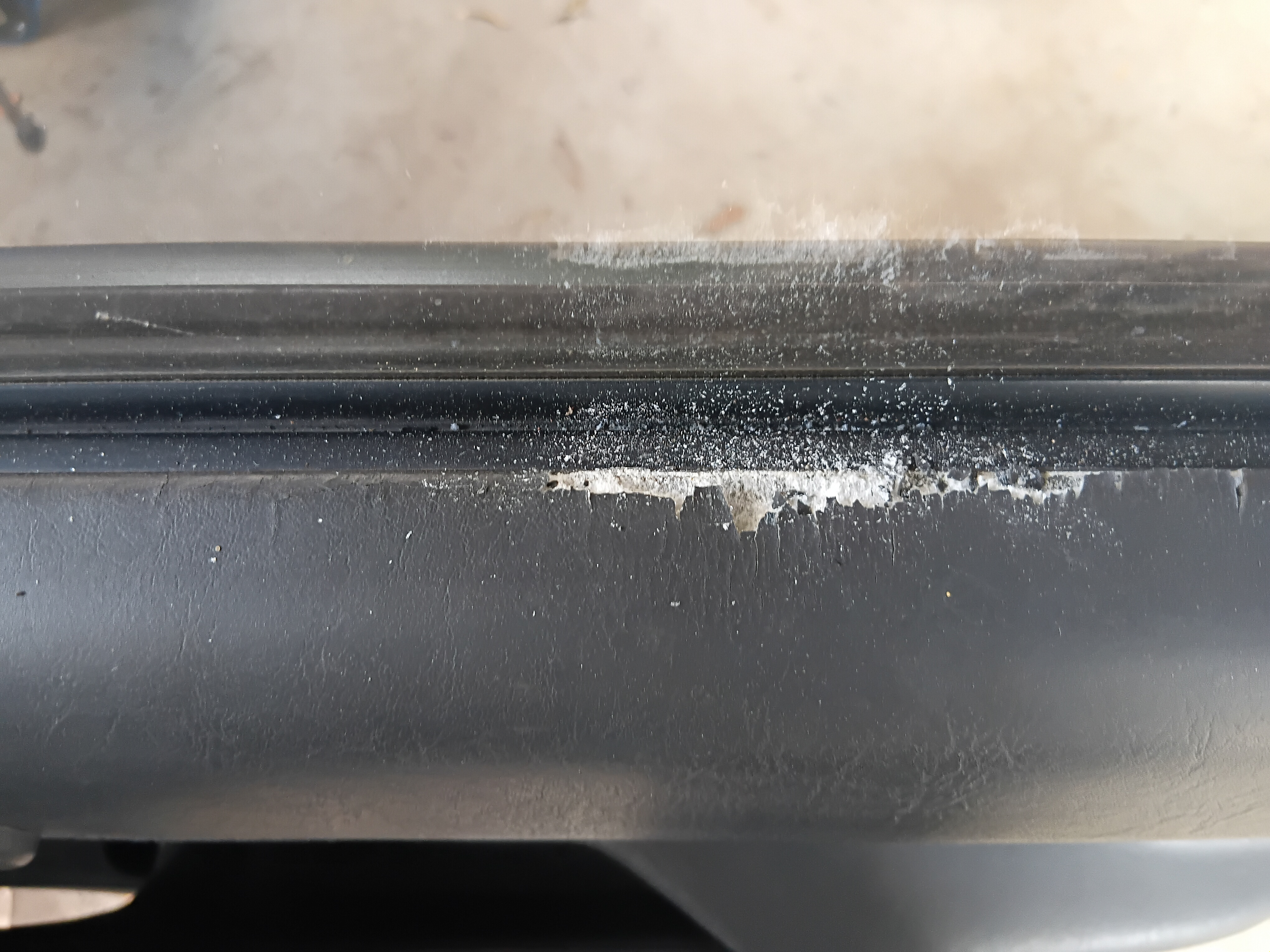

Noticed this one on the drivers door card.
I'll be on the hunt for some of the interior parts. Easier said then done.

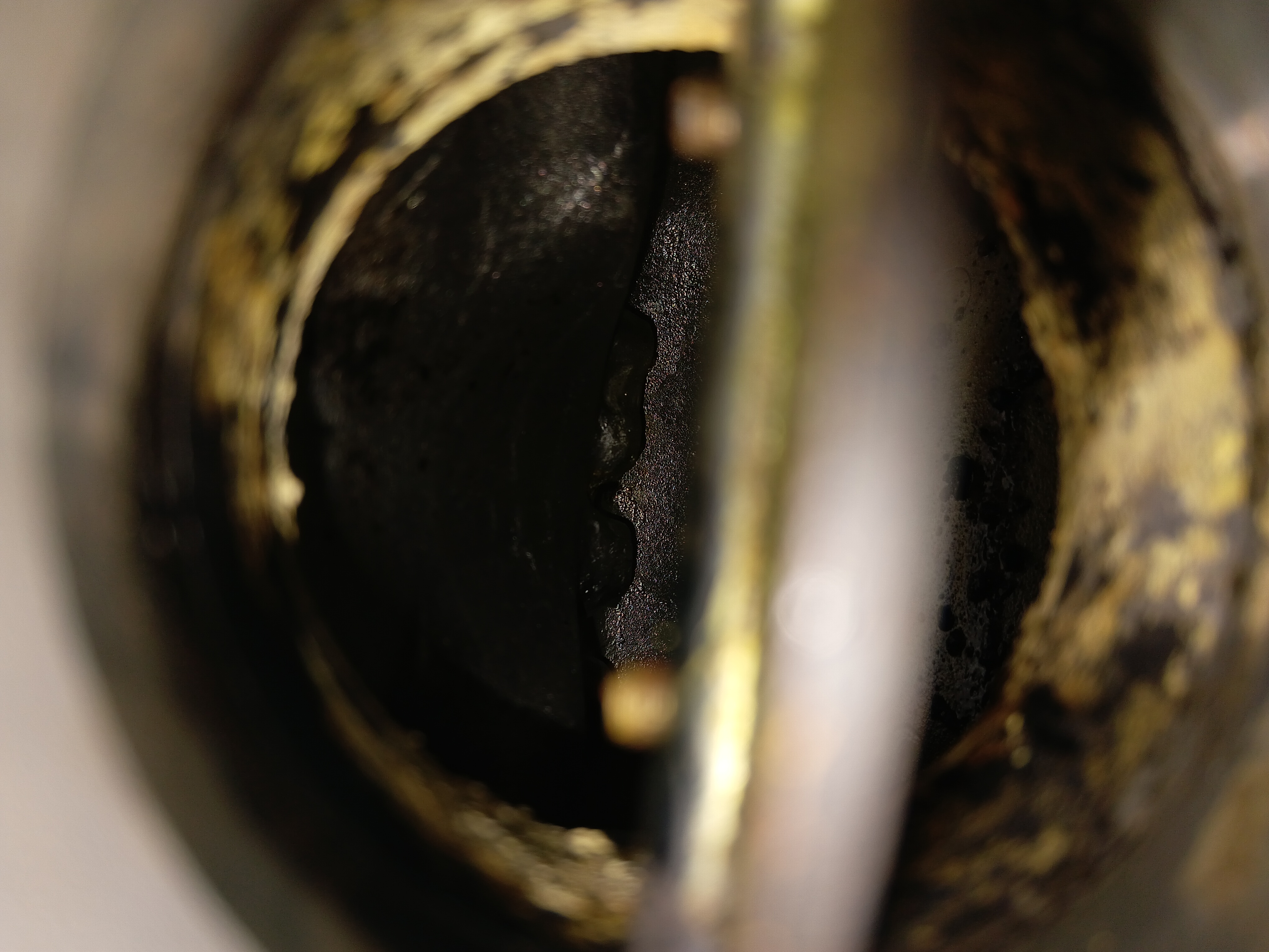

Was about to clean up the throttle body and intake manifold and found this
NFI how this happens. Intercooler is spotless but everything on the manifold side is filthy. However it happened, it would explain why both sides are equally rusty, on the bright side I'm glad it didn't get to the intercooler and turbos.

I don’t quite know what those throttle body pics are. It could be worth filling the coolant lines on the intake manifold (one end plugged) to see if there’s any leaking into the intake manifold from those. It would take a lot of water to fill up an engine block the way you found yours. Who knows how they managed that. Lucky the intercooler is higher than the throttle body in that regard.
